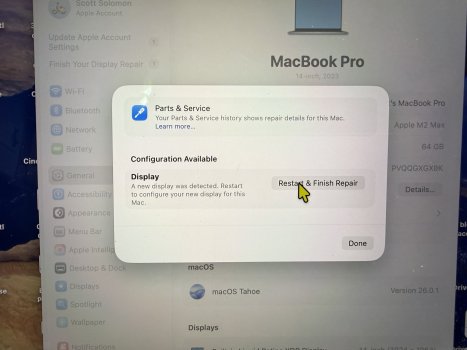

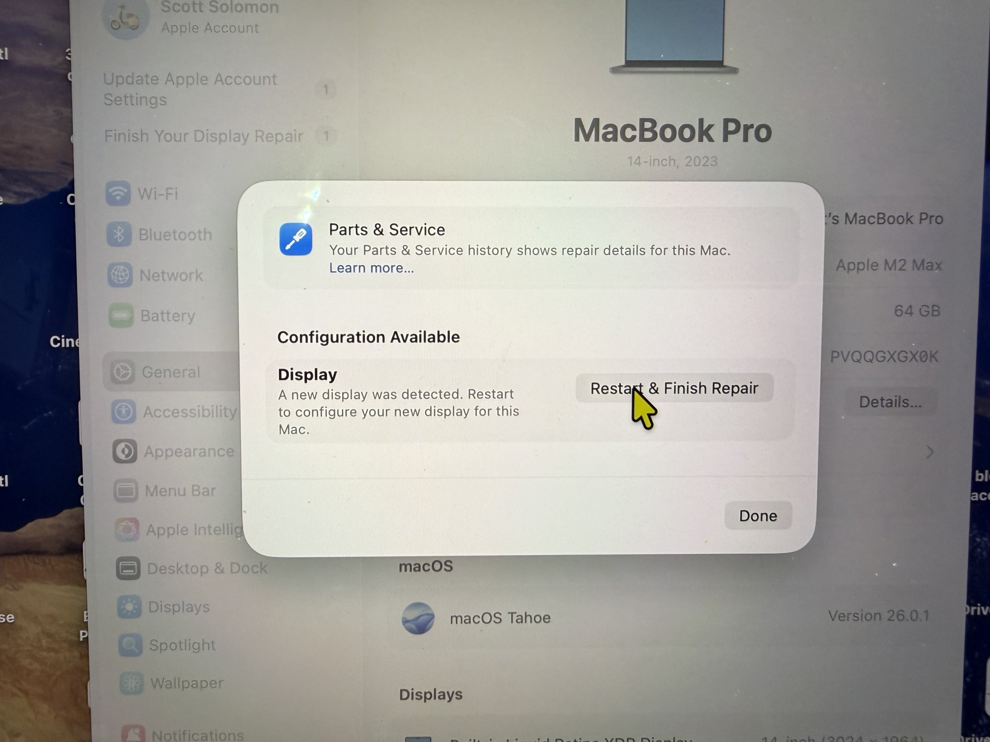

Well, I am very, very happy to say that this information is incorrect. I bought the used A2442, removed the screen, kept the lid angle sensor with the original computers and when I turned it on, everything worked. It then popped up a notice that I had done a screen repair. It asked if I wanted to configure it and restart. So I did. It then did some checks and said that it was a genuine Apple part. It finished, restarted again and the screen is flawless. No artifacts, no issues at all. It look just like the original screen.

Well, I am happy to say, that is not the case. Because I used a genuine Apple screen, it just worked. It came up with a notice that I had replaced the screen and asked if I wanted to calibrate it. I did and it identified it as a real Apple screen and did its thing.
I am using it right now and the screen is as good as new, no issues what so ever. So, it can be done and Tahoe even walks you through the calibration.
