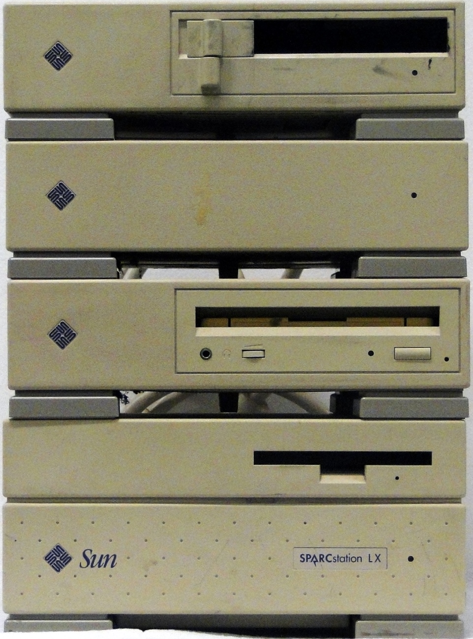

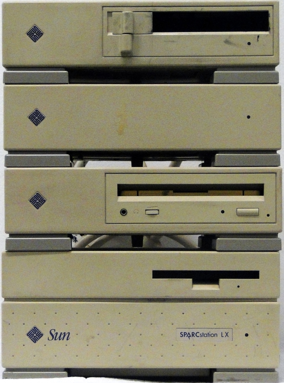

I'm not sure what all the weird advice is on here. Running your home folder on an external disk is pretty normal. Hell going back 30 years we used to do it on Unix machines and the Mac is a Unix machine. Depicted below the typical SPARCstation tower. Main LX had the system disk in it (200mb on /) and the home directory went on the second box from the top (200mb on / or /usr)
The constraints are of course how good that disk is. So don't buy a crap one. It's the thing that contains everything you do.
I bought a 512 gig M4 mini which is fine for me for the next couple of years but if I need more storage I'll just throw an OWC TB enclosure and 2TB NVMe (probably higher end Samsung / WD on it).
