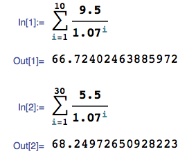

Hey, I need help with a Finance problem that I cannot seem to figure out. 🙁Are there any on here?
Mike just won the lottery, and he must choose between three award options. He can elect to receive a lump sum today of $61 million, to receive 10 end-of-year payments of $9.5 million , or 30 end-of-year payments of $5.5 million.
A. If he thinks he can earn 7 percent annually, which should he choose?
I'm thinking this is a FVa problem...ordinally annuity. I'm not sure...
Thanks!

It's a Present Value of an Annuity problem.
You need to figure out the PV's of the payment options, compare them to the lump sum payment, and choose the highest amount.
You can do it as a FVA, but then you'd have to figure out the Future Value of the Single Sum of $61 million. Why do extra work?
Lump sum is gonna be 61 million right...thats option 1
option 2 is the 10 yr payments of 9.5
so you'll put in..(make sure your calculator is set to END)
N=10
I = 7%
PMT = -9,500,000
FV = 0
PVa = 66,724,024.64 (which is option 2 answer)
Option 3 is
N = 30
I = 7
PMT = -5,500,000
FV= 0
PVa = 68,249,726.51 (which is option 3 answer)
So, for A I would choose option 3.
OMG! Did I do this right?
Looks right to me. *thumbs up*
