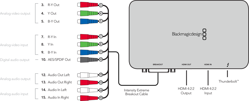

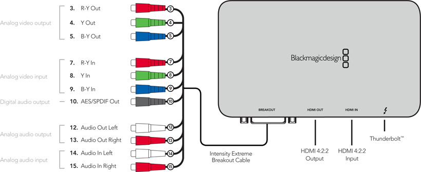

From the thunderbolt port on the back of my iMac I go to a BM intensity extreme. Now I want to connect the output of the BM to a apple cinema display (thunderbolt version).
The BM had different outputs, there is an image of them attached.
Can I use this? Otherwise the cinema display is useless.
Thnx.
