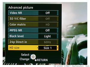

I'm surprised you're going after this point, Night.
Even the actual programs that we use for editing like Premiere Pro as well as the cameras we shoot with use 24p in their menus and drop downs so I'm surprised your BBC friend gave you that answer. 🙁
It's used and needed to make sense in context next to 30p, 30i, 50i, 60i, etc. I get that. I also understand that the person who works with video assumes this to be 24 frames per second as well. You get both bits of information at the same time so it makes it feel like the term is being used interchangeably.
You might be able to argue a technicality to victory, but for all intents and purposes the term is understood by most who work with video just fine.
