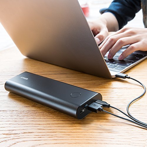

I have an Anker 20100 USB-C charger, yes, it works on my MacBook 12". It won't charge a 15" for sure...however, I have a 13" sitting here with me. I'll plug it and report back shortly 🙂
[doublepost=1481094747][/doublepost]Update: 7 minutes on the Anker charger. Started at 59%, ended at 59%. I provides enough power to "maintain" while working. I may try it when it's in sleep mode. It's not like with the MB12" which works like a normal charger. Anker link at Amazon. They updated the description to state "MacBook Compatibility: In addition to standard functionality, USB-C port makes it compatible with the new MacBook 2015/2016 (not MacBook Pro), charging at 5V/3A"

As a heads-up, I’m hearing that it does charge the new MBP...it’s just not strong enough to run the MBP and gain an increase in the battery charge at the same time. In other words, you’re slowing down the discharge if you have it hooked up while you are using the MBP. And if it is plugged into your MBP while the MBP is sleeping, then it will charge the battery. From what I’ve gathered so far, it should be enough for one full recharge.

It WILL go down eventually if under a heavier load. But it goes down much more slowly than battery only. It appears to be charging at 15w vs. the required 60w.

I had a 15" and it's not worth getting for that power requirement. I left it on overnight with my 13" (about 6 hours) and it charged about 25% and the battery pack was about drained. It's great for a 12", iPads and iPhone, charging my Sony cameras, etc....but I don't plan on it for any MBP.
