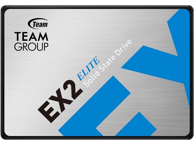

There are plenty of SSD options for the Late 2012 iMac, ranging from easy and cheap, to very fast, complex, and expensive. You can use SSDs externally on the Late 2012 iMac with USB-A, USB-C, TB1/2, TB3, SD Card, and even FW if you want.
You are probably looking to get the easy and cheap method, which is a simple 2.5" USB3 enclosure or adapter cable and a SATA SSD. This would give you speeds around 450MBps.
New Egg has a 2TB SATA SSD for $130, with good reviews:
You can always spend more for a Samsung or something as well.
