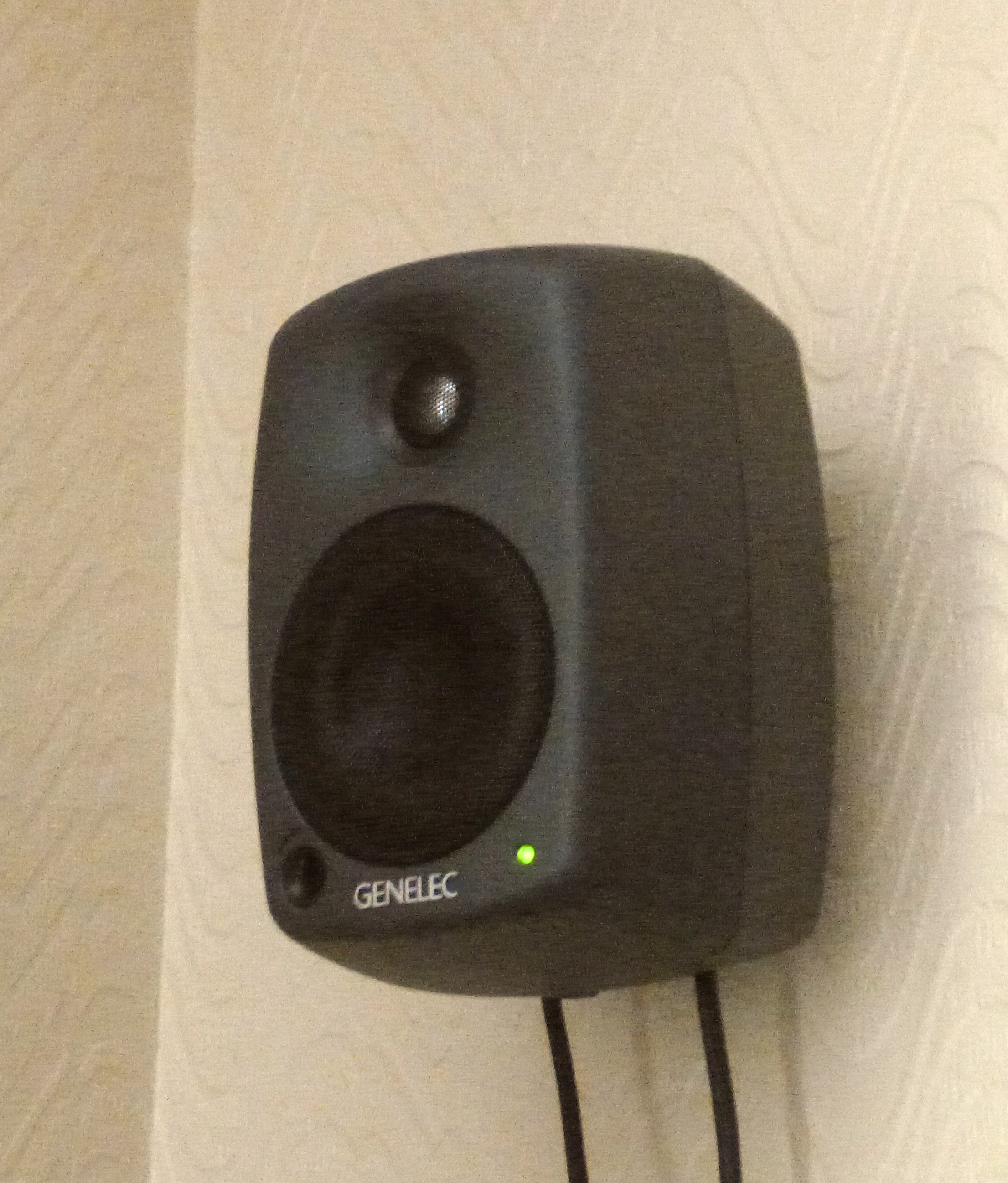

I have a pair of Genelec powered studio monitors...Mot cheap, but I can highly recommend them...For their size the power and sound reproduction is second to none.
They are pricey, but well worth the investment.

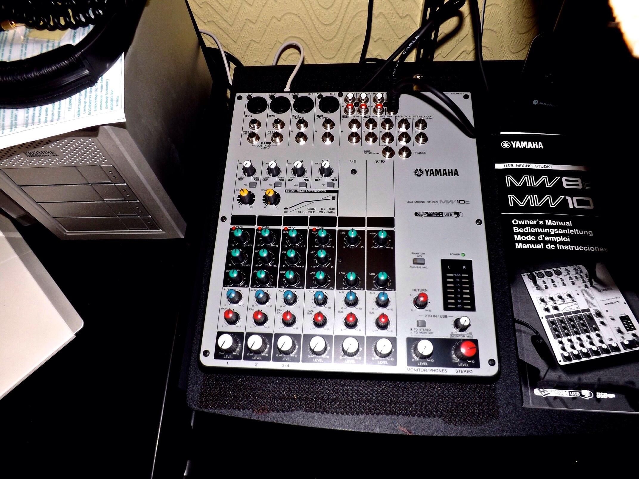

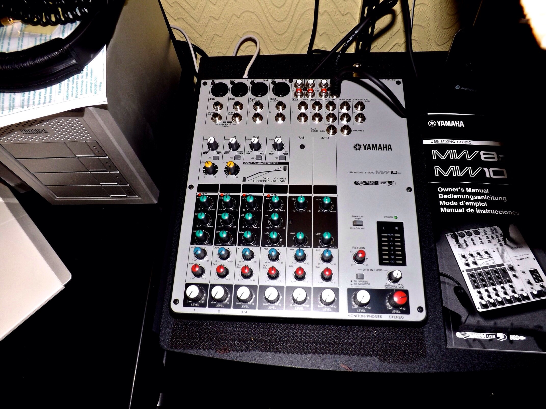

Mine run through a Yamaha board, which in turn runs to my iMac and my Onkyo system in the living room.
If there is a criticism to be made, the Genelecs are very bright, but they are made that way as they are designed for studio work.
This is the board I use for recording work...it has phantom power for my Rhodes, and it's very flexible....I can connect it to AV equipment in order to get a real world idea of sound
Really nice. If only I'm a pro... 😡
