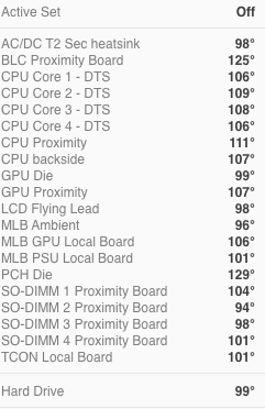

So my Late 2013 iMac started freezing today. The mouse will move, but I can't click on anything. Freaking me out.
I am booting from an external SSD, but have been doing it for five or six months with no issues. I also added a USB hub I got from Amazon Prime Day just yesterday. Have since unplugged it and it still seems to be freezing.
Troubleshooting what it is. I downloaded iStat. Are these normal temps for an iMac? Wondering if a fan is bad or something? Maybe dust.
[doublepost=1468559891][/doublepost]About 1300 rpm for the fan.

The temperatures ( assuming they are Fahrenheit which the OP didn't specify ) seem mostly normal. It's time for you to run Apple's Hardware test. Also, even though you're booting from an external SSD, a bad internal HDD can still cause issues. It wouldn't hurt to run Smart Utility ( or something similar ) to make sure all drives are okay. The first thing I'd do is make sure you have good backups. Good luck.
Yes, they are Fahrenheit. Thanks for the advice on the activity monitor. I will do that first thing in the morning and report back.
