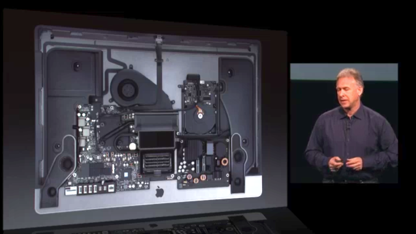

For reference:
Oh, there's the picture. I was reading this thread earlier wondering where a picture was, and couldn't be bothered to search for one.
Someone said earlier about those black things on the right and left (The things with the large round holes and gaps on the bottom?) I think those are definitely the speakers.
Unless we're talking about the much larger black things on the right and left? Can't think of what those are.

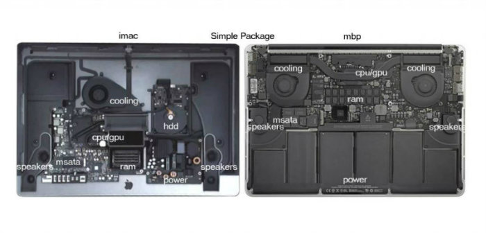

For comparison's sake I have correlated imac and mbp. Notice the large capacitors on the imac, cant see if they are solid capacitors or not? They are the white dots across the board, notice the mbp uses a diffident type as the solid cap's normally stick up by 10mm or so. This is one of the advantages of having a bigger package, it also makes it cheaper 🙂
