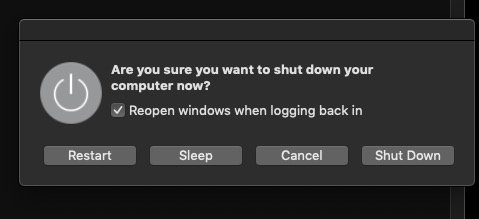

Mac Pro 5,1 running Mojave. Has been running solid for years. Now I'm getting a repeat pop up dialog box "Are you sure you want to shut down your computer now?" Even after shutting down and restarting it keeps coming up, which interrupts all inputs on the computer, over and over again.
It also won't sleep now as the popup dialog just randomly comes up, which wakes the computer up.
Note, this can continue even during the login window, so that it makes it difficult to login as the keyboard input is interrupted by this dialog in the background I assume.
Any thoughts on what might be causing this and how I might fix it?
Thanks

Are you all sure that this is a battery related issue?
