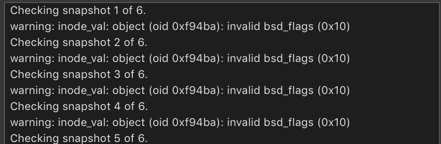

If so have you tried to do Disk Utility repair and get the following warnings. I seen this today when I attempted Disk Utility and my google search showed its well known error with One Drive and Mojave.
The only way I got rid of it was to wipe One Drive from Mojave and do a clean install. I left One Drive on my laptop for I need it for work but wiped it from my Mac Mini.
Im not even sure what the warning means but I wish they would get this worked out between them.

I use OneDrive and get the same errors when running first aid on Mojave. These errors go away when OneDrive is uninstalled and the OneDrive folder is removed. I'm not sure what causes the error between OneDrive and Mojave's but it seems to be harmless as my MacBook Pro runs just fine.
I wouldn't do a clean install as I hear the error will come back after OneDrive is installed again. For now, I just ignore it.
I'd like to know what exactly causes this issue but since I don't think it's doing much harm. Hopefully Microsoft works this issue out. I also use Dropbox and iCloud and these are fine.
The only way I could eliminate the warning was from a clean install. Even after removing all the One Drive folders and files on my Apple SSD it still registered a warning. I removed all the files and folders then did a CCC of the hard drive.
Went into Internet recovery (command R) erased the hard drive, installed new Mac OS, Migrated from CCC. Done.
I read that regardless of using Time Machine it will bring back the problem. Looks like CCC or equivalent is the only way not to bring back the error.
Another thing I noticed was that even though I erased 12GB of files on my Apple SSD one drive it would not show that as free space on the SSD. Not until I did the erase and re-install. CCC showed that it copied 12GB less but the Apple drive would not.
But yes it will come back if you install one drive again on the Mac. I really don't need the app on my mac or the files on my Apple SSD for I still can use One Drive over the internet on my Mac. I have a backup on a SSD of all the files. It is less convenient this way but not that bad.

The TL;DR answer is that this is probably a Microsoft bug. 0x10 seems to be one of the FreeBSD file security flags defined as UF_NOUNLINK ("file may not be removed or renamed"). These mostly serve a similar purpose to System Integrity Protection. OneDrive may be setting this to prevent users removing files in the OneDrive-managed folders, but the source code in <sys./stat.h> says this is not implemented in MacOS. Hence the "invalid bsd_flags" error. Meanwhile there's also a parameter UF_SETTABLE=0xffff which is used by MacOS to limit which flags can be set. This means it's possible to set the 0x10 bit even though it generates this error later.
So it looks like there are two bugs:
1. Microsoft OneDrive may be setting this based on the flag from BSD, but this is not valid for MacOS
2. There's also an Apple bug in that 0x10 should probably be excluded 0x10 from UF_SETTABLE to prevent this getting set by mistake
In the meantime if disk utility completes with only a warning then you *may* be able to ignore this. Also, it may be possible to clear the flag in a terminal window without reinstalling as follows:
a. Type "ls -lOd /path/to/file" (that's the letter O, not zero)
b. If the 5th column only has 0x10 or similar and not word(s) such as "hidden" then proceed to (c):
b. Type: "chflags 0 /path/to/file"
You can see examples of some other flags in place with "ls -lOd /*". Note that "chflags 0 ..." will remove all permitted flags, which is why you need to check there are not any other existing flags in (b). [Also I have not tested this; some flags cannot be unset without booting into single user mode].

An "inode" is essentially a file. Unix (including MacOS) has two levels of directory in the filesystem:
1. The hierarchical folders visible as directories just contain pairs of "filename1 number1", "filename2 number2", etc.
2. Each of these numbers is the index of an entry in a flat "inode table". The inode contains all of the real information about the file including owner/group, dates, size, permissions (including these bsd_flags), and pointers to the actual data blocks of the file
So in many ways the inode is the actual file, just like you might have two names in a phone directory but only one actual phone number (and phone).
You can see the inode numbers in a terminal with "ls -l" or "find -ls", but the numbers are not normally useful except when you have a warning like this.
When Disk Utility checks the disk it checks the inode table in a separate pass from checking the directories with the names, so when it reports this error it does not actually know what name this file has in the filesystem.

Yes, Microsoft are blaming Apple for this.
Yes, this is a real problem.
No, it's not Apple's fault. Microsoft screwed up (again) and will have to be kicked hard to fix their problem.
Fortunately the problem, while real, has not so far created _significant_ errors on any of my systems which have OneDrive. This may change, of course.
A cure for the problem is to turn OneDrive off, delete the OneDrive app and its various support files, and delete the OneDrive folder. That has killed the problem around here.

I just booted into recovery and did a first aid. Doesn't get rid of the warnings. I guess I'll have to live with the invalid bsd_flags warning. I was pretty sure I cleaned everything up when uninstalling OneDrive. I'll check that in a minute soon as the second first aid gets done and I boot back into Mac OS.
Ok, I was wrong, OneDrive folder still there. I wiped it out, and my snapshots (because those too were reporting the error). Running another first aid.
Still spitting out those errors after removing OneDrive folder. :/
I'm just going to ignore these "warnings" and not use OneDrive. REALLY REALLY wish iCloud had selective sync so I didn't have to use another cloud service for work. ...
