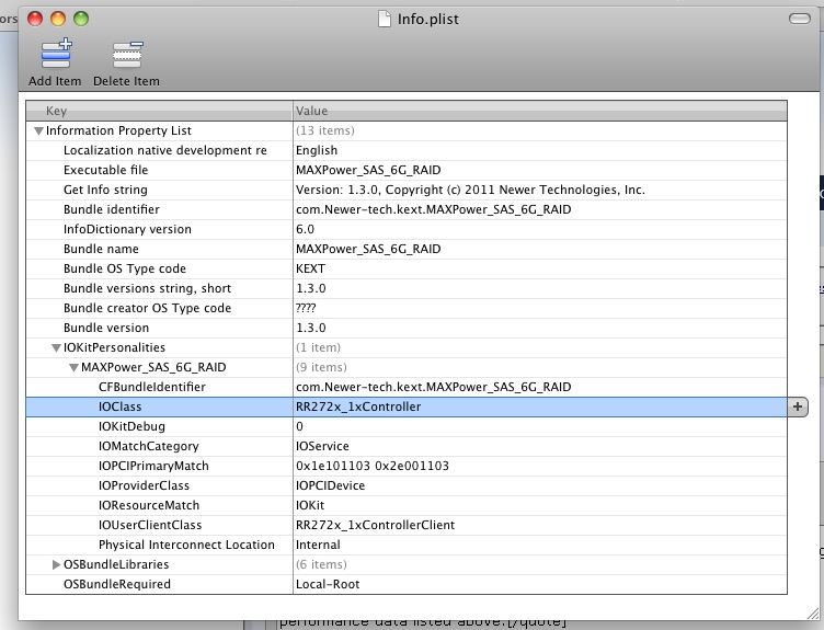

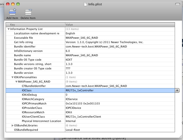

A further update:
The card's vendor ID is 1103. Anybody that's used a RocketRAID card will recognize that ID instantly. The NewerTech card(s) are really just rebranded RocketRAID 2721 and 2722 cards for the Internal/External and External Only models respectively.
Along with a $30 price hike vs. what you can get the 2721 for at Newegg, you'll (hopefully) get English speaking tech support and something other than the craptacular HPT minimalist web ticket form for tech support.
Another dead giveaway that this was an HPT card in disguise: When I did the NewerTech driver install two of the install entries listed Upgrade: The RAID management software. The only way this should be an "upgrade" is if I'd installed the software before, and I did: when I had the RocketRAID card installed. I didn't uninstall because their uninstaller (HPT's) doesn't remove the RAID management software, hence the "upgrade" when I installed NewerTech's drivers.
The upshot? The auto-passthrough mode is definitely nice for JBOD users like myself that want to eventually update to RAIDs once enough SSDs are procured.

A further update:
The card's vendor ID is 1103. Anybody that's used a RocketRAID card will recognize that ID instantly. The NewerTech card(s) are really just re-branded RocketRAID 2721 and 2722 cards for the Internal/External and External Only models respectively.
The upshot? The auto-pass-through mode is definitely nice for JBOD users like myself that want to eventually update to RAIDs once enough SSDs are procured.

If you don't believe that this is a 2721, here's the two pages. View them side by side and look at the cards. You'll quickly see what I mean.
NewerTech card vs. RocketRAID 2721.
Viewing the images of the card side by side you can see that they're identical. Only (possibly) the firmware is slightly different. But if you need more proof, here's a pic of the info.plist from the MAXPower RAID driver:
My mention of the ESN and FCC ID suggestion had nothing to do with not believing you or not (expect you're right). But rather trying to figure out who the ODM is, as neither OWC or Highpoint design or manufacture their own products.
Both are Marvell's Reference Design from what I can tell, so they *could* be from different ODM's. Though its more likely that it's the same ODM supplier, and they just changed the PCB solder mask and legend colors for OWC (Highpoint was too cheap to even pay for that... 🙄 😱 😛).
Marvell reference design or not, the software is definitely HPT.
That doesn't surprise me either (cheaper and easier for OWC to get software that's already been written whenever possible).
And HPT doesn't develop all of their software either (i.e. Areca supplies the software that HPT modifies a bit for their Areca manufactured RAID products).
In the case of this particular card, Marvell likely supplied code to HPT as well, and went from there.
Well, it's working without so much as a hiccup so far, so this may be a keeper, for now. I really wish that Areca card hadn't had an SAS expander built in - I have a feeling that's what made things wonky. It'd have been a perfect card with a 1:1 natural port ratio/connection, but meh.

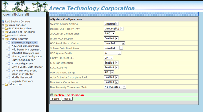

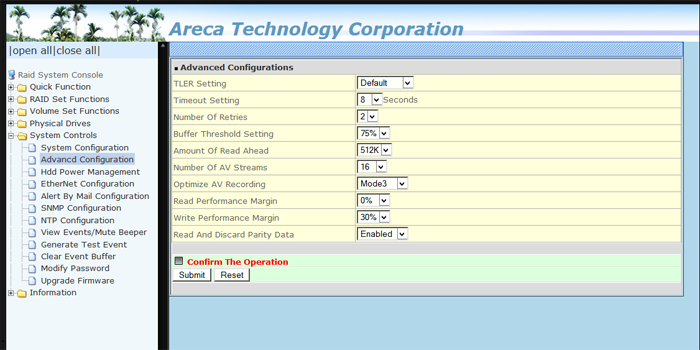

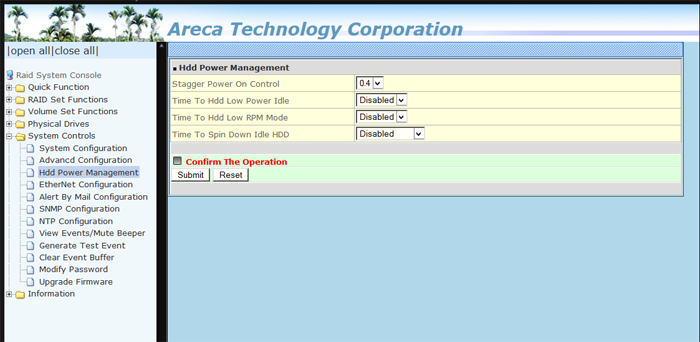

ARECA 1880ix-8 SSD/HD Settings
NanoFrog,
I updated to beta 07/12/2011 Firmware, i notice few new settings. Could you take look and let me know what you recommend when using SSD and HD on same ARECA Controller.
1.
2.
3.
NanoFrog,
  1. What exactly are you doing?
  2. What disks are you using (make and model number)?
  3. How are they configured (Pass-Through, JBOD, or what level of RAID)?
  4. What other equipment is part of the storage system, and how is it configured (enclosures, mounts, UPS <make and model could be useful>, ...)?
  5. And are you having any problems?
I ask, as the answers can help. Given the lack of detailed information, all I can recommend now, is try out the default values, and see if it's stable (includes testing power failure <pull the power cord>, pull disk/s to simulate disk failures, ...).

Aerca Controller 1880ix-8
4 x 120 GB OCZ Vertex 3, RAID 0 Triple Boot OSX 10.7.1, Win7, Ubuntu 11.04
8 x 1TB SATA 3 6Gbos HD RAID 6 = 4x Internal Port & 4 x External Enclosure
Highpoint 2310 "I know, it's old but does what i need it to for now"
4 x 120GB OWC RE SATA 2 3Gbps RAID 0 "I use as my SCRATCH DISK for projects"
"Plan on upgrading & getting External Enclosure for 8 HD"
I use Parallels , Xcode, & use to do lot of editing with FCP. Use my MBP with FCP Studio for now. I Haven't made switch to X. Been little slow in department due to recession.
Im little concern on power im pulling. I use Quadro 4000 for Mac, which doesn't pull as much as ATI cards.
Areca Controller 1880ix-8
I still don't know what the actual models of the 1TB mechanical SATA disks are (OWC info is enough to go on), or if you're having any problems.
Unfortunately, Areca doesn't publish any SSD's on their HDD Compatibility List (best to buy drives listed on this; they don't test all of them in the series, but if one is there, the others will work).
So if everything is working fine, leave the current/default settings alone.

There have been issues. But those on the HDD Compatibility List will work (Staggered Spin-up value has had to be increased to 0.7 seconds in a couple of cases with Seagate ES's on the ARC1880 series, but this isn't an uncommon issue).
Newer disk firmware may have precluded the need in your case however. But if they do become unstable (see drop-outs, and the set degrades), then change the value and see if that fixes the problem (also seeing a lot of Seagates ES models going bad within 3 years, so you've been warned).
