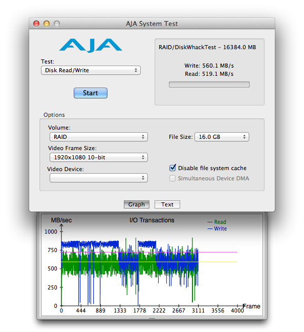

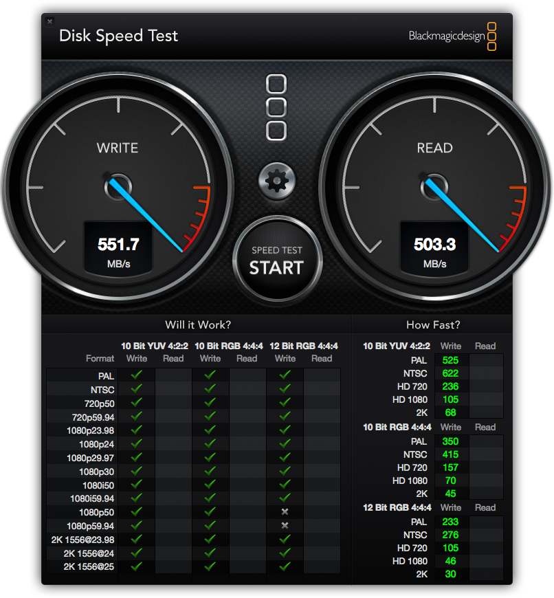

As promised, here are the AJA and Blackmagic test results. Blackmagic can be somewhat misleading at times due to the 5GB max test size vs AJA's 16GB. I re-did the Blackmagic test just now and the results are more consistent. I love this RAID. 🙂

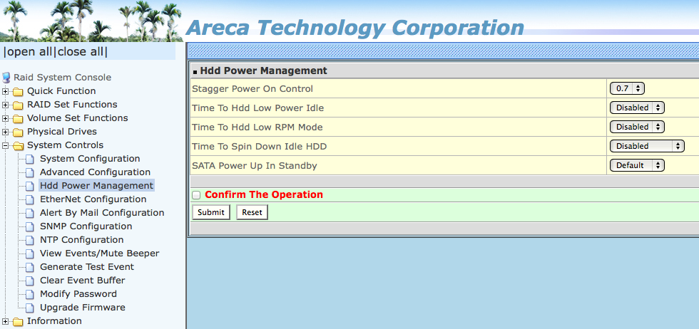

Yeah, if you go into the RAID manager (I use the web UI and not the app) and go to System Controls -> HDD Power Management you can change or completely disable power management. Here are the settings I use, the Areca itself and the drives stay powered on all the time.
Also, make sure that you do NOT have "Put hard disks to sleep when possible" checked in your Mac system prefs as that may also be triggering sleep mode.
