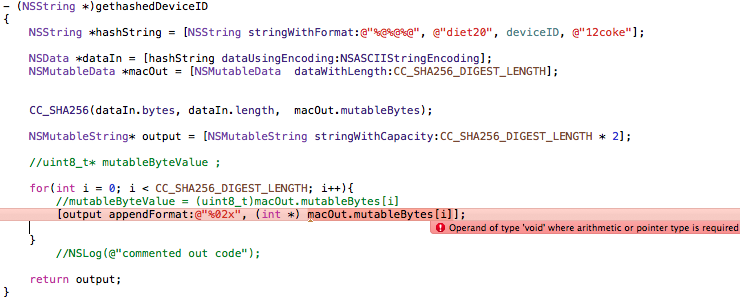

The confusing part is this apparently compiled fine in 10.7 + Xcode 4.3 that the previos developers had used. They are no longer available for comments hence the conundrum. In the meantime I have tried a few different approaches such as type casting and using temp variables etc. but none of that seem to be helping.
Any other ideas ? I understand that I might be making very basic mistakes here but I do intend to learn as much as I can in the process.
Thanks for your responses!
Honestly, I find that hard to believe. When I look up that method in older reference docs, it has always returned (void*). And ever since the 'void' type was created, it's been illegal to dereference a pointer to that type. So unless there was a compiler bug that somehow allowed it, or the declared return-type somehow changed for a brief period, I see no way it could ever work as given.
When posting code, it's better to copy and paste actual text. It's much easier to work with than pictures of text.
As given in the picture, your type-cast is completely wrong. You need to cast the pointer before it's subscripted. You also need to cast it to the correct type, an unsigned byte, otherwise you won't be converting the bytes of the data, you'll be converting the bytes-interpreted-as-ints. A suitable temp variable of the correct type would also work:
Code:
uint8_t * theBytes = [macOut mutableBytes];
for(int i = 0; i < CC_SHA256_DIGEST_LENGTH; i++){
   [output appendFormat:@"%02x", theBytes[i]];
As I said before, it's basic C.
