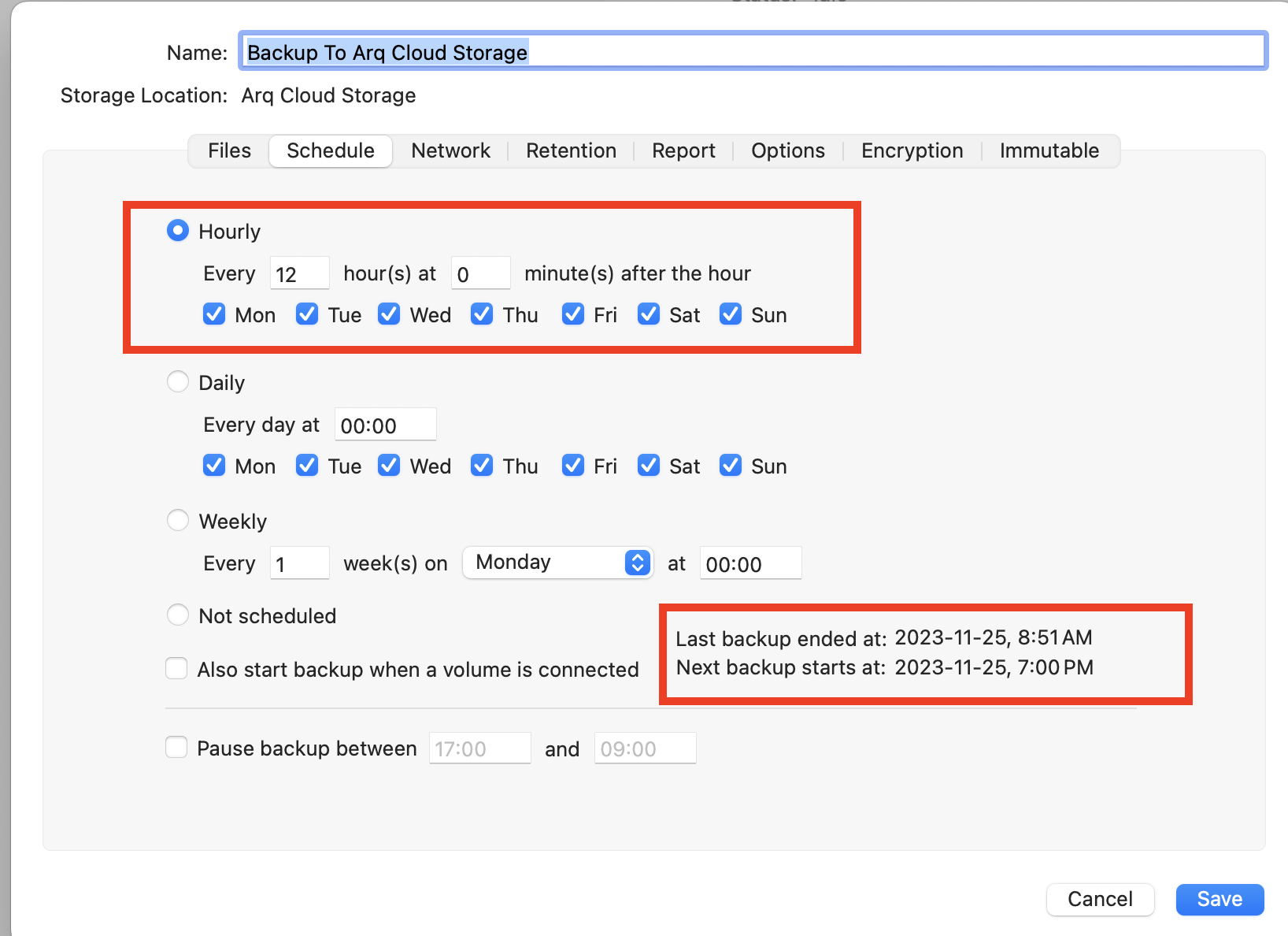

I am running Arq 7.26.3 and macOS 14.1.1
I am trying to get Arq to run every 12 hours, at 12:00 AM and 12:00 AM.
I have the Arq scheduling window configured as per the below image noting that the next backup is scheduled to start at 7:00 PM even thought it is now 11:40AM (i.e., I would have thought that this setup would result in the next backup being run at 12:00 PM and then every 12 hours thereafter.
If I wait until 12:00 PM to run the backup manually, teh next scheduled backup still runs every 12 hours at 7:00 AM and 7:00 PM, not the 12:00 AM and 12:00 PM that I am aiming for!
In addition, I have no idea where the 7:00 AM / 7:00 PM times are come from!
THE ASK: I would appreciate any and all help in getting this fixed!
Thank you!

@Apple_Robert , I appreciate the response but would appreciate a little more help:
1. How do you enter two times into the "Every day at" field as "12:00, 23:59" or "12:00 23:59" does not work. I believe that only 1 time can be entered into the field because every time I try to enter two times I get the following message:
2. What do you mean by "Your settings show every 24 hours"? Where are / do my settings show this?

An update:
I have Arq setup to run "Every 4 hour starting 0 minutes after the hour". I started the first backup at 8:00 PM and got the following results:
Backup 1: Start time = 8:01 PM, End time = 11:09 PM
Backup 2: Start time = 3:00 AM, End time = 5:38 AM
Observation --> the 4 hours is from the end time of Backup 1
Backup 3: Start time = 7:00 AM, End time = 8:00 AM
Observation --> the 4 hours is from the start time of Backup 2
Backup 4: Start time = 11:00 AM, End time = TBD
Observation --> the 4 hours is from the start time of Backup 3 and back/locked onto the 7:00 AM previously noted.
I will keep monitoring and update later in the day.
QUESTIONS:
1. How / why does it make sense the the first 4 hour period is the measured from the end of the first back set with subsequent 4 hour period measured from the start of the second and subsequent backup sets? With not knowing how long a backup would take, the would give the use no control as to when backups would occur.
2. I am begging to think this is a bug. Comments / thoughts?
Thanks and look forward to your comments / thoughts?

UPDATE: I have now completed 7 backups and note the following:
1. @gilby101 is absolutely correct in that n backup plans -> n backup sets (even for backup plans that are identical other than the time). Thank you @gilby101 !
2. If a backup plan is setup to run "Every X hour starting Y minutes after the hour" then
a) the second backup plan will start X hours after the first backup plan end time
b) the third and subsequent backup plans will start X hours after the second and subsequent backup plans start time
3. Written Arq / Stefan to modify Arq to
a) Allow scheduling at multiple specific times; and/or
b) Tweak the "Every XX hours YY minutes after the start of the hour" to consistently use the start time of the backup plan.
Thanks to everyone for their help in working through this!!
Reactions: gilby101
I had a email exchange with Stefan who explained how “Hourly / Every XX hours starting YY minutes after the start of the hour” works! And it is different than we thought!
If, for example, one schedules a backup to occur “Every 12 hours starting 0 minutes after the hour” then Arq interprets / sets backups to run at 12:00:00 UTC and 24:00:00 UTC. With my location being in EST, the backups therefore occur at 07:00 EST and 19:00 EST, which explains why I was locked in to 07:00 EST and 19:00 EST (mystery solved)!
Stefan also shared that he will not be tweaking the scheduling.
With that, I will revert to scheduling the backup at 12:00 AM every night and forgo the mid-day backup.
I hope that helps people! I know it helps me!
PS. Huge thanks to Stefan for taking the time to explain things!!
