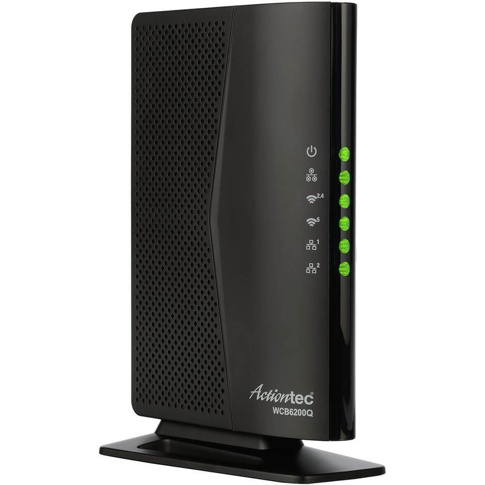

Modem is ARRIS TG1682G. I don’t think mine is a router built in, cause according to the spectrum website, mine is a modem/voice combo.

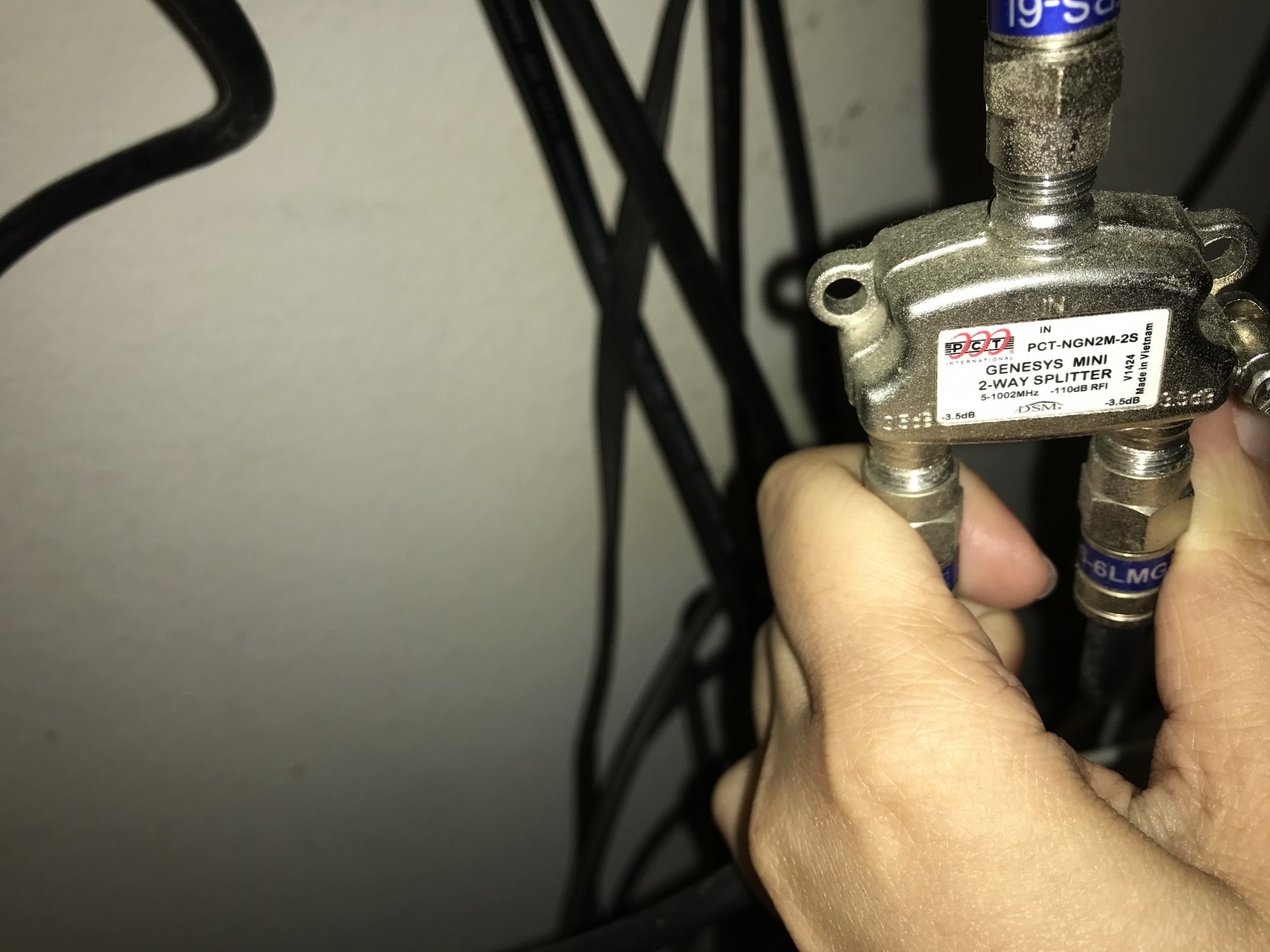

access point is an ActionTec WCB3000N. I see a coax splitting that it’s connected to.
Ports are just 2 Ethernet, a coax and a place for the power cord to plug in. I have the power and coax plugged into a splitter. The modem is downstairs in the master bedroom, and the AP is in my room. I have great signal downstairs, but when I get upstairs, it becomes a dead zone and this AP has been the solution for that this whole time.
As far as Ethernet goes, I don’t have anything hooked in cause it’s too far to stretch the cable.
The TG1682G is a combo router\modem according to specs, if it were not a router, you would have another unit connected to the modem. This supports MOCA 2.0 according to specs, and the WCB3000N seems to support MOCA 1.0.
Several Amazon reviews suggest the MOCA connection either needs to be "authorized" by your cable company, or is set in the router settings and needs to be periodically reset. From a screenshot here, I suspect it just needs to be toggled to enabled on the Arris. On the Actiontek, apparently there is a privacy setting that needs to be disabled? You might have to tinker with the settings on both units.
So, MOCA is similar to Powerline Ethernet, but is integrated into these two units.
On the Actiontec unit, there should be an LED for MOCA that would light up green if there is a good coax (MOCA) connection.
If this doesn't resolve your issues, there could be a disconnect in the coax cables between the units. Not sure how to advise on that, it is unique to each home.
If you grow frustrated with all of this, the extender would be simplest to replace.

Yeah, the COAX light is green. Actually, all the other lights are (power, 2ghz and 5ghz). I will have to check out that the Arris settings again.

Gotcha. So it’s more work than I expcted. I looked on the ActonTec website and they have an updated WiFi extender to the model that I currently have now. Maybe I should stick with them and get that device when this one craps out since it seems like it supports MOCA.
I think what I’m looking for is something that will just take the place of the Actiontec and work with the Arris Without having to get a new modem, etc.
MOCA 2 is faster (up to 1Gbps) than 1.0 (100Mbps) and there may be subtle differences, but they are compatible.
Eero is intended to replace your router and extender. It can interconnect with either WiFi or ethernet. It does not inherently support MOCA, but MOCA can be implemented with adapters much like power line to send data over existing wires. Again, MOCA uses existing coax cables, power line uses the electrical lines in the home. Your current gear has MOCA adapters built in, but standalone adapters exist as well.
The 3 pack you linked is dual band and I would assume shares the client and uplink WiFi connections. What this means is lets say you have the first unit installed and it gives wireless clients speeds of 500 Mbps. You connect a second unit wirelessly, and clients connecting to either would get about half the speed, or 250 Mbps because the capacity of the radios is split between clients and linking between the two units. Add the third and wireless bandwidth drops even further. But, there is also the question of signal strength between units (more below). If you could set these up with ethernet links between units, the speed drops are eliminated.

That linked Actiontek would likely be an improvement over the one you have. It offers 802.11ac (WiFi 5) which is faster than older WiFi. And, it is MOCA 2.0 Bonded, meaning more bandwidth between the extender and router (which has 2.0 as well). I am not entirely certain if the router has restrictions on what extenders it may support, but Spectrum may know since they supplied the router.

Also, if I were to get this updated Actiontec, it does come with a new coax cable. I have my devices on a coax splitter right now since my cable box is hooked up to it too. Should I just use my current coax cable and just screw it into the device or should I actually swap out the coax and use the new one? Will it make the speeds better?
ETA: Spectrum says they can’t confirm if it will work or not since it’s a third party device and they don’t support third party devices. *sighs* I mean I assume it would since it supports MOCA, and my Arris modem supports it, and I figure if my old AP would work with it, this would should. *hopefully*
ETA2: Spectrum seriously just tried to sell me a 2nd modem, saying that they recommend I purchase one to get WiFi in the whole house. 🙄 also, there would be a $50 trip charge if I had a rep come out and install a 2nd modem.
The splitter may be a problem. What does the label on the splitter say? Maybe you can snap a picture of the label?
The Actiontec says it comes with a coax splitter too
If worse comes to worse, would something like this work? Setup seems pretty easy, and only need to hook the extender up to power supply. I was reading some spectrum stuff on reddit, and some have said spectrum cut off their MOCA connections. The only reason I have this Actiontec is that it’s a “grandfathered“ plan. So I’m kinda afraid that the Actiontec won’t even work if I upgraded to that new one and installed it myself. But then again, my modem does support MOCA and that’s how my modem is hooked up so they can’t shut it off.
Start with replacing the splitter. MOCA uses higher frequencies so you may be filtering out data. Something like this.
That should help with connections using the upstairs extender, better throughput to the router. It may be enough to take care of things.
In networking, a lot of errors may cause resets on some devices, that may be why the network goes out every 12 hours. If that takes care of it, well a pretty cheap fix.
MOCA uses frequencies up to 2600 MHz or so, the filter is rated for lower frequencies which may have been ok for TV signals, but when you updated the router, it may have caused issues using that splitter.
Hmm that’s a good point. should I replace the splitter first, and then the extender later on?
