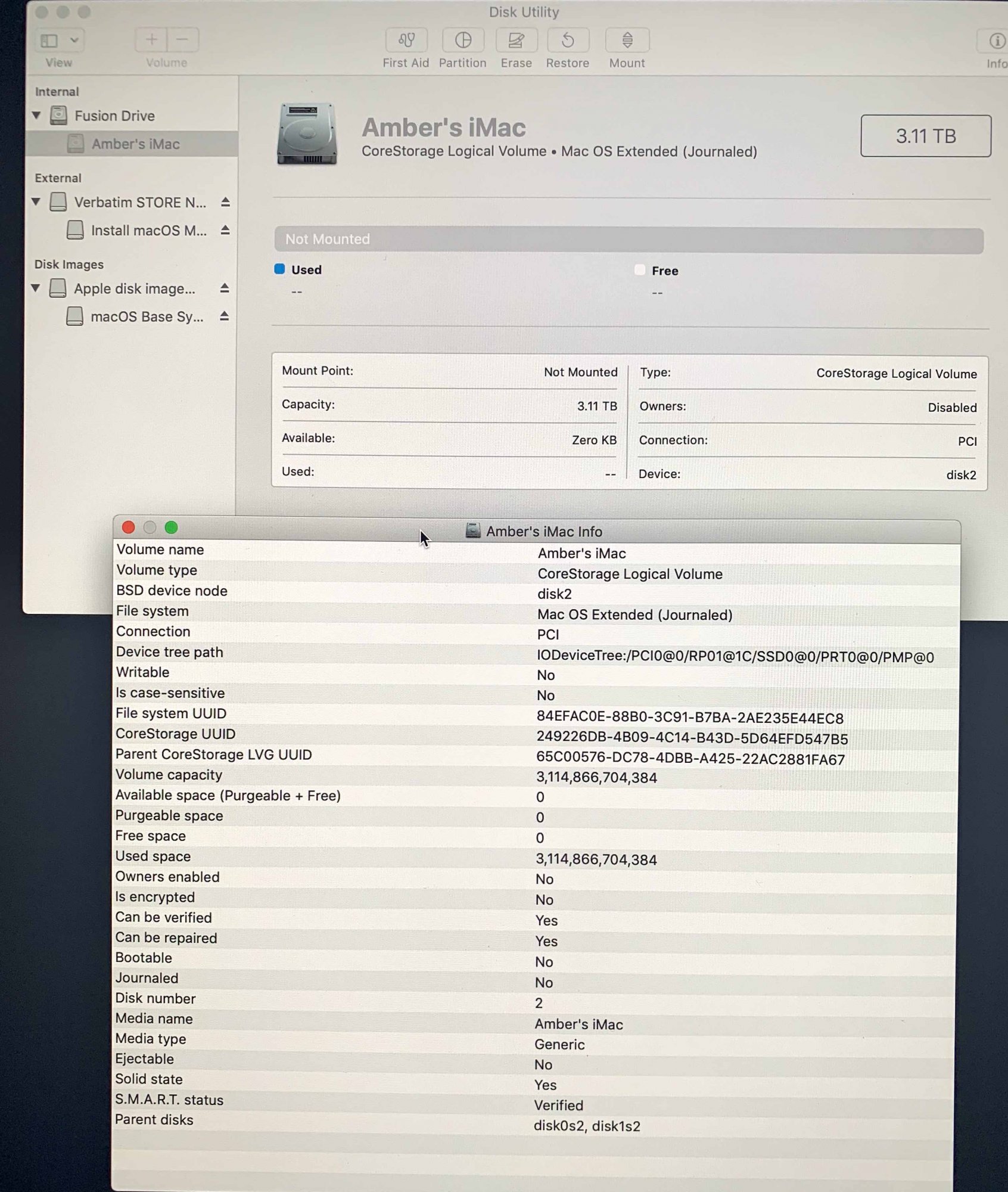

Rebooted (again) from the USB & was able to see the drive.
Attached is a screen shot & I'm just running first aid in Disk Utilities.
This shows the drive isn't mounted. Should I try to mount the drive?

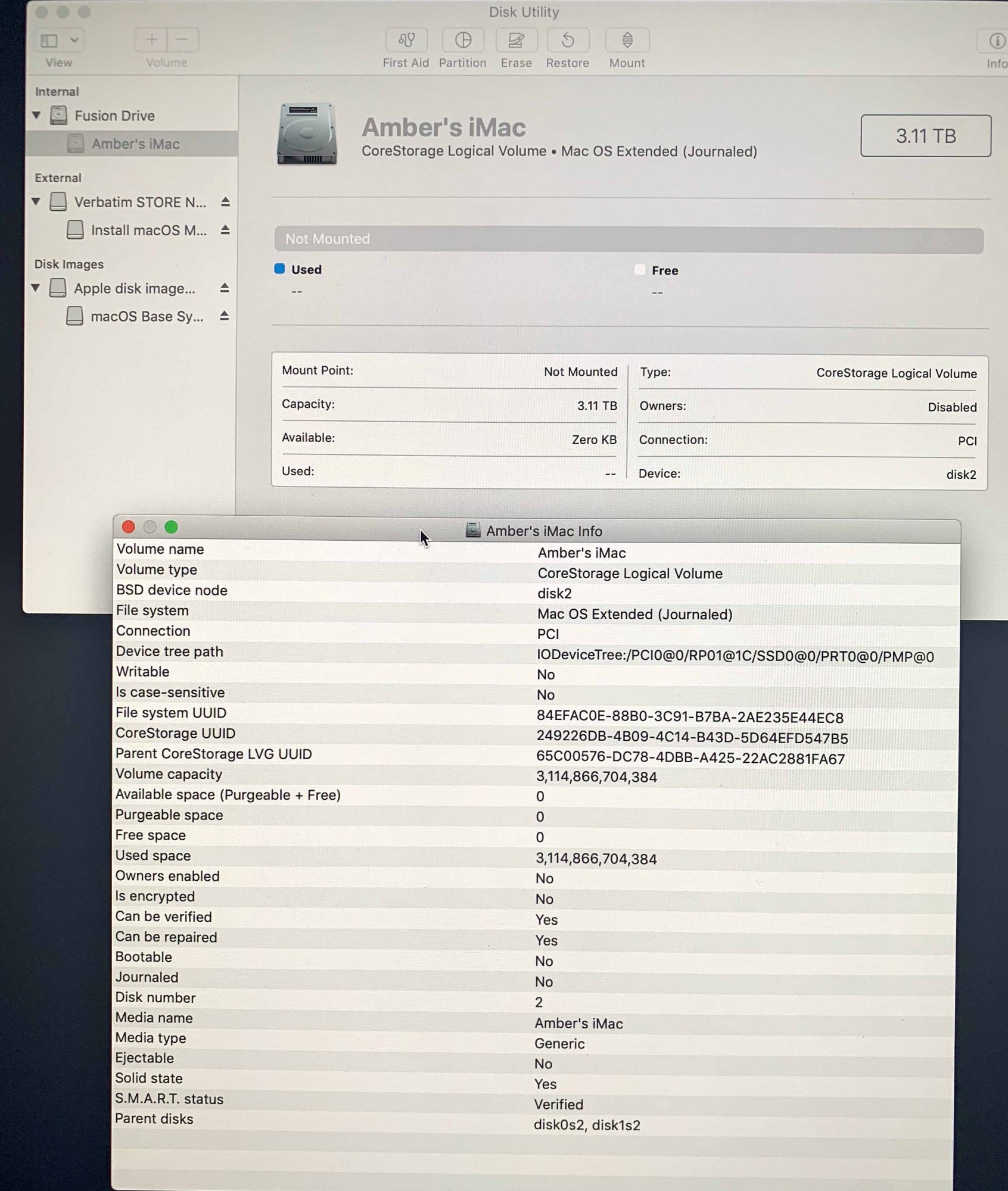

Yes, you can try. I see now it is a fusion drive which complicates things a little.
