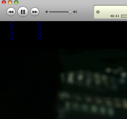

The MBP was bought in Feb and now it has a long line of artifacts on the menu bar. I found a temp. fix by hooking it up to a display, mirroring the display then unplugging it. But when I reboot it is back. This started 2 nights ago. Also When I do the fix everything is fine, but it is a pain to do. Also in iTunes video does play fine during the fix but when the artifacts are there video sucks. also the little x in itunes to x out a movie shows up fine. Right now the GPU temp is going between 57 and 67 degrees Fahrenheit. It is a SR with a 128 MB video card.
Heres one some. I did my temp. fix to get the menu bar ones away. I also forgot to mention I did an archive and install.

they are consistant on the menu bar but every once in a while if a open a window with something moving I get some. Sorry it took so long to reply the hurricane just came through the power is out and I'm posting from a friend's iPhone 3g because my 1st ten iphone can't get a signal.😱
Does your MBP have an NVIDIA graphics chip in it? Could be on the verge of failing. Time to send it in for repair!
