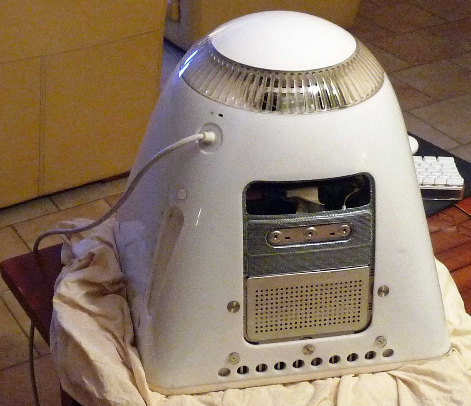

At the risk of being chastised by a member for resurrecting an 'old'? (Dec 2016) thread, I thought the following may be of interest to some who may ever plan to pull apart an eMac.
As mentioned previously, mine was picked up at a Thrift store with a non-ejecting CD tray. IFixit is often helpful, but I always take photos during disassembly which have proved invaluable to re-check on cable-runs, Kapton tape and electrical connector locations etc which are not always too clear in all the iFixit instructions.

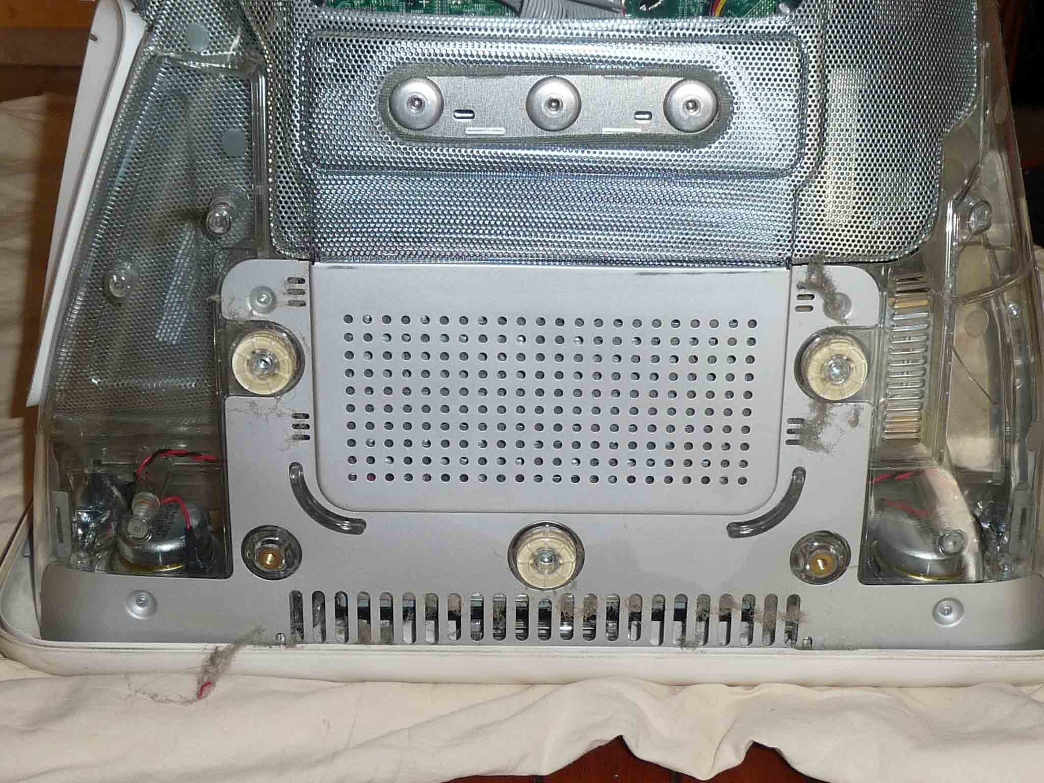

Pic 1. Bottom-up - awaiting piles of surgery........🙄

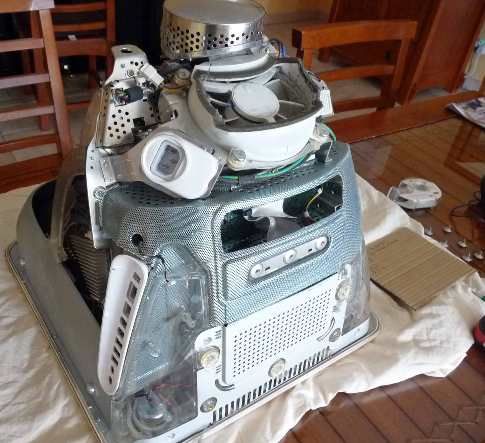

2. Outer case removed: (note the frayed black power lead, just below centre left). All the edges of that perforated metal shield are razor sharp, and unless one wears gloves, can easily end up with skin resembling that power lead sheathing.

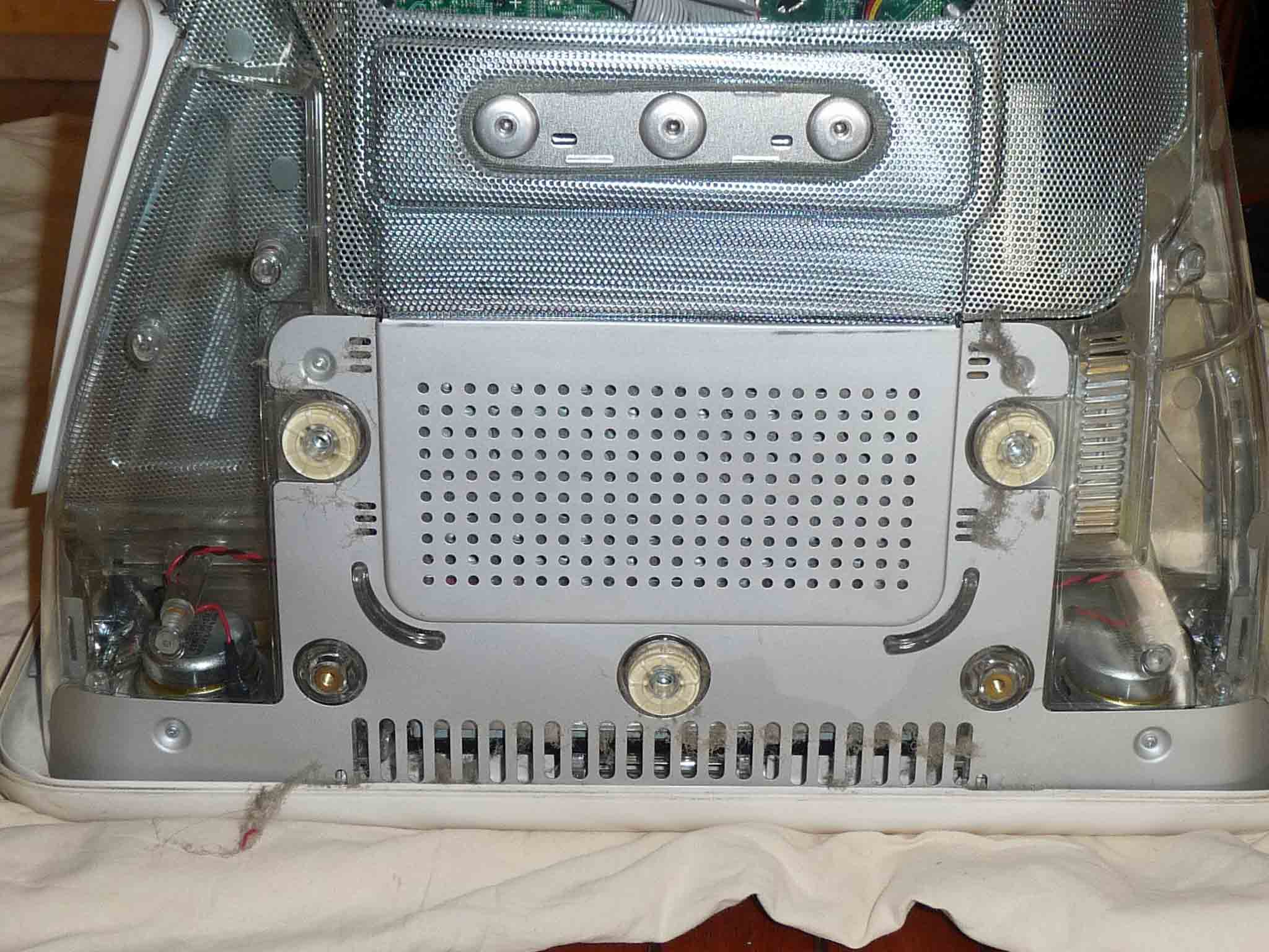

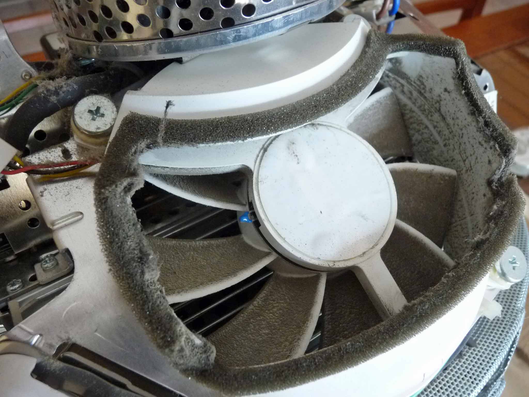

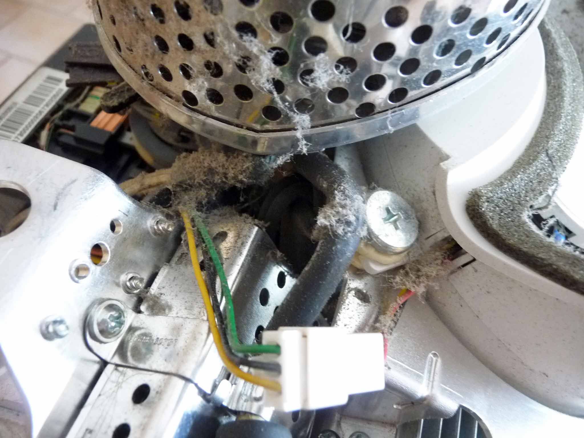

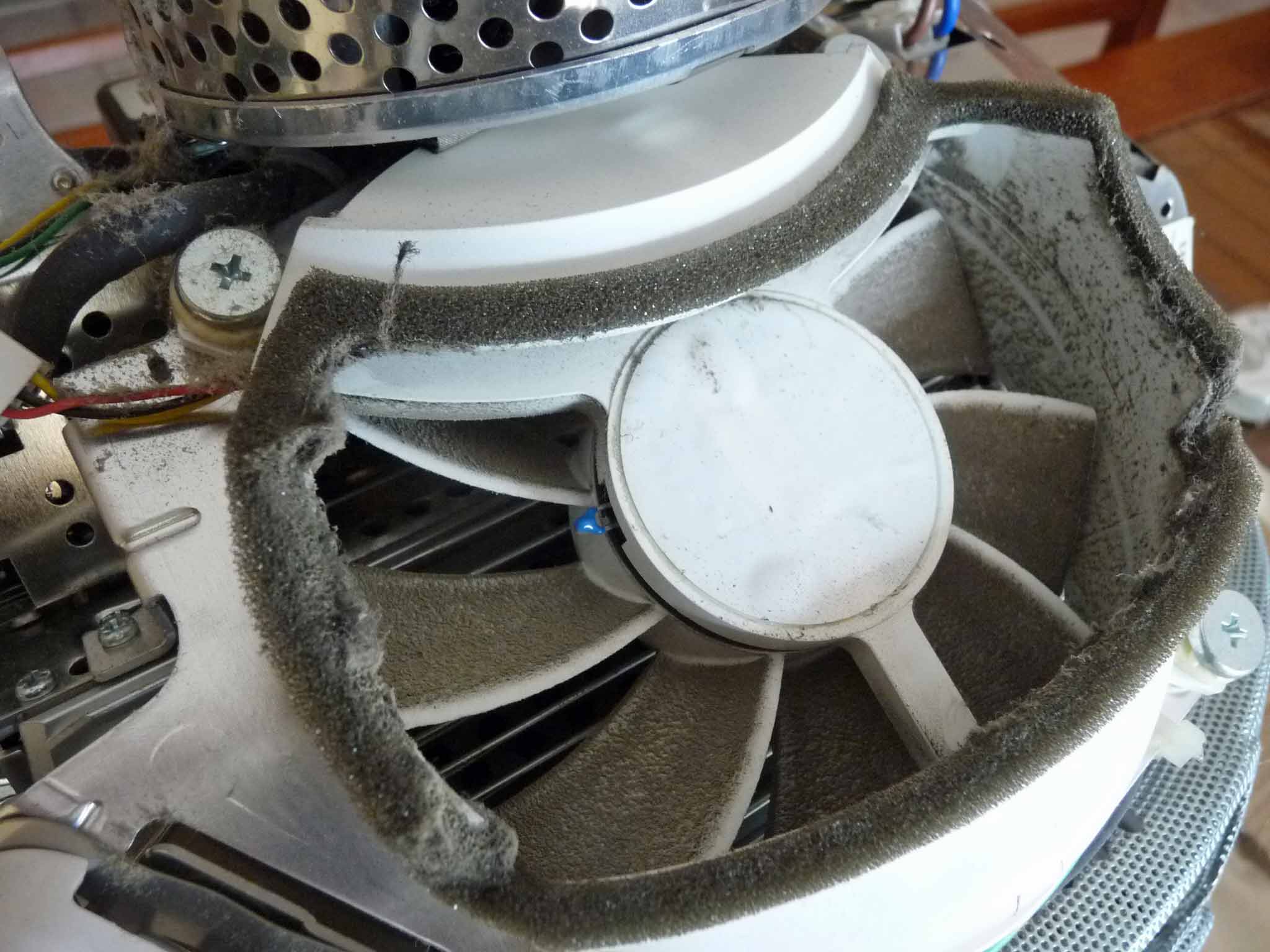

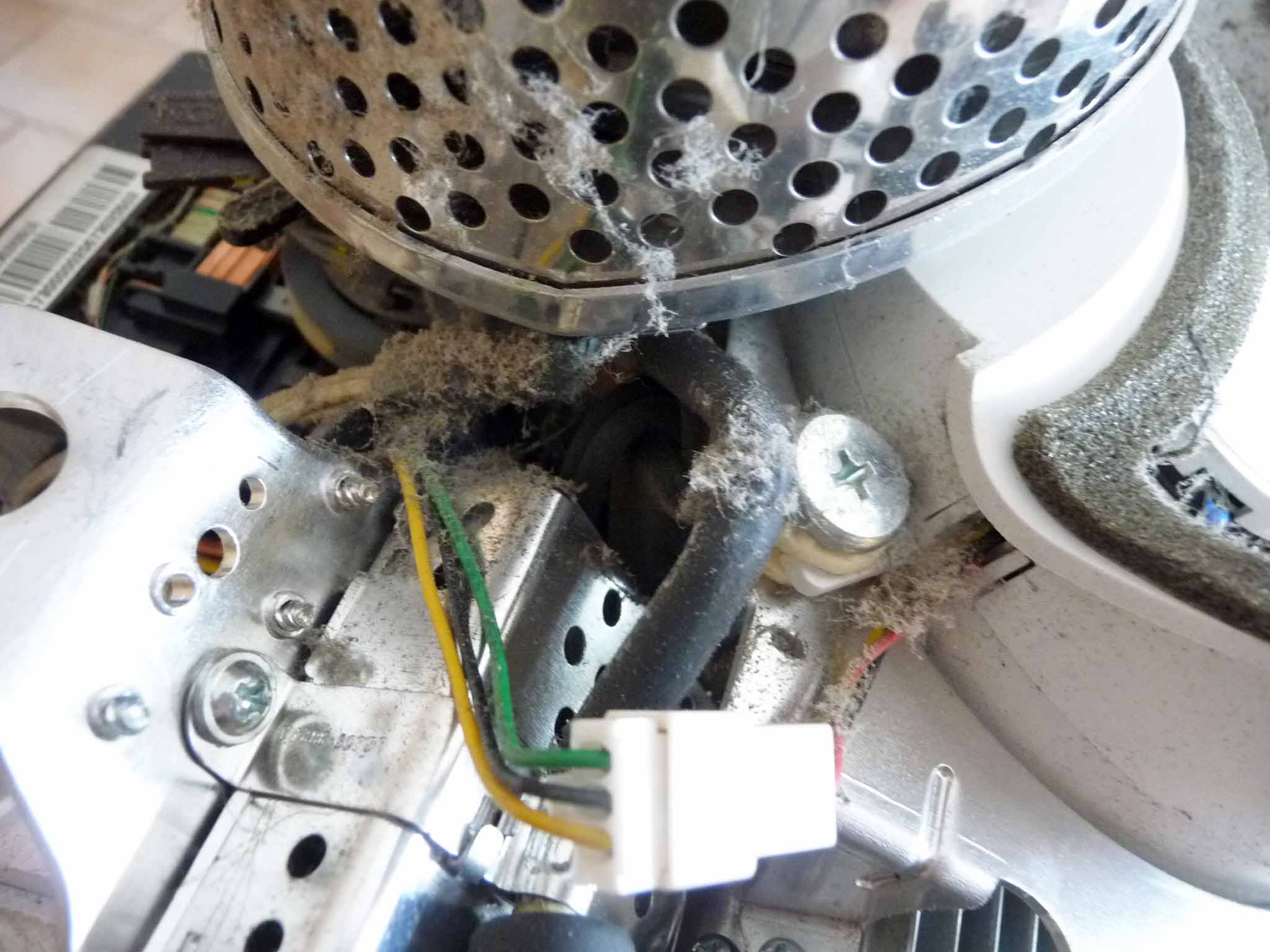

3,4,5. Indicates just how dust/dirt accumulates over time, especially around fan area, and lower vent location(5).

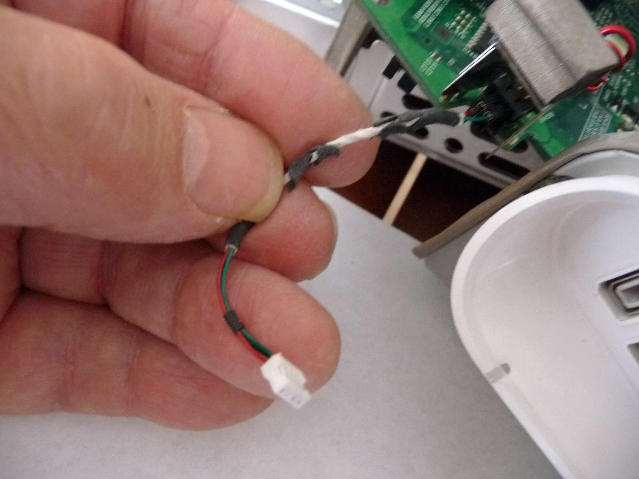

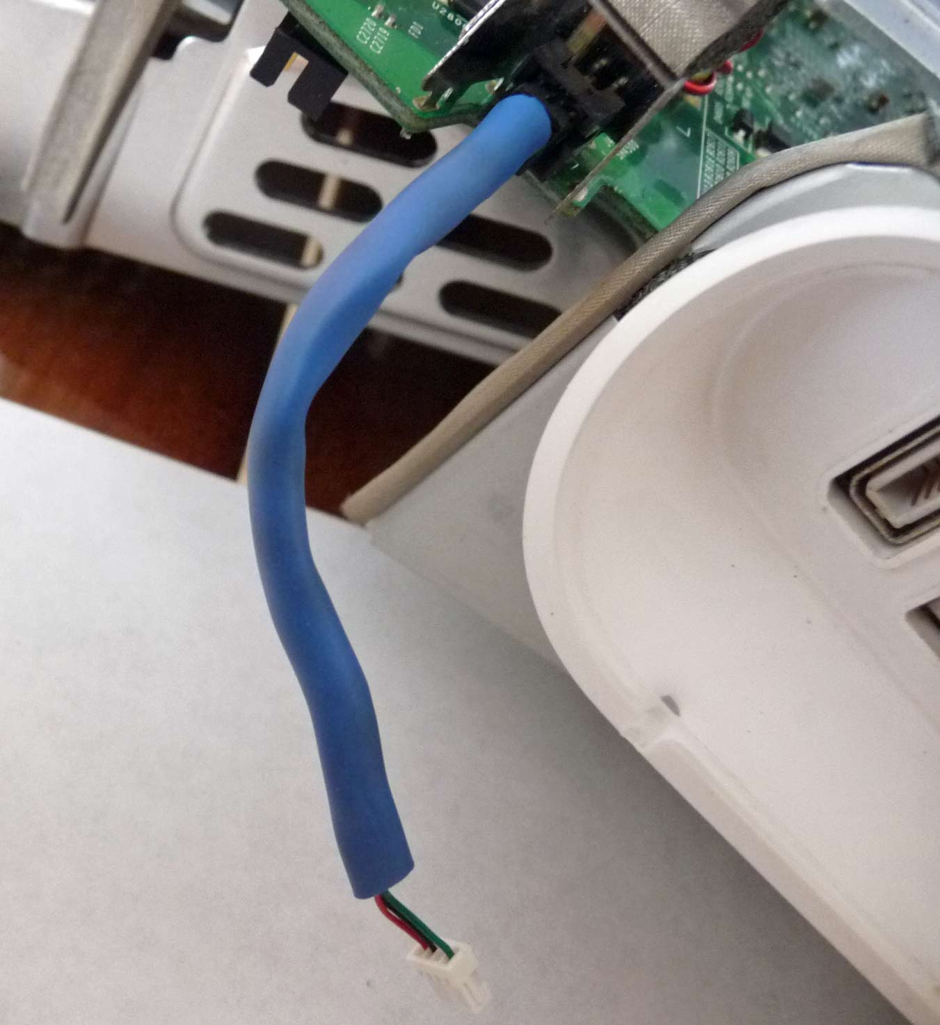

6. Detail of the electrical lead to the power switch - chafing and deterioration of the outer sheathing.
7. This was easily remedied by adding a length of shrink-sleeving.
The above action appeared a good idea at the time, but I would find out later that the lack of flexibility on this lead made reconnection to the power switch difficult (within the constraints with outer cover repositioned).

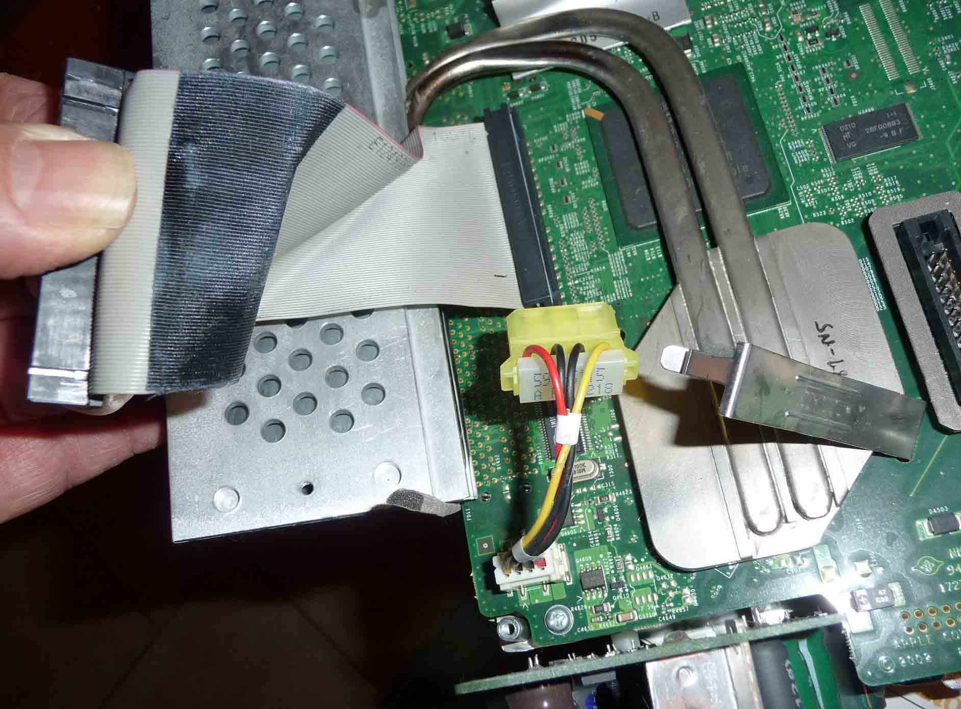

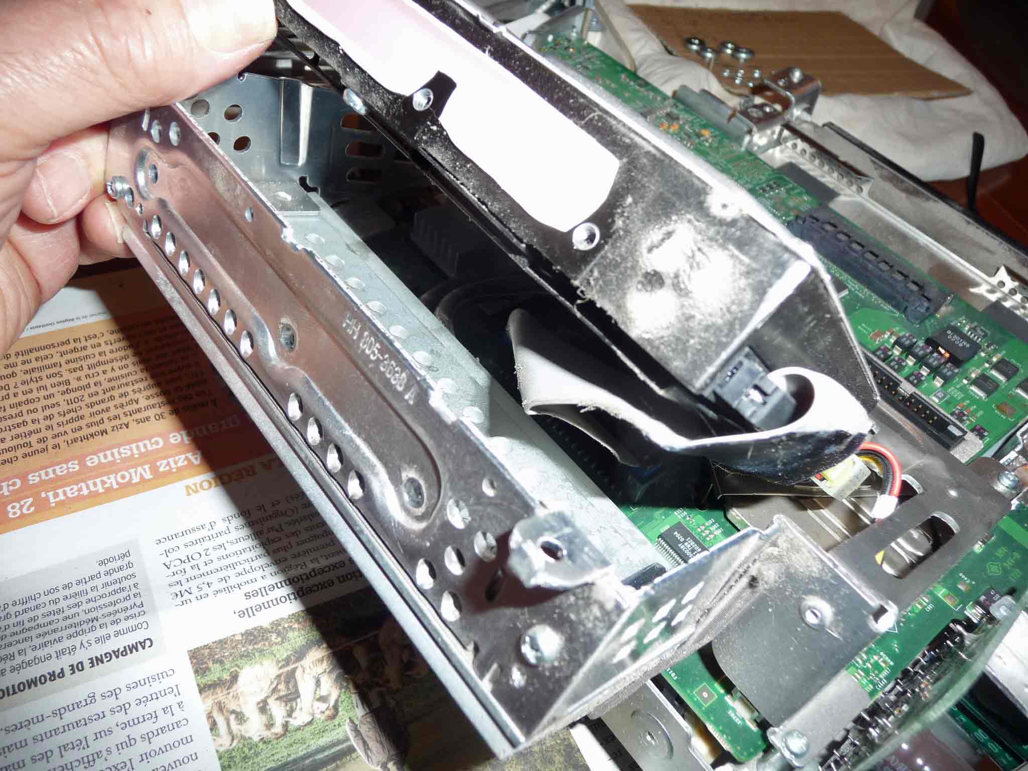

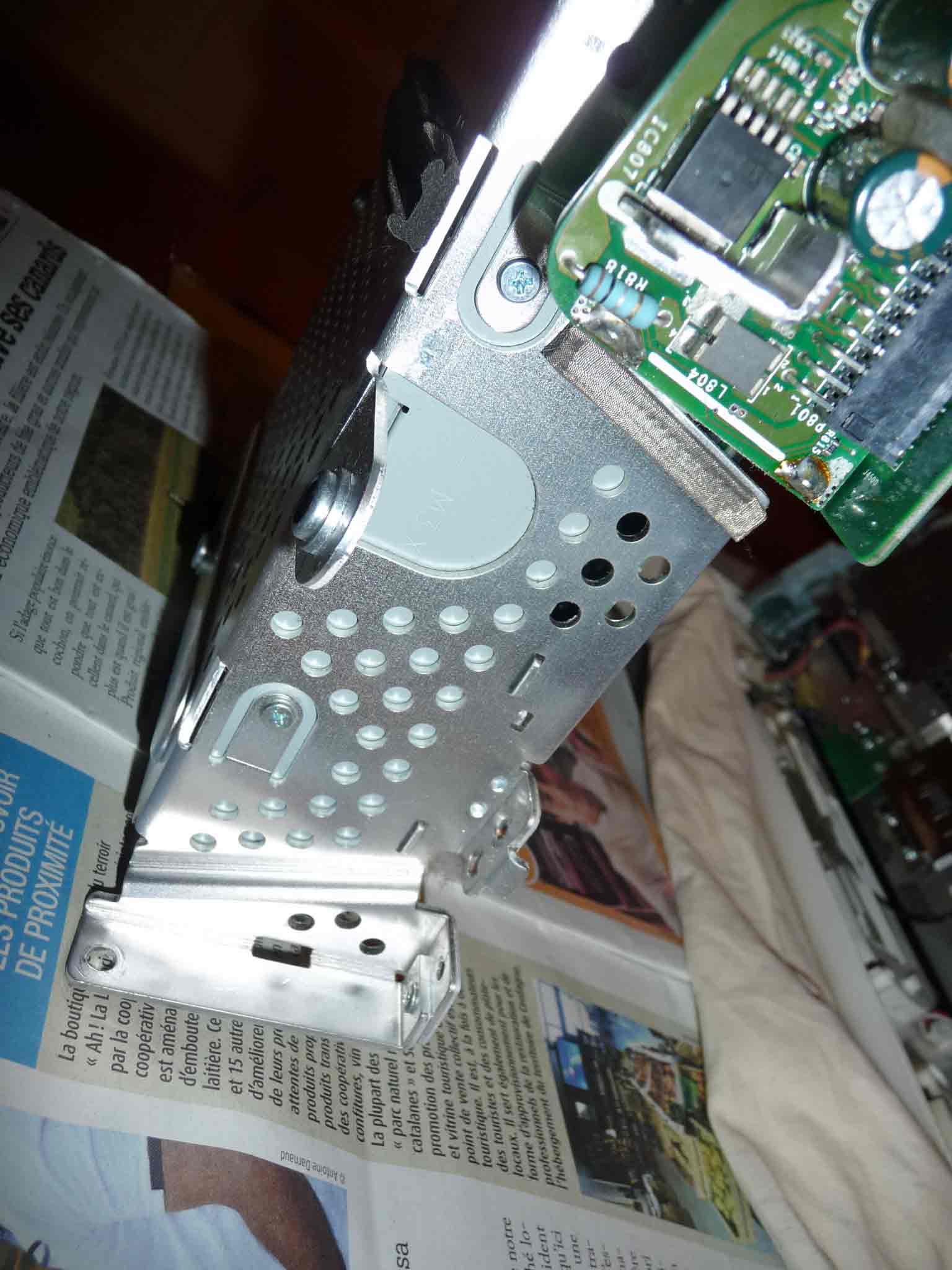

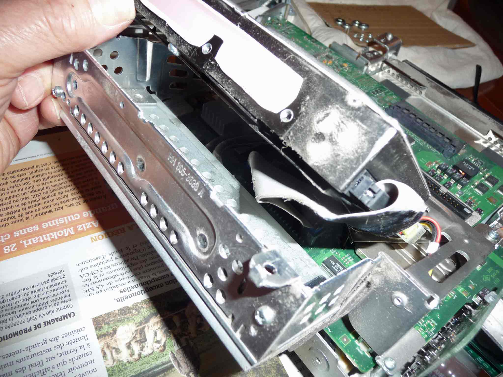

The optical drive & HD are attached to the mother board carrier assy which needs removing to gain further access. This necessitates the disconnection of numerous electrical connectors.
Caution!! The CRT MUST be discharged, otherwise a potentially lethal electrical shock will at the very least make your hair stand on end! DONT risk it!

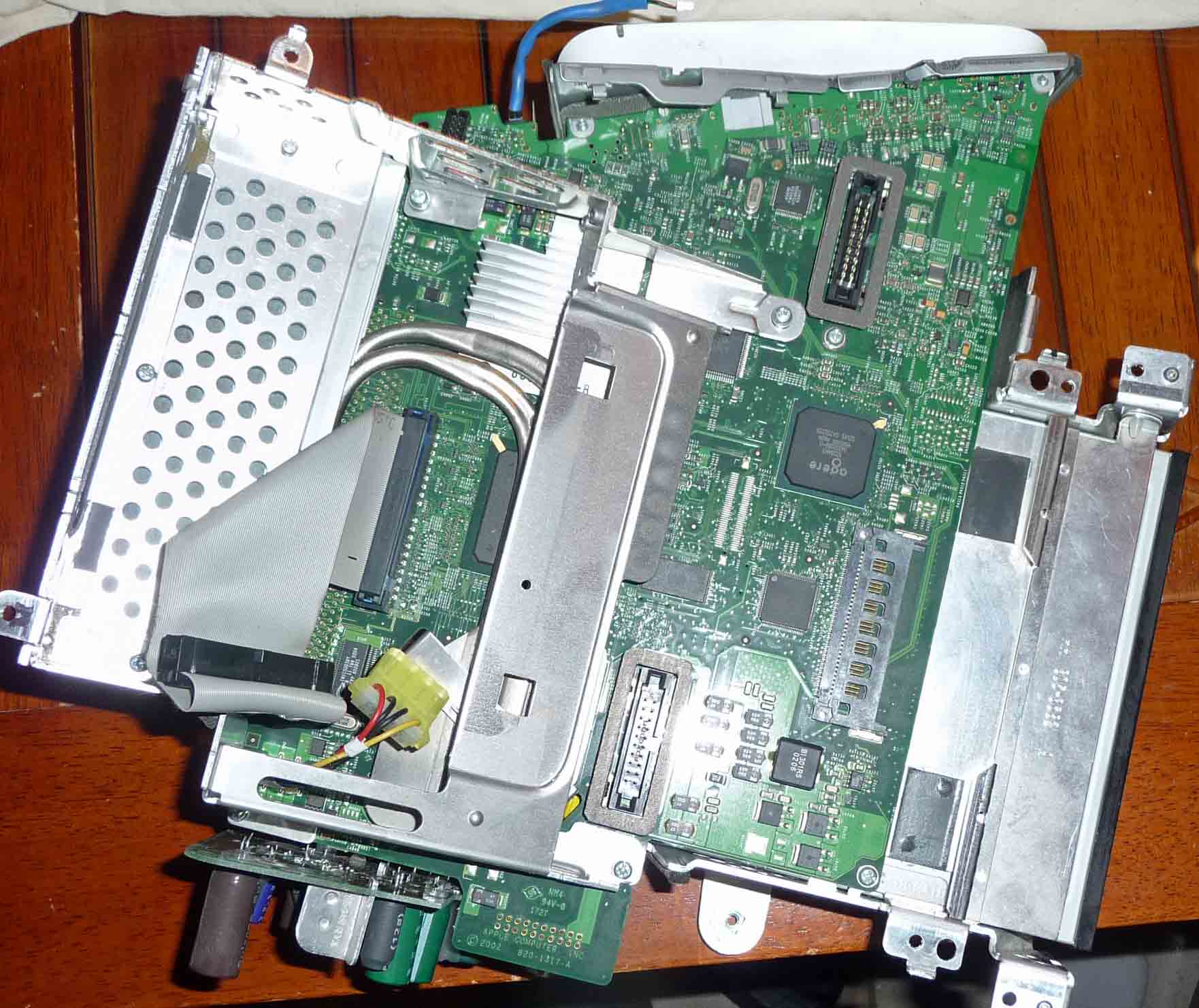

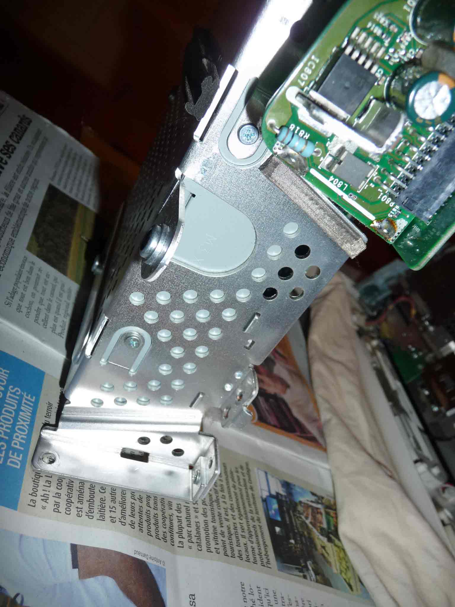

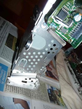

8, 9, 10. Motherboard carrier Assy removed with optical drive & HD still attached.

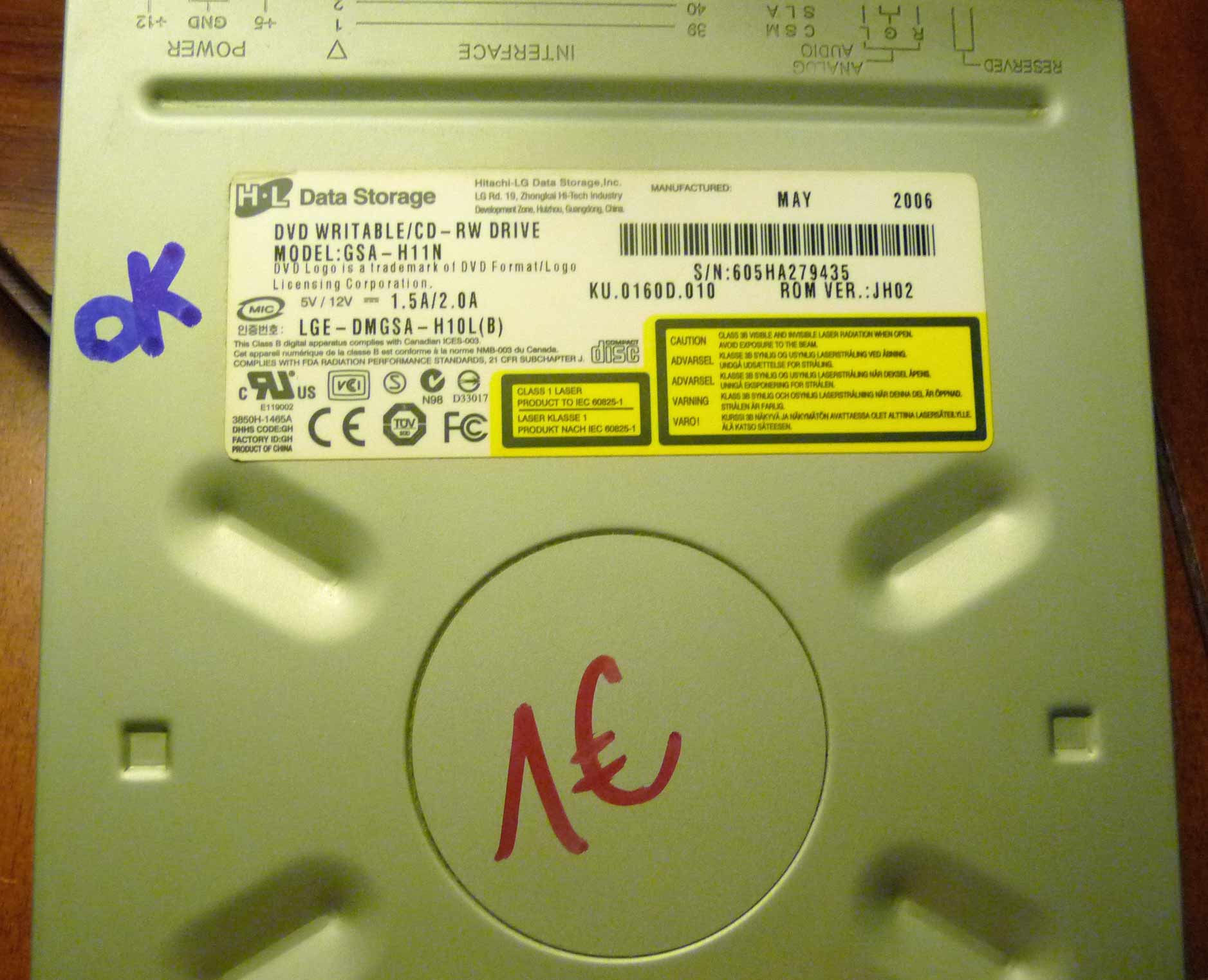

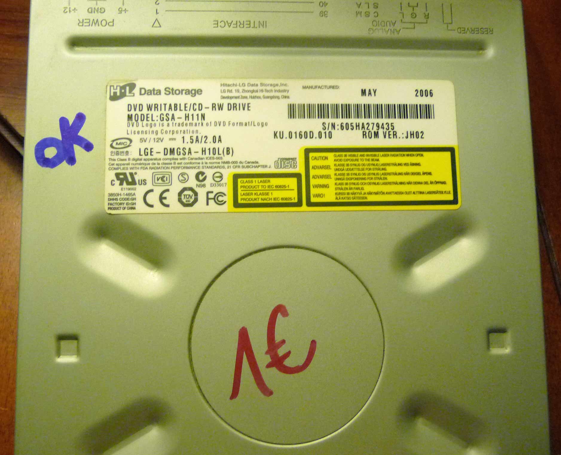

Above: original Maxtor HD was retained. The defective Hitachi-LG optical drive (model GCE-8240B) was replaced by model GCA-H11N.
Interesting view of the eMac's inner components placement (Jonny Ive, I presume?).
And the Covered to Uncovered is like a transformation from Stars Wars into Lost In Space.

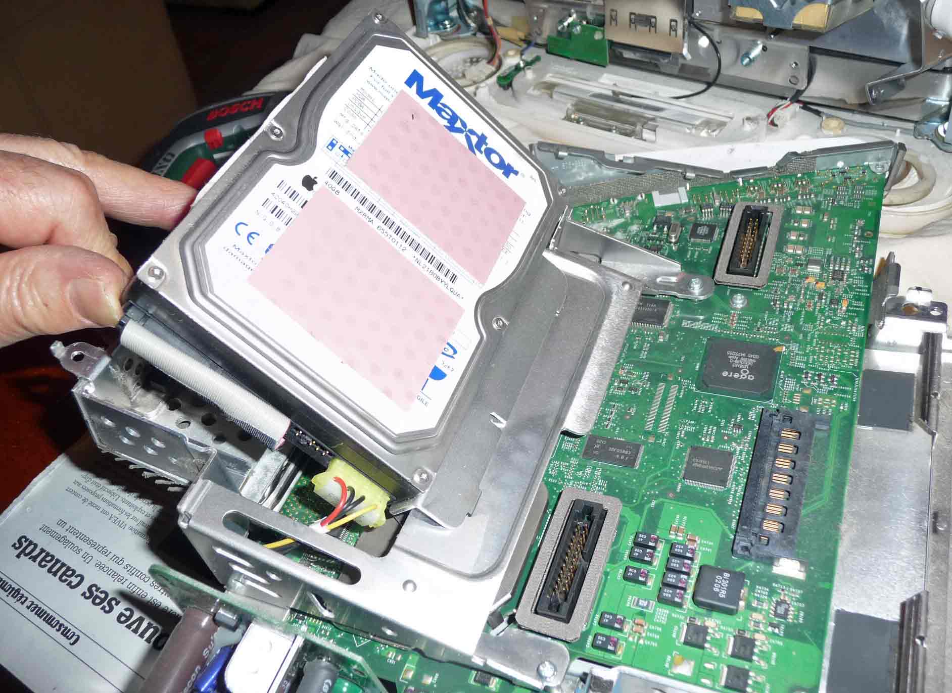

A few months before attacking this eMac, I'd seen a couple of IDE HD's at 1€ each (just over $1), so I bought both. They had been checked out as ok, so I had nothing to loose. (The other is now in an iMac G4).
The next photo carries on from (10) above, and shows the HD removed. Initially I hadn't planned to go any further.

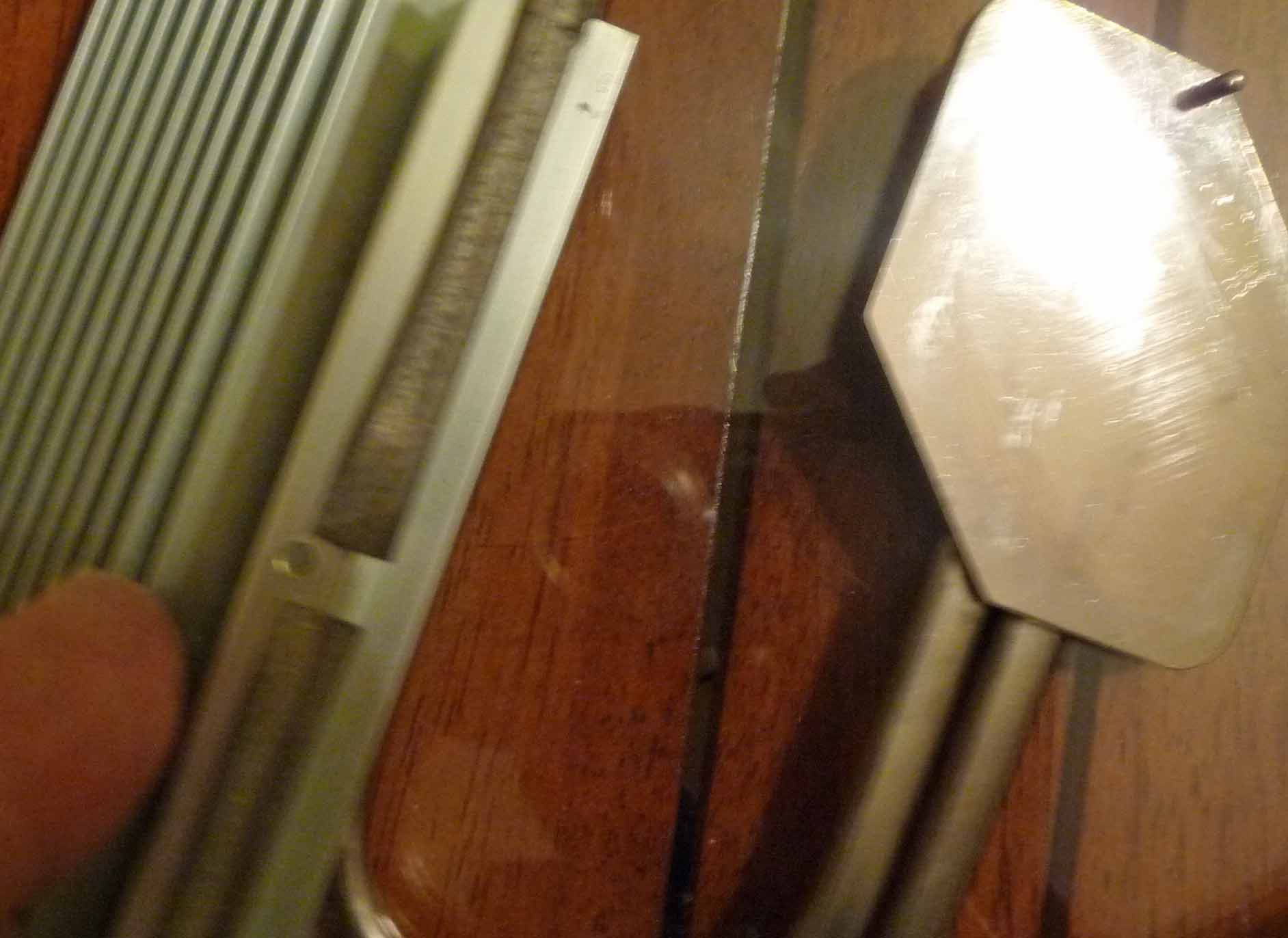

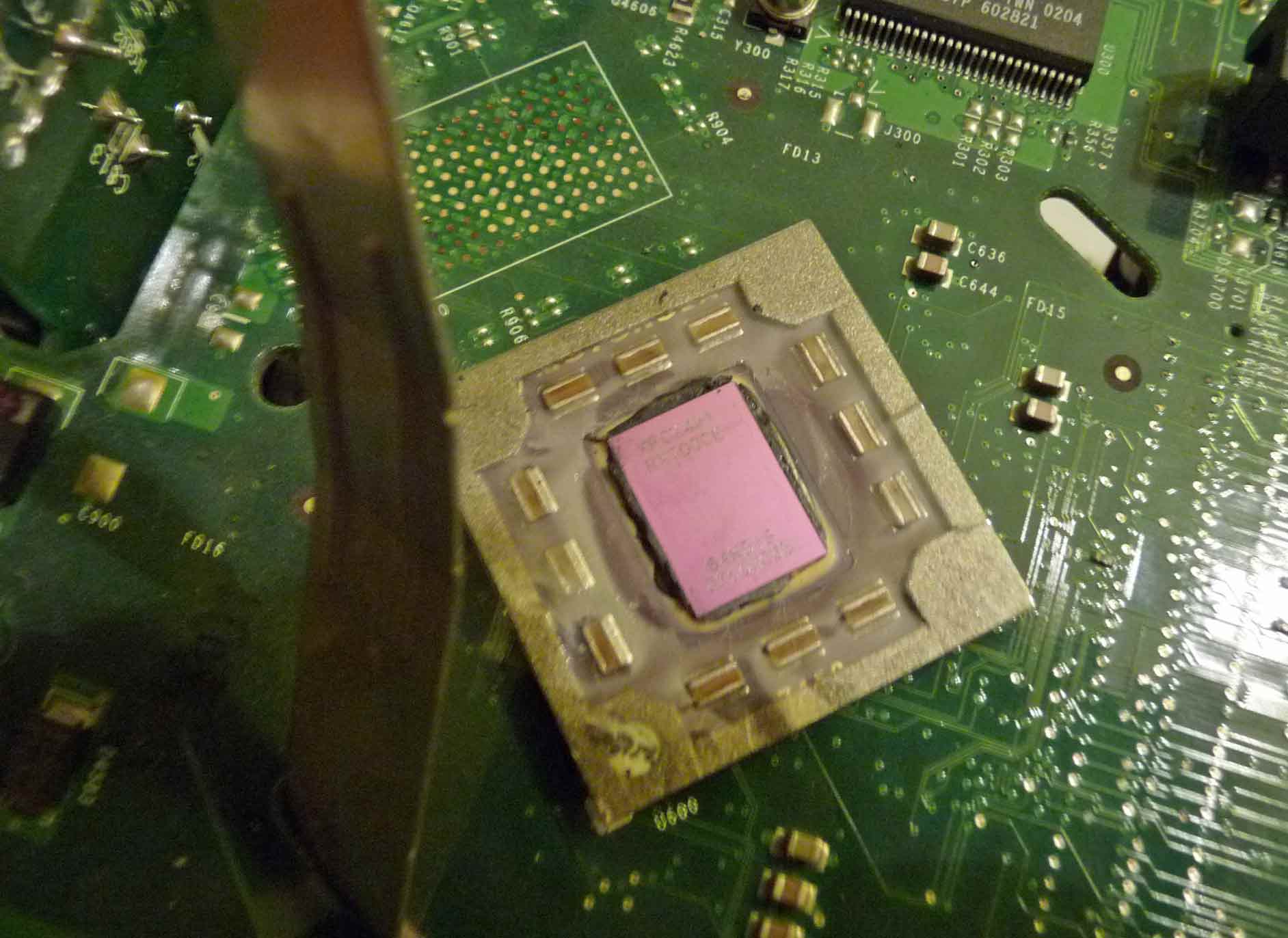

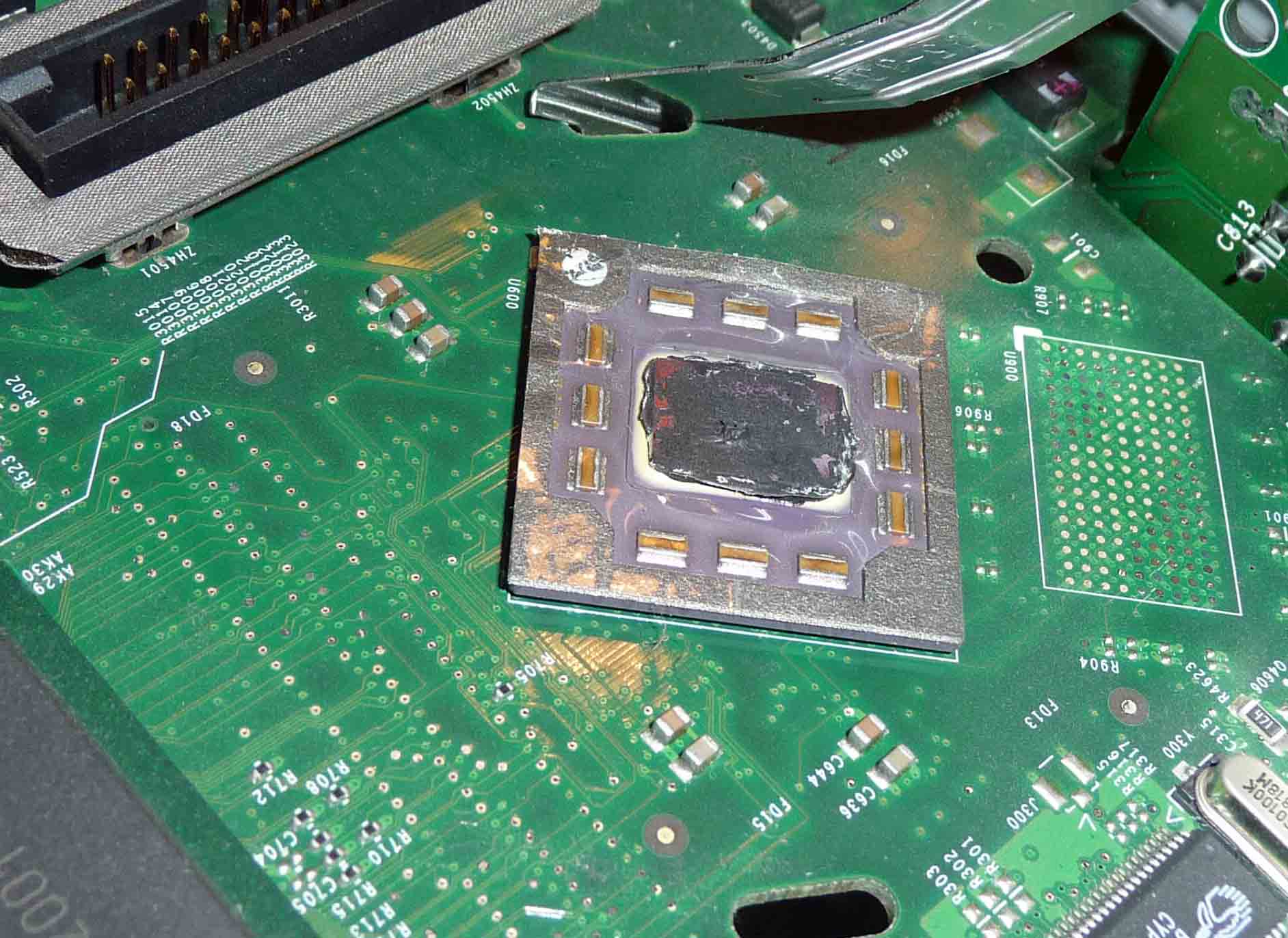

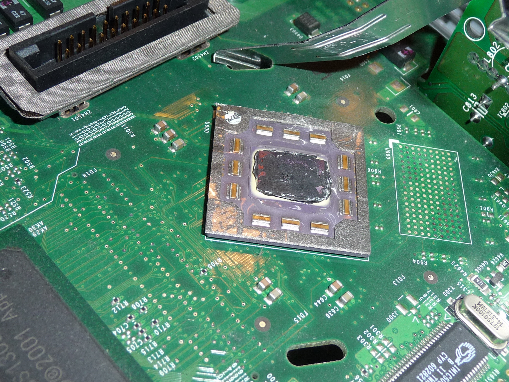

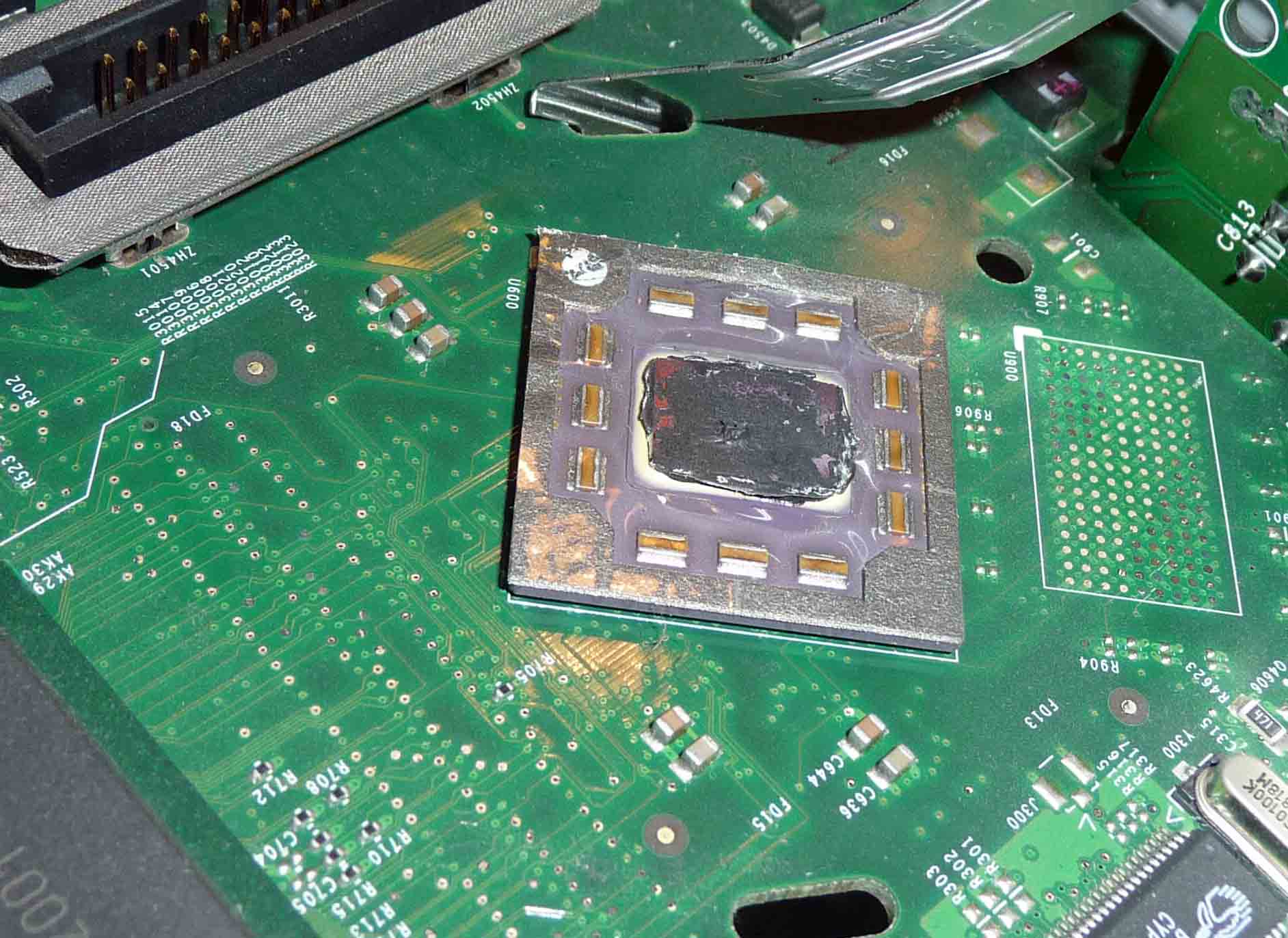

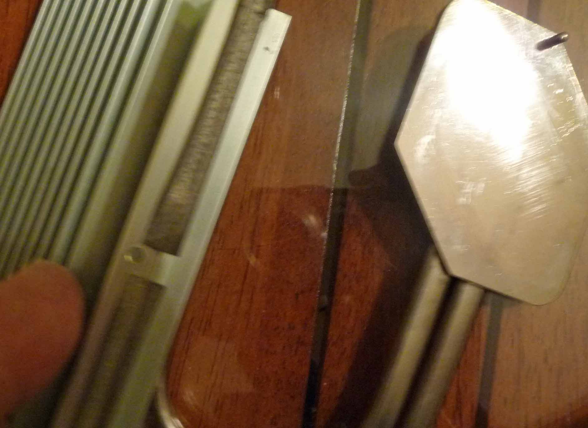

Below - detail of the heat-sink.
And what's below it.......

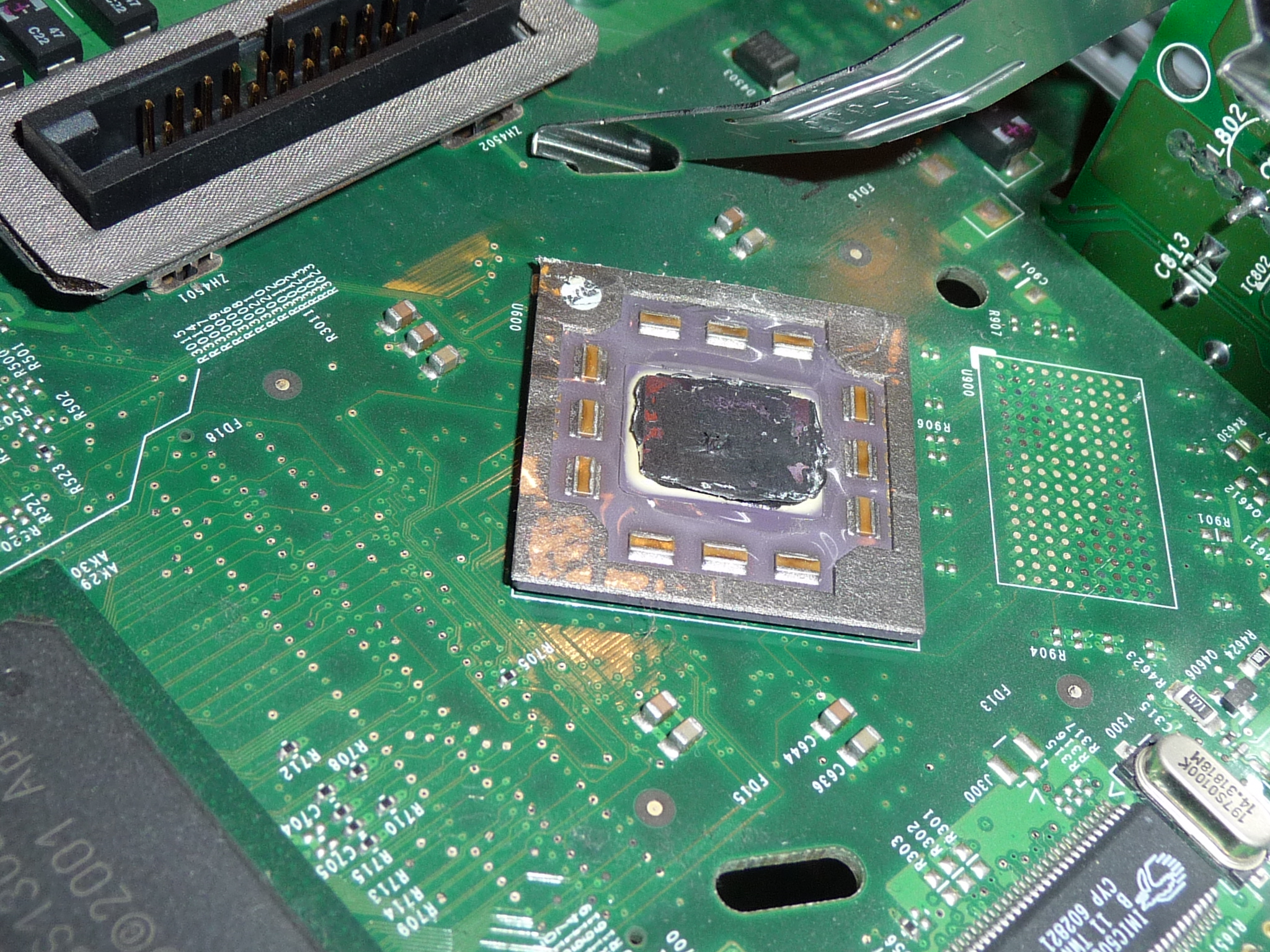

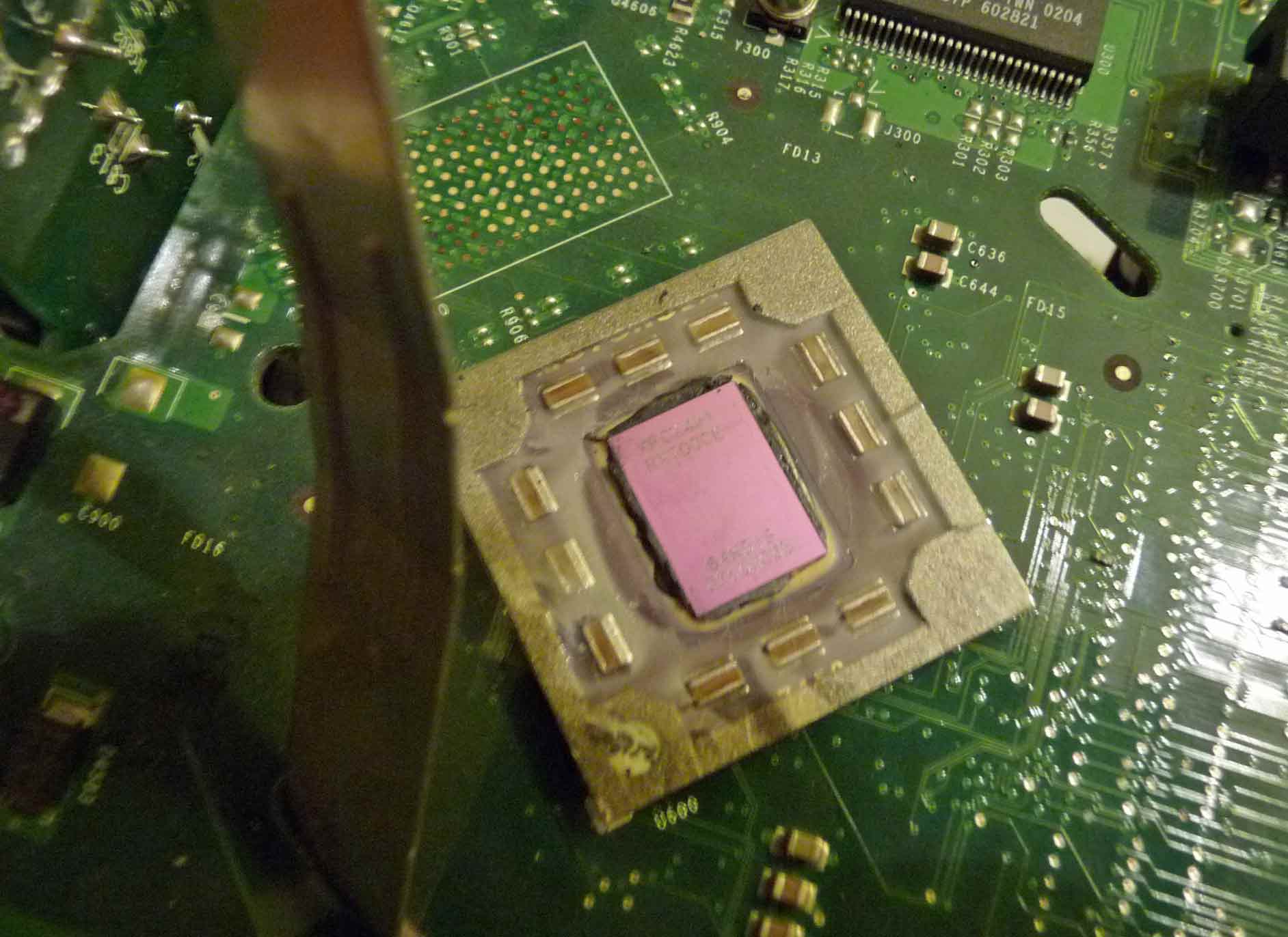

Having gone this far, I thought it had to make sense to rejuvenate this old girl even further with a clean-up and re-paste.
Below - Heat sink and processor cleaned up ready for re-paste.

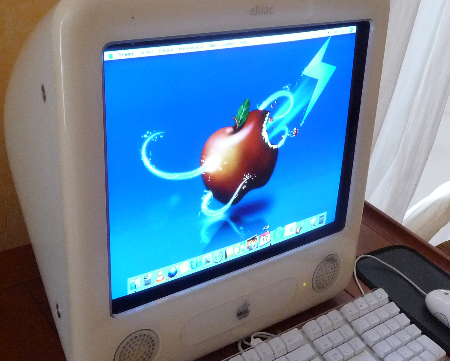

And everything eventually back together, and fired-up:-
With a hundred+ 360P videos installed onto the HD, this eMac makes for an enjoyable media-player.

This photo is great, as it shows the solder pads for a cache chip, thus a potential cache upgrade. @LightBulbFun is specifically interested in that.
If it's of any help to anyone, below is that same photo prior to cropping and in original higher resolution.
