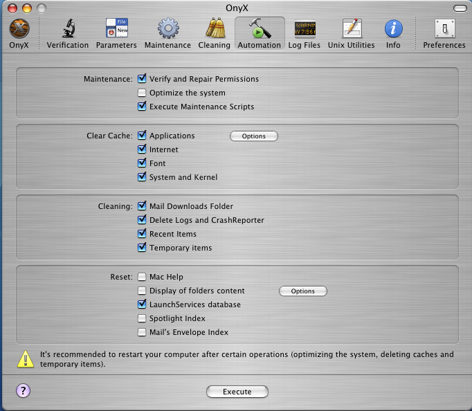

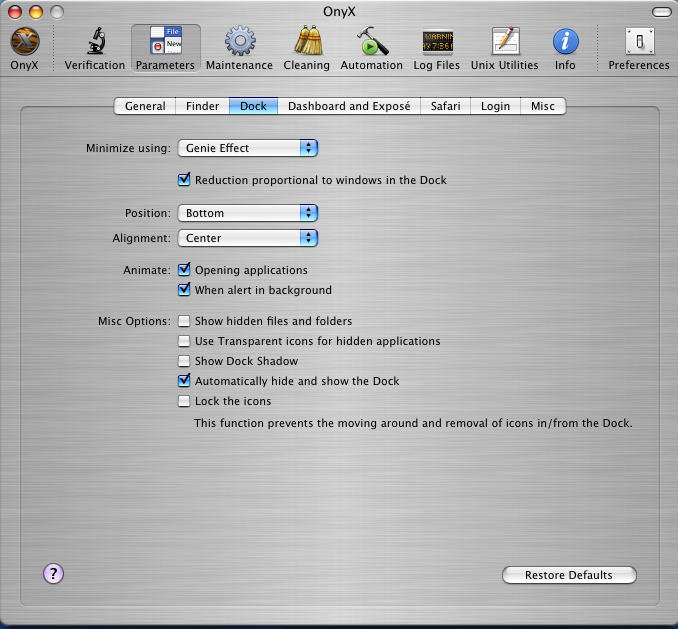

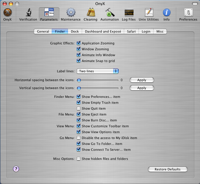

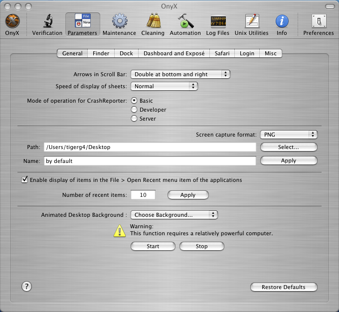

Don't know if anyone here previously suggested a free utility named Onyx.
Onyx presents a user-friendly GUI to change certain parameters of OSX that will
ease processor workload, i.e., animated dock icons, window zooming, etc.
...parameters that I'd probably never notice too much or wouldn't care missing, but
when disabled might make PPC life a bit more snappy.
Edit: Note that these screenies don't show the cpu-wasters disabled.
Onyx can do all kinds of cool things, but system-tech-noobs (like me) need to read the warnings.
Along with adjusting some parameters of slower PPCs,
I run the Automation maintenance choice every once in a while.
http://www.titanium.free.fr/onyx.html
Scroll down the website's list for the OSX Tiger version.
Reactions: 1042686

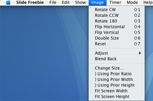

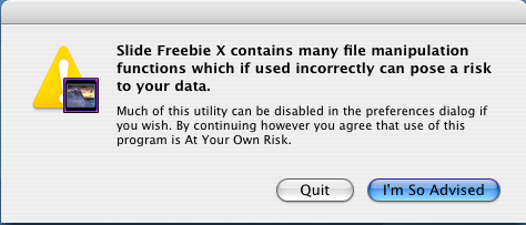

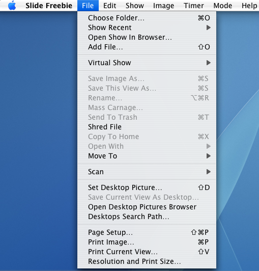

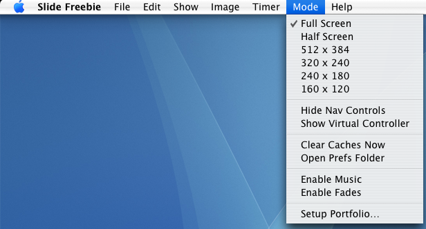

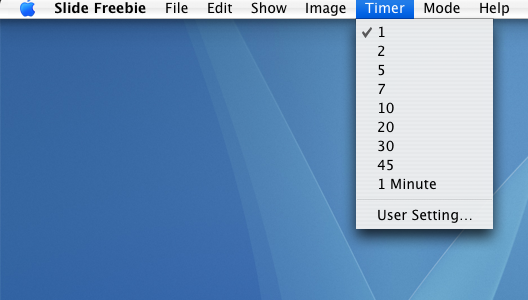

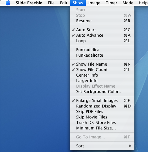

A great fun & free slideshow app is Slide Freebie.
The OSX Beta version is PPC/Intel. I run it on both a Sawtooth/Tiger & a Mac Pro/Snow Leopard.
There's also a PPC Classic version.
Edit: Forgot to post the link:
http://www.artlythere.com/slidefreebie.shtml
With a folder full of images on your hard drive,
Slide Freebie will suck them in as fast as a starving artist wolfing down ramen.
A lot faster than OSX's Preview.
Drag & drop or navigate to.
Images on a CD/DVD won't prep as fast, but it's still pretty decent.
Slide Freebie has more controlling options than Preview.
Preview does have a more superior "Contact Sheet" or thumbs spread than the 12-thumb board
(non-resizable) of Slide Freebie.
On first boot, Slide Freebie warns of data risk - i.e., accidental image shredding/trashing
(such as clicking the wrong icon before reading help or setting preferences)
Slide Freebie's developer also did a free image editor named Compositor.
I haven't used it, but it looks pretty decent here:
http://www.artlythere.com/Compositor.html
