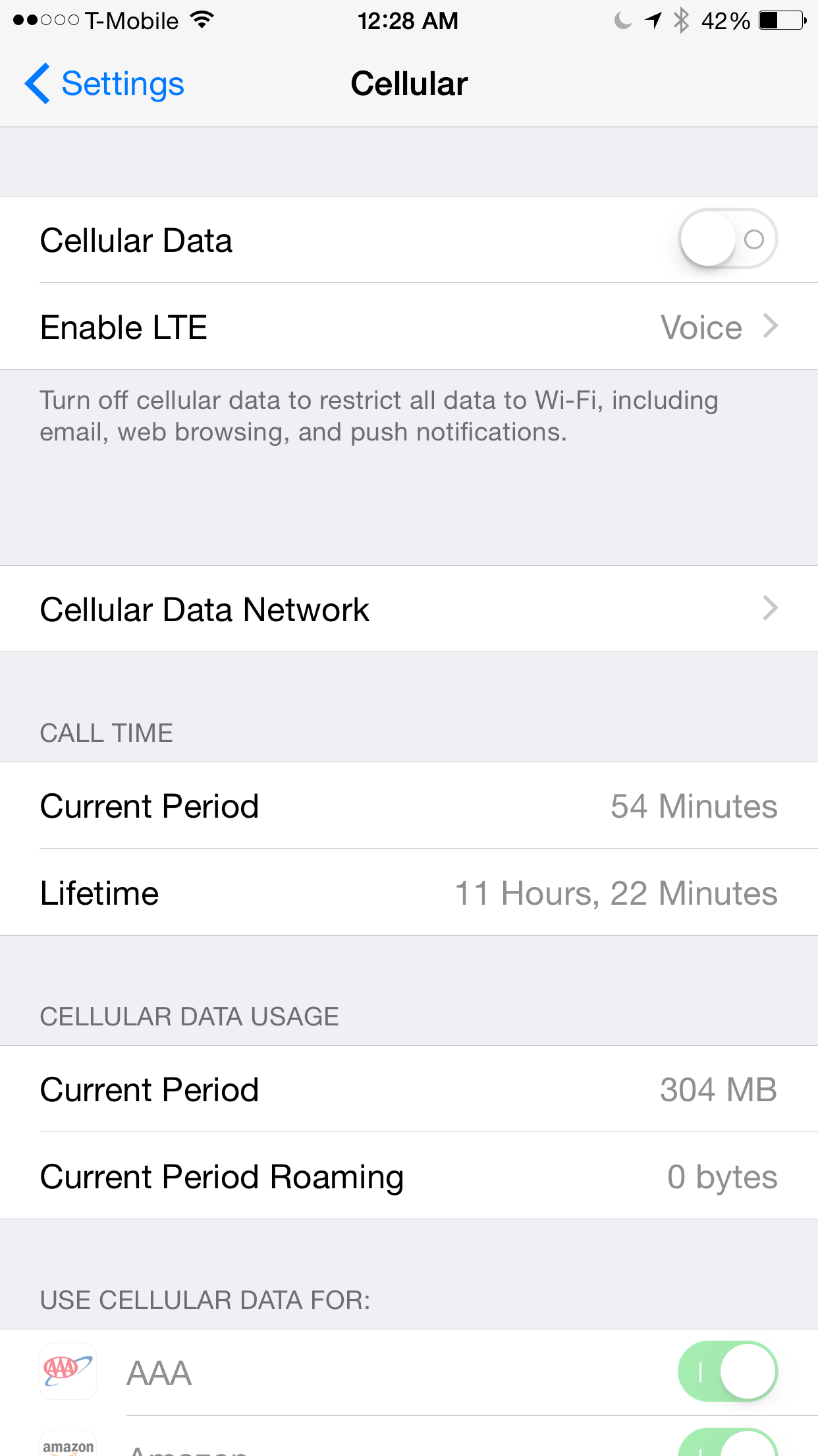

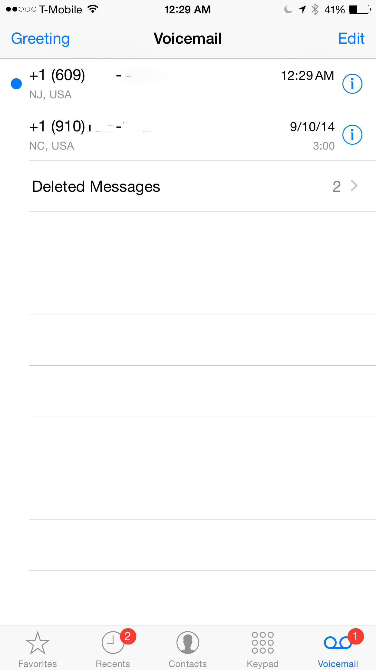

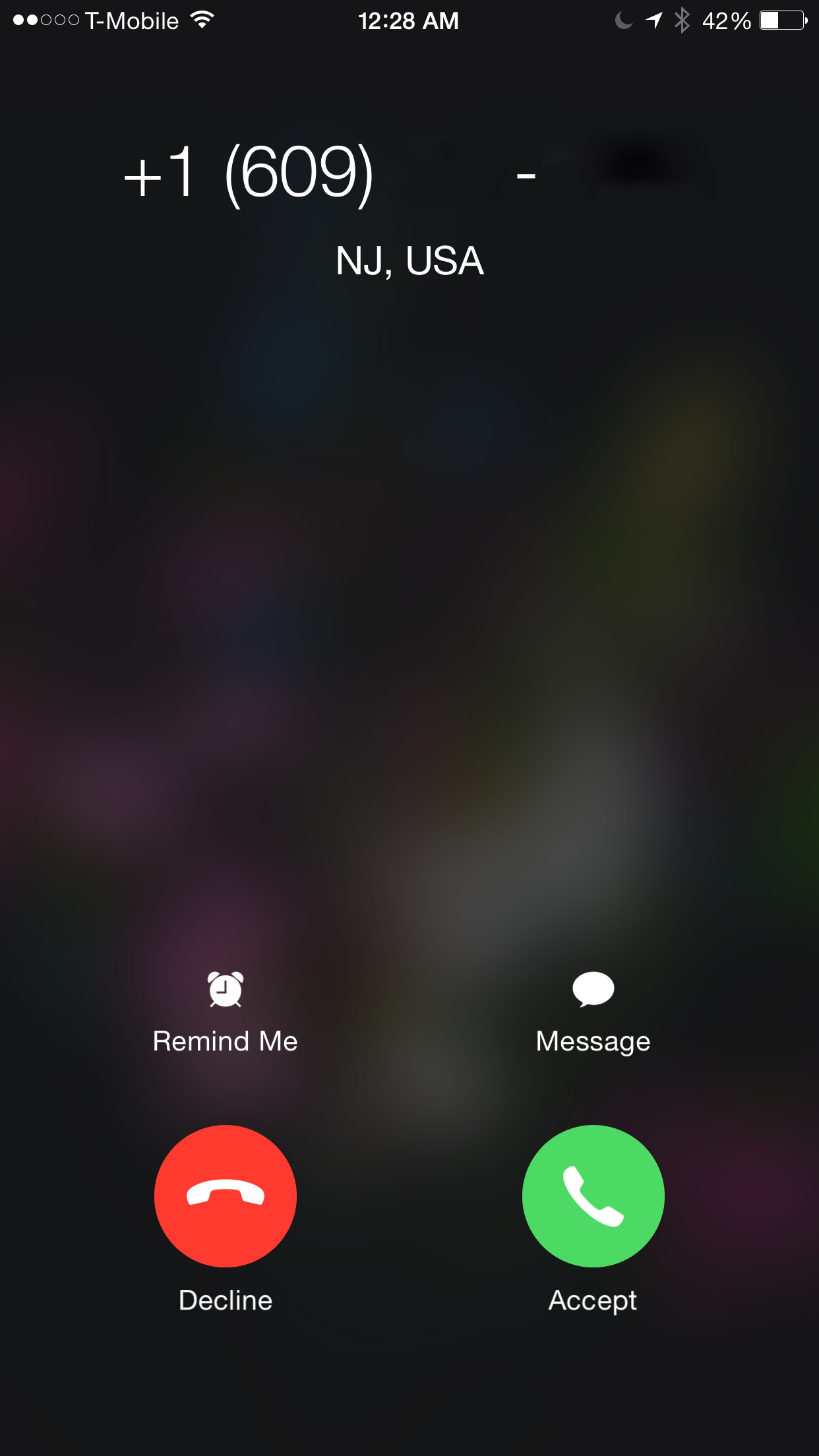

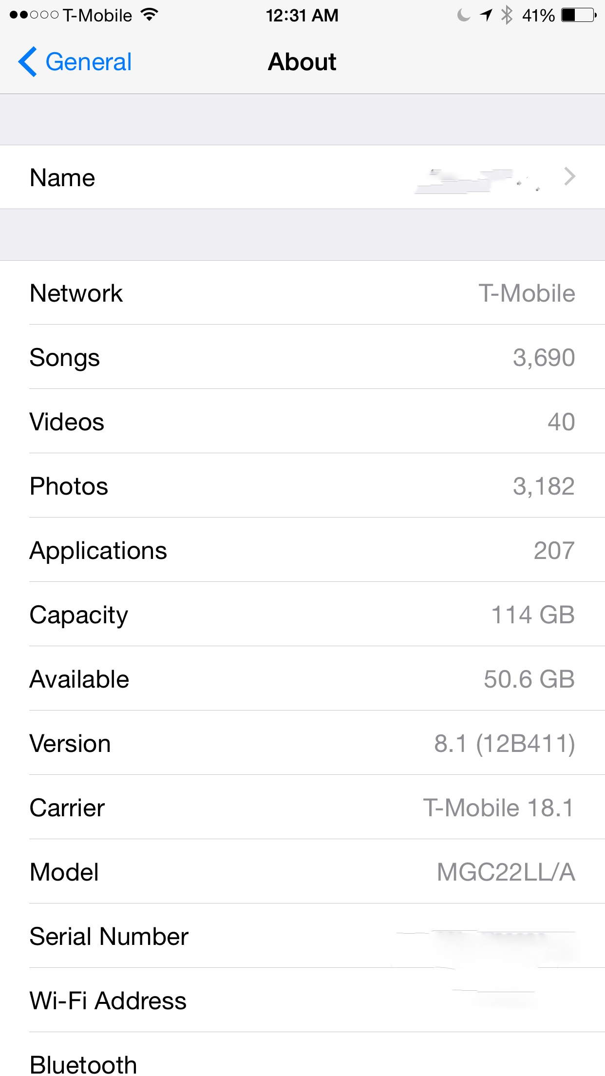

Well, here's something interesting: it turns out on T-Mobile, cellular data is apparently NOT required to receive voicemails. I turned off cellular data, and turned off WiFi calling. Then called myself from another line and left a voicemail. The call went through, rolled to voicemail, and then I received the message anyway, apparently over Wifi data. This is on an iPhone 6+ running iOS 8.1.
This is definitely a break from what most carriers require. I know AT&T requires cellular data, and always has. AFAIK Verizon requires it as well.
So, definitely a carrier issue in your case, I would say.
