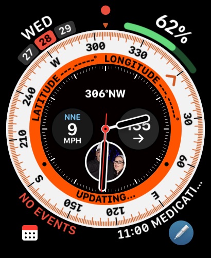

I can use the Dexcom G6 app and it shows actual real time numbers. It’s hard to see here because the hour hand is slightly covering it. It’s at the 3 o’clock position on my Ultra. I have be unable to make the shortcut work to show the Dexcom reading either.

When Series 7 came out, this same bug occurred, but an update allowed users to see real-time numbers in the complication, not the - one shown above. I wondered how the Dexcon G6 app looked and functioned on the Ultra.
Glad to know that it works, for the most part, hopefully, Dexcom releases an update that supports the Ultra and its larger display.

Ok cool!! I now see where I can set this up in the watch face.

yes, there was a thread on here about the S7 and G6, once it works on your Ultra the way it's supposed to you're going to love it even more. Once Dexcom released an update, the larger display of the S7 showed off the G6 complication and made it easier to see and more reliable. I'm looking forward to pictures, thoughts, etc. using it on the Ultra.

Does the Ultra turn the complication blue with a - ? Mine is white.

I’m not exactly sure what you‘re asking here, but sometimes the complication goes to 2 dashes and I gave to select is to get the graph and it starts reading again.
my bad, I see it. How is it compared to the previous with displaying easily readable information and complications?
compared to the display of a S7, is it noticeably larger in terms of complications and blood sugar readings (easier to read, going from Series 4 to Series 7 for me).
