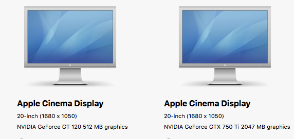

Well I took a shot and read up on flashing graphic cards using nvflash and a rom I found online....the result is I am now using my cinema displays! The DVI ports work fine under OSX but oddly I think the VGA doesn't. When booted into my Windows 10 drive the top DVI functions and the VGA also but the other DVI is not completely functional without some unplugging of other monitors. Well I got what I wanted and still have my GT 120 installed for a boot screen.
Glad to see its mostly working now 🙂 if @Razzerman Has a card with the same port layout as your card but works perfectly in OS X i would contact him to dump the ROM of his card and flash that to your card. or browse around techpowerups impressive collection of GPU ROMs find one that matches your cards port layout
