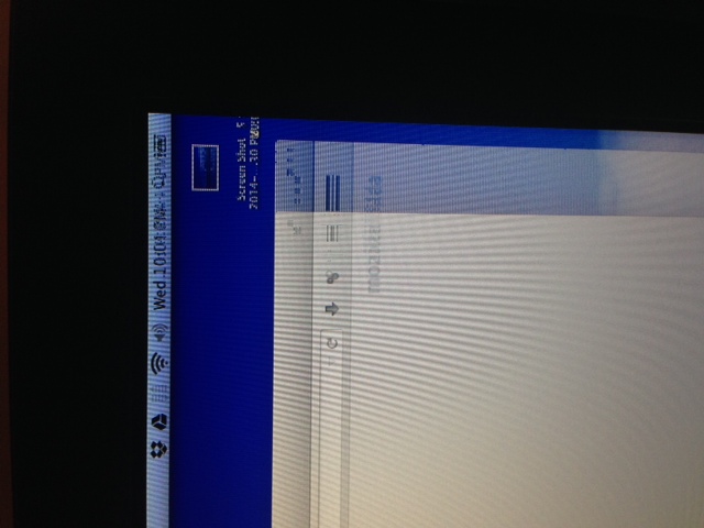

Hey Tommyleeh. Just tried out the PB287Q on my Mac Pro (running D700s). Changed Displayport to 1.2 as suggested, but for some reason it only runs at 56Hz. Also, screen tearing is present on the right edge... so you're saying all you did was change the Displayport setting? Thanks!
Yes, that's all i did. I have a lower-end macpro (D300s).
I just plugged it in, noticed things looked fine, but choppy, noticed it was in Displayport 1.1 at 30hz, so changed it to 1.2.. and all was good. Didn't do anything else.
Mine says its running at 60hz.
Screen tearing ASUSPB287Q/Mac Pro D700
I'm having the same screen tearing problem on the ASUS PB287Q with the upper end D700 graphics cards in the Mac Pro. It appears that Display Port 1,2 only works properly when the display is set to its native resolution at 3840x2160. Changing that will immediately cause the tearing. Of course, you could always set the monitor to Display Port 1,1 but that shifts the monitor to 30hz refresh which causes noticeable lag. The monitor works just fine on my Retina Macbook Pro on the Display Port 1,2 settings so it must be a driver issue with the upper end D700s, since the lower end D500s appear not to have this problem.
