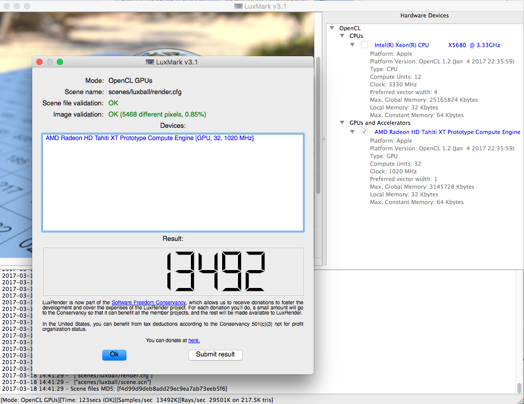

After deleting the .kexts I am seeing no real improvement.
Before is on the left while after is on the right. I have no flashed or modified my card yet.

NovaBench is hopeless, it's totally outdated and unable to benchmark the GPU at all. Anyway, the Luxmark score looks rational, the 280X should be good to go.
Reactions: owbp and Fl0r!an
Luxmark looks great, without the removal of those two kexts it would be in 6-7000 range.

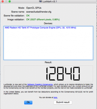

Here is my results:
Looks like the old Mac Pro was not really limiting my graphics cards performance.
