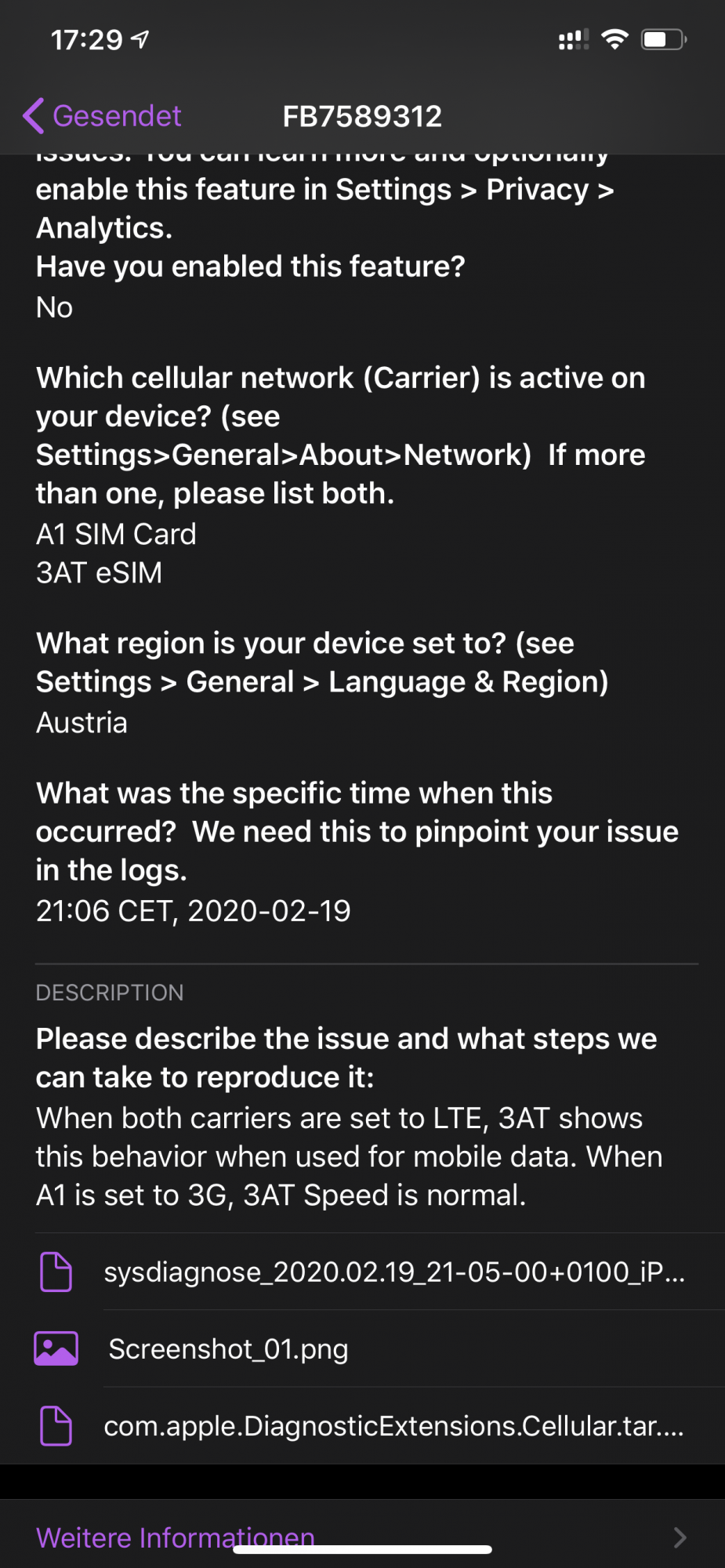

Try setting the SIM to 3G and try once more please. If that also brings back your eSIM speeds to normal then your‘re having the same issue as I have. I‘ve already reported it 3 times with the feedback assistant but so far Apple seems to ignore me....
They must have effed something up with the modem firmware when both lines are set to LTE
Not exactly what I expect from a 1400€ phone (also an 11 Pro Max)
