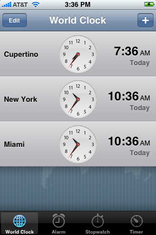

I believe the network in Northern Lower Michigan is having a few problems. The time my iPhone gives me is correct (the one at the top) but if I go into the clock app it displays new york (which is the same time zone, eastern) at 10:36AM when the time is actually 3:41PM. My girlfriends phone (which is not a iPhone) does the same thing. Also, the "Whats On?" app is not displaying correctly. Anyone else having this problem?

Just a thought, looking at the pic above

It's actually five hours out according to him. Perhaps time provide by the location service of the wifi router overrides AT&T location service, but I highly doubt that.
Okay this is interesting... I took my SIM out, turned off WiFi so i didn't have any signal. I changed the time to my own time, then turned on set automatically and it worked.
Ok I take that back, perhaps it was set base on location of the wifi router. OP, check the timezone you set for your router.
