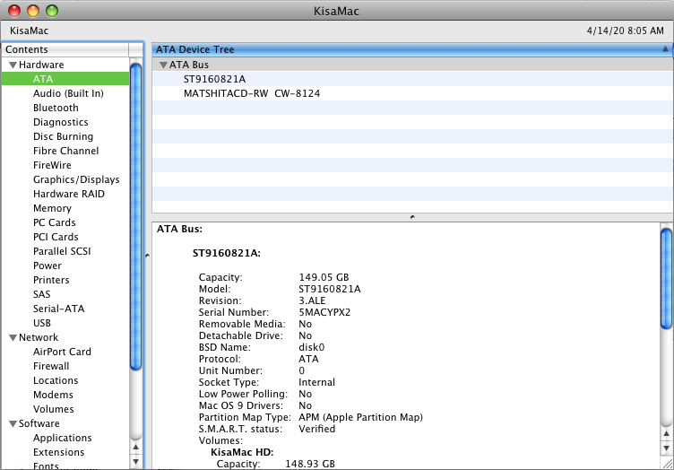

@andloph A good way to see if you have one or two ATA buses is to go into the System Profiler and look under ATA. It should list two like here on my Power Mac:
As opposed to what it looks like on my Mac Mini:
