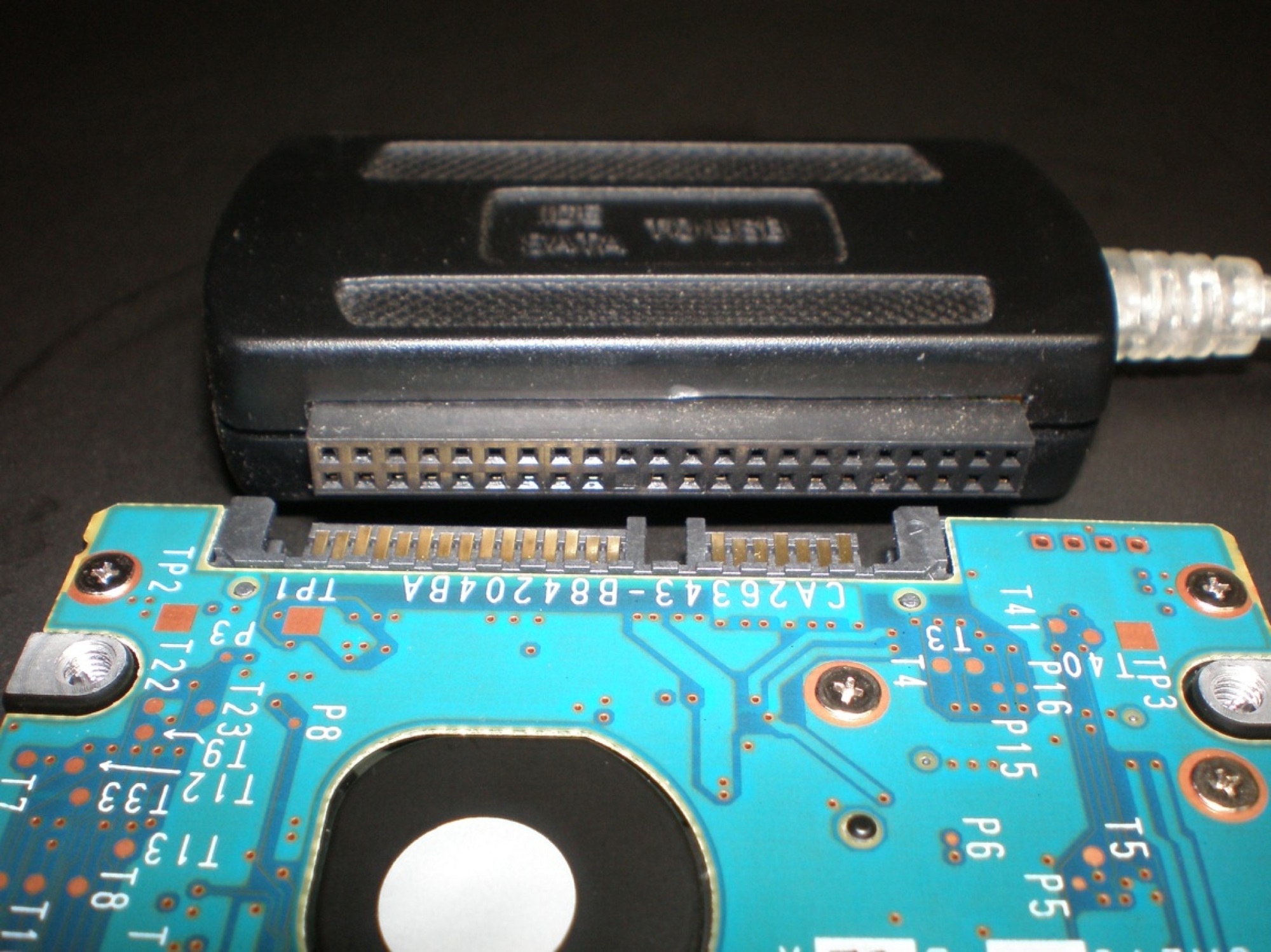

When I got it, I tried to hook it up... and of course it doesn't fit (you can see on the attached pic). Quoted from the OWC site where I bought it: "Compatible with any 2.5" IDE device!" Well, my HD is a 2.5" ATA and what do you know, not compatible.
Did I buy the wrong thing? If so, what should I be buying?

I tried to hook it up... and of course it doesn't fit (you can see on the attached pic). Well, my HD is a 2.5" ATA and what do you know, not compatible. Did I buy the wrong thing? If so, what should I be buying?
No, you haven't bought the wrong thing (I have one almost identical).
From the photos, esp Pic 2, unless I'm seeing things, you're trying to use the SATA side of the adaptor. On Pic 2 you can see the lettering SATA, whereas on the other side of the adaptor is IDE - which is ATA. Confusing to the uninitiated, but ATA=IDE. Try that and see how you get on.

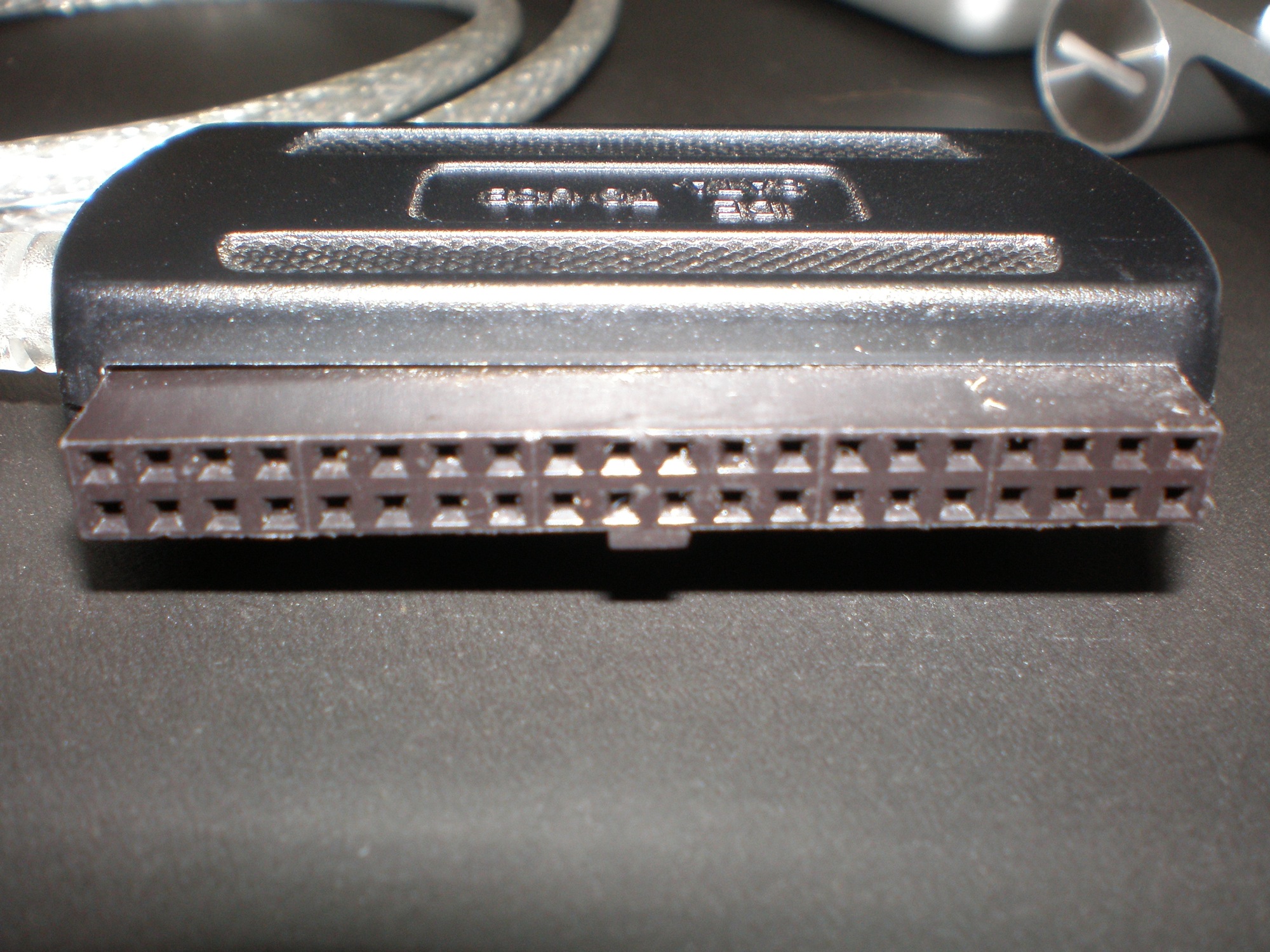

The other side also has the pins but is just longer and has larger pins. Heres a screenshot (other side of the pic I posted above).

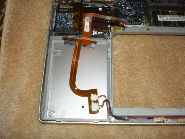

Luckily, when I replaced my internal, I took some pics. It looks like the drive connector inside my MBP is different than both sides of the adapter I bought. Do you have any idea what it is?

Re the second of the extra pics you've posted, is that the original connector from inside the MBP (ie. not the adaptor)? I note it has 40 open sockets, whereas there are only 39 pins on ATA connections, but that shouldn't make any difference. I can't determine from the other additional pic what the pin array of the connector is.
The ATA connector, be it original or adaptor, can only fit one way on to the pins at the rear of the drive. That is determined by the positioning lug, which helps avoid bending pins when pushing on the connector.

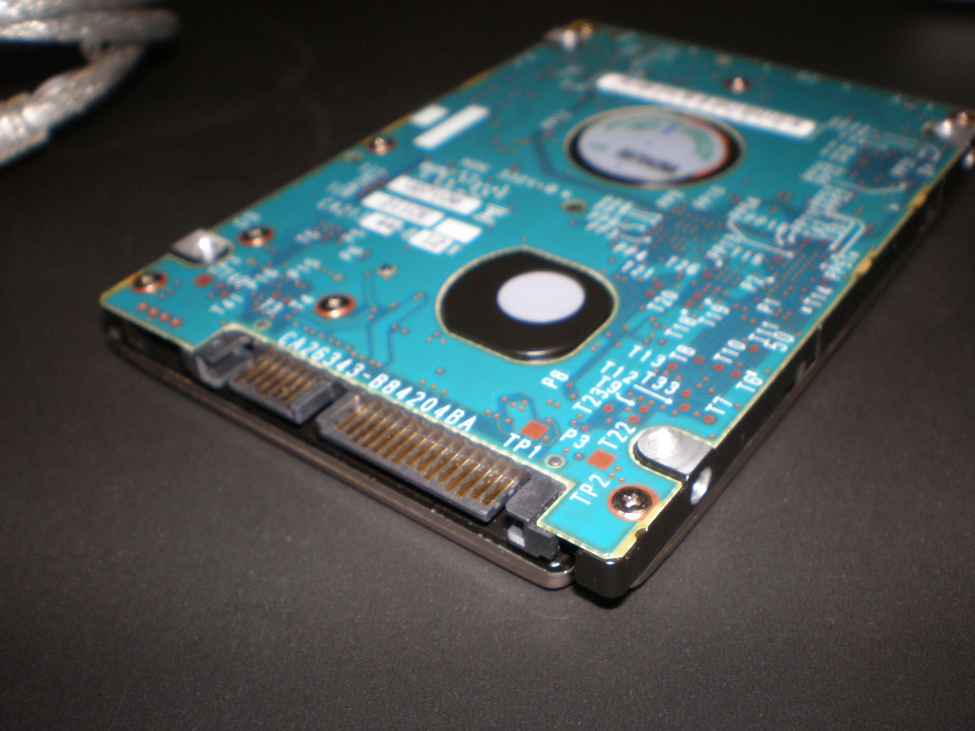

Your drive is SATA, not IDE (PATA).

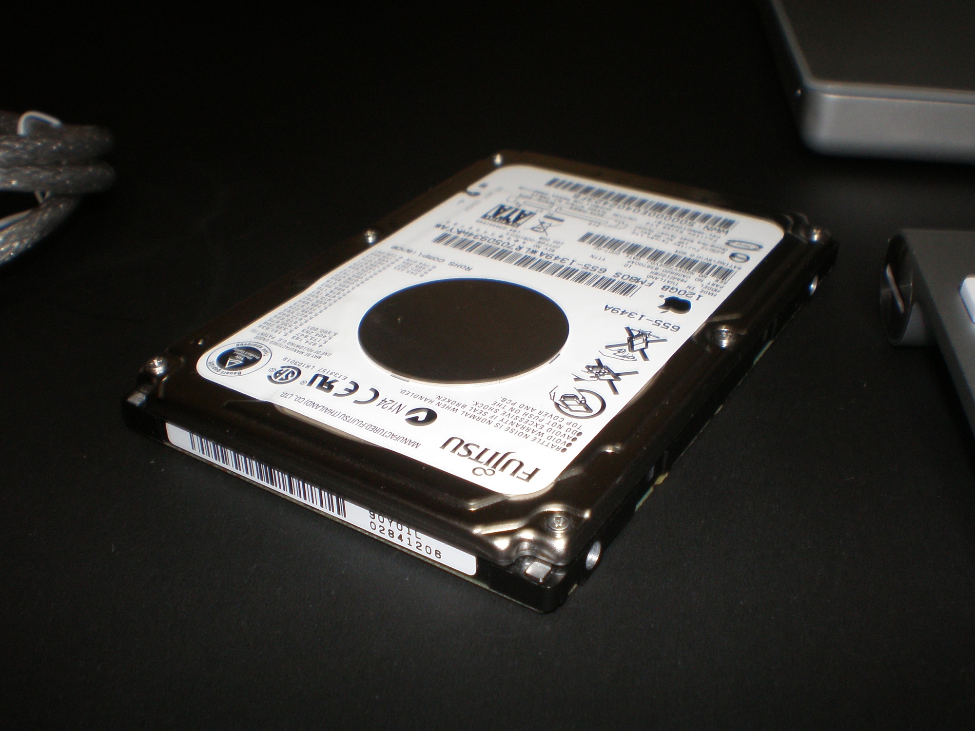

Not according to the label on the very first picture. Could the OP repost that pic with the drive positioned for easier reading of the details.
Even if the drive is SATA, the adaptor the OP has bought should fit. The adaptor is double-sided. Are there some bent pins on the drive?
It is clearly a SATA drive by the photos. In addition "my old MacBook Pro hard drive" also means it's a SATA drive. Intel Macs have only shipped with SATA drives because the Intel (and now nVidia) chipsets had SATA controllers.
Did you look at the link he provided? One side is 40-pin (3.5" PATA drives) and the other is 44-pin (2.5" PATA drives).
