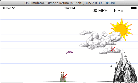

I am having an issue with the computer firing back a cannon ball. It keeps hitting the hill. In the photo the 2 red "X"'s are located at the cannon ball start, or the object.frame.origin.x and y. I wanted to make sure my 2 points were correct. You can also see the cannon ball striking the frame of the hill.
When I researched this it was the slope, or RISE over RUN. I built a method to convert the slope to degrees. In the RISE it was normally Y2 - Y1 but since Apple screen coordinates start at the top and work down they were reserved, so I flipped them to Y1- Y2. Other wise it was shooting backwards of something.

The Objects values at the time of the calculations are "Red X's"
Cannon Ball start = x321 - y 292.
Hill is x518 - y180
rise totals = 112
run total = 197
Which gives me a degree value of 29.619 before converting to Radians which is .516956
I can see with my own eyes that 29 degrees is lower then it should be. It looks closer to 45 give or take.
Any help would he appreciated.

I got the same result as you with those figures.
If I put my protractor up on my monitor, the angle between the origin of the cannon (which isn't where your red mark is, btw, unless you have a much smaller view and aren't clipping) and the origin of the hill is about 29 degrees.
tan is opp/adj which is 112/197 = 0.5685. So tan^-1 = 29 degrees
45 degrees would take it into the sun.
(The origin is at the top left of the view.)

Ya, its frustrating and this is the 3rd day I have been looking at the math. If you are also coming up with 29 degrees then the math must be right. To test it I turned off the gravity and wind speed so it shoots in a straight line
