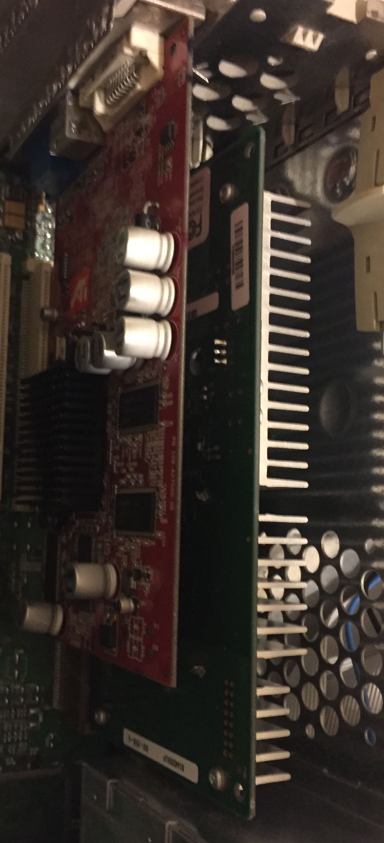

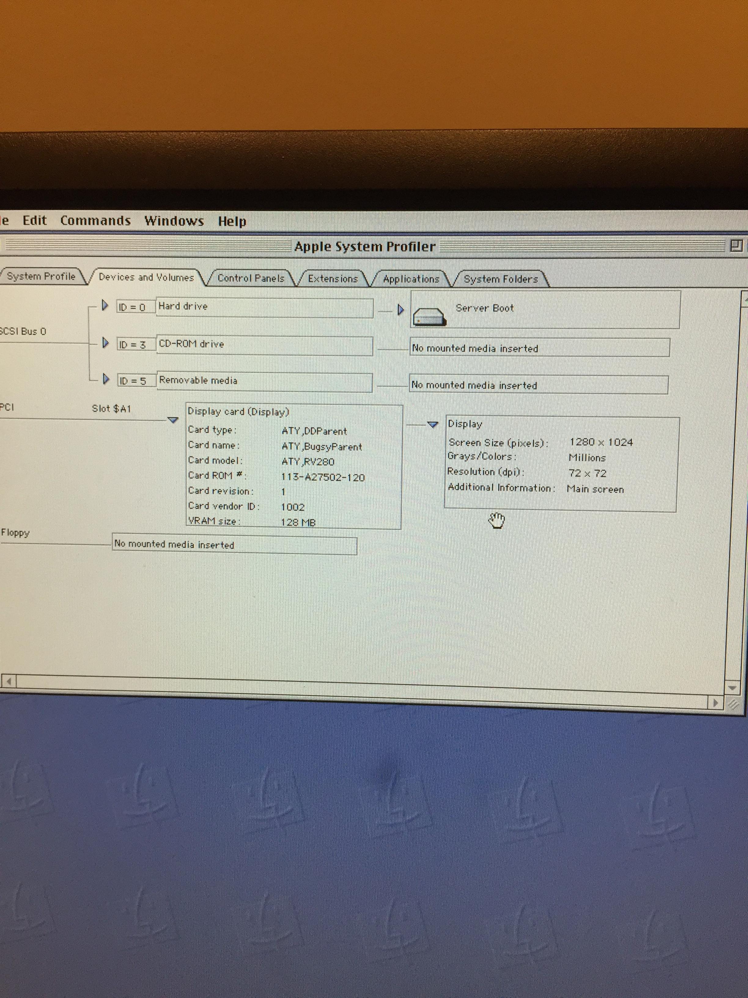

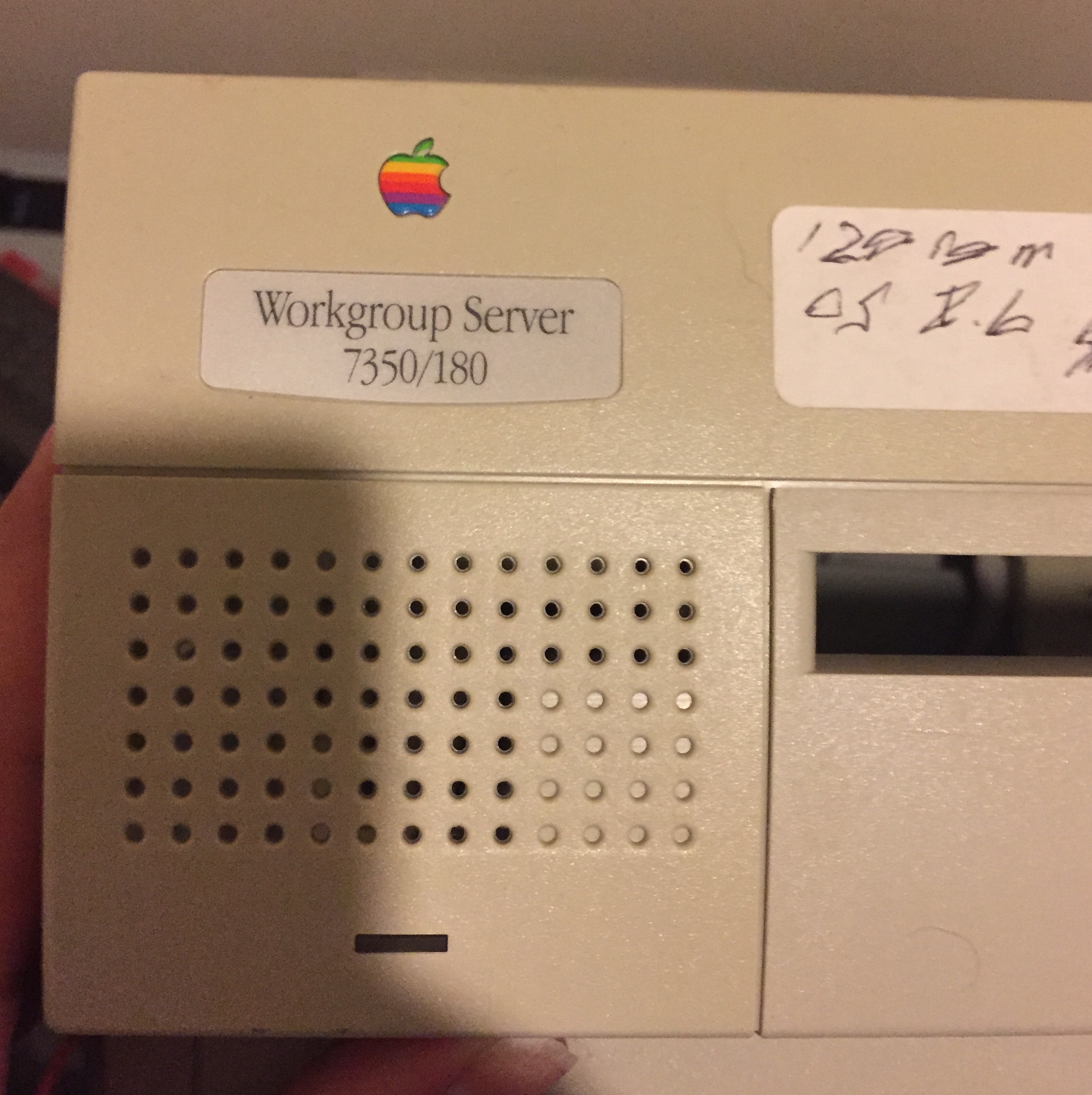

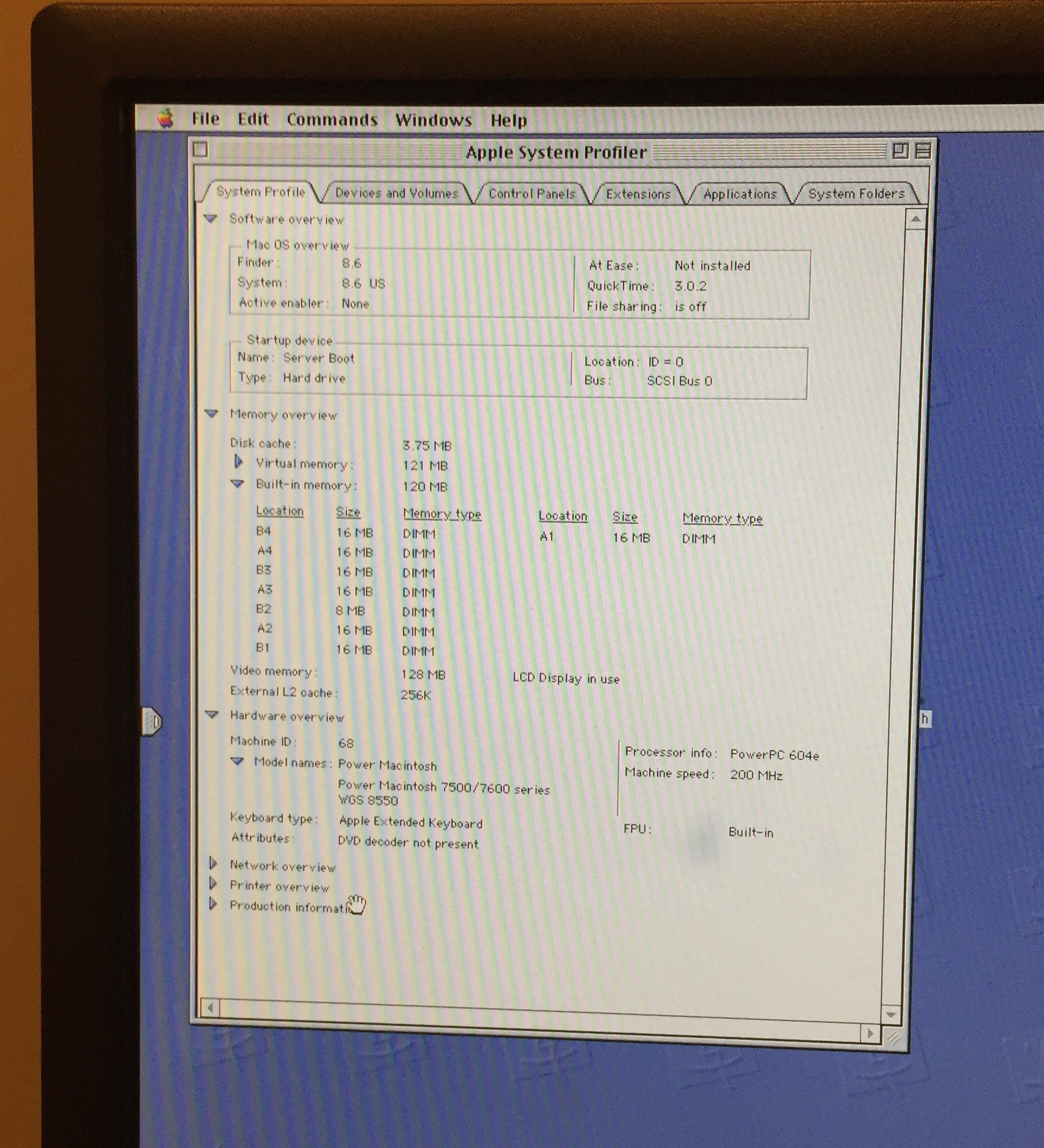

Stand by-I'll check this evening in a pre-G3 Mac.
As promised-7350 WGS(604E based) with a Mac Edition 9200 installed.
Thanks man, that's great to know! 🙂

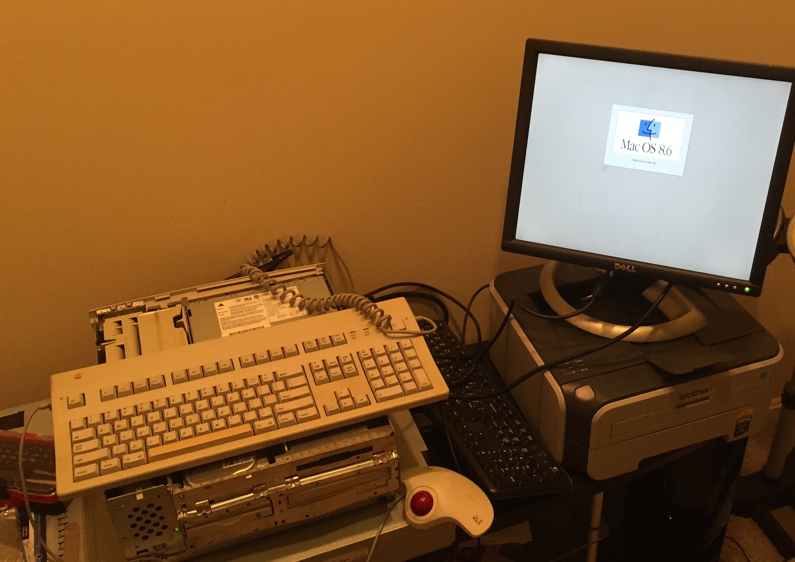

You'd also probably be interested to know that I've had that 7350 sitting in that exact place since March 17th(when I drove up into southern Indiana to buy it and a couple of other computers), and hadn't even powered it up.
I figured this was the best way to test the 9200, since my 8600 no longer has a 604E, my 8500 is too much of pain to take apart, and my 9600 is away at my parents' house.
So, it gave me a chance to answer your question and boot up a computer that I've been meaning to boot for a month and a half now. BTW, the 8600 has an interesting startup chime. It sounds like my Quadra 700.
Now I just need to get along with my Leopard on the 8600 project...
