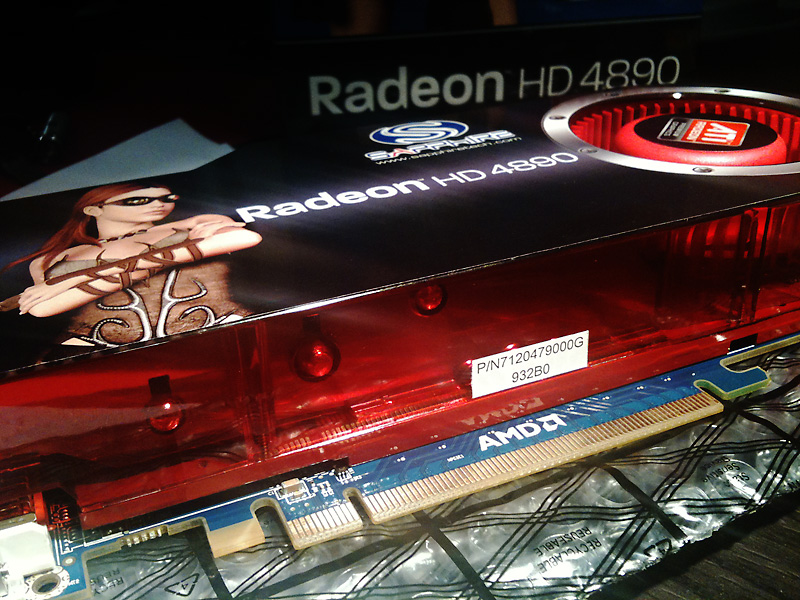

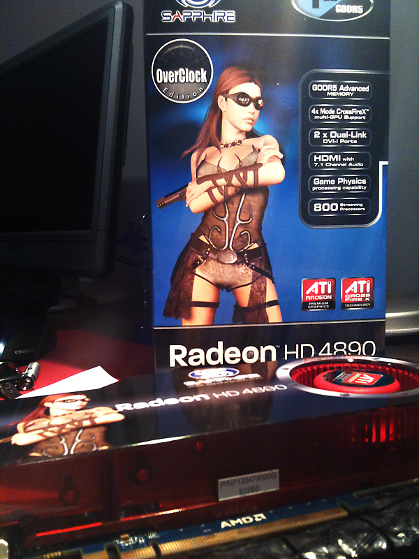

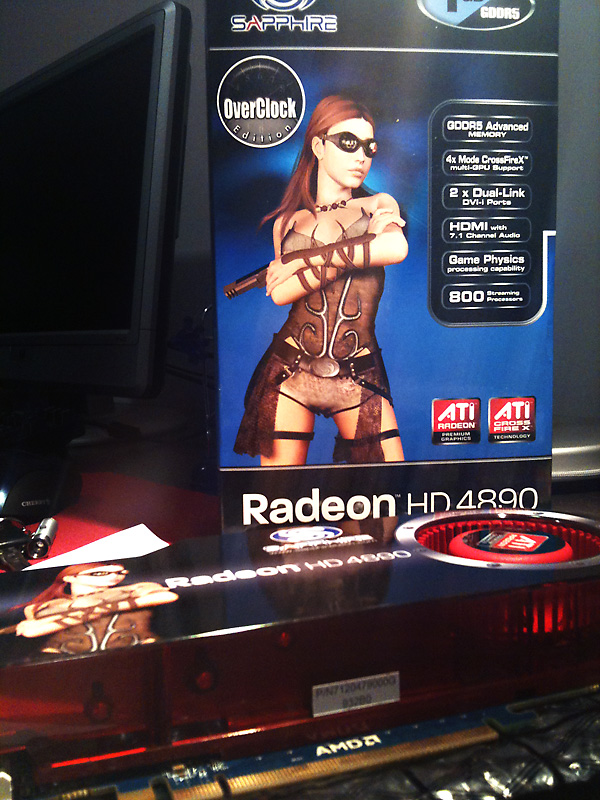

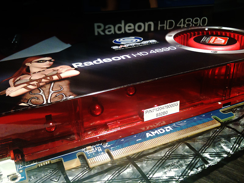

Hi,
I´m newbie. I have a mac pro 2x2.8 Quad-Core with 10.5.8 os X and 8800 GT. I´d like to put Ati 4890 and buyed this Sapphire (Overclock edition) to flash it. This is a valid/compatible graphic card or not ?
I have only a few days for return this.
Sorry again for my english.
Thanks a lot

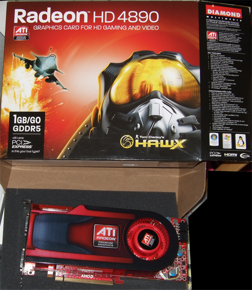

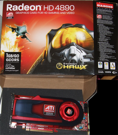

I posted in the Ultimate 4890 thread, but figured I'd leave a note here as well. I managed to get a Diamond 4890 (model A4890PE51G) working in my Mac Pro (1,1). I've seen one report about it not working, but everything went smoothly for me. The card appears to be a stock ATI reference board. I flashed the card with the HIS image from Cindori's rom collection using my Windows XP bootcamp parition. My understanding is that the HIS rom is from a reference board as well, so I am not anticipating any problems. If someone would like to make a mac modified version of the Diamond rom that I saved a copy of, let me know. Photo of the card/box:
