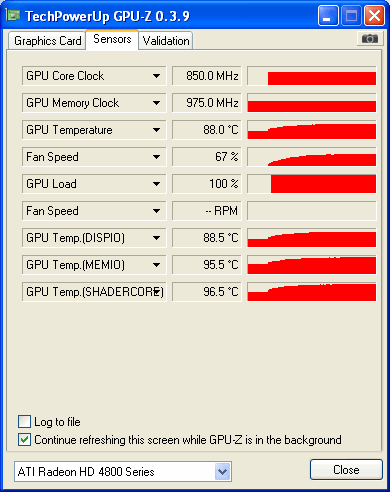

Also, I think the modded ROM I've used may have the fan control settings a bit on the low side. I did some benchmark OpenGL testing in Windows while observing the results in GPU-Z. I've posted here. Do these temps seem out of line? Look high to me, but then I've never used such a power hungry card before.

Getting back to the point about temperatures, could that be an issue? My experience is that video cards can be goofy if overheated, and this flicker strikes me as possibly that. Thoughts?
Edit: first impression was wrong, the larger monitor flickers all the time no matter what is displayed whenever two monitors are connected. Seems to be the only issue, but it's sure a big one.
