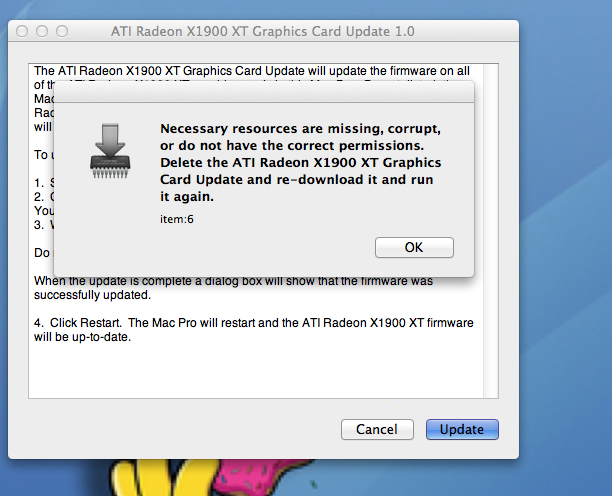

I have been trying to update the firmware for my graphics card for ages and keep getting the same error. (see attachment).
I have re-downloaded the file from several places and get the same result. Sometimes I get another error message about invalid file names. Anyone any ideas?
I have a Mac pro
Processor 2 x 2.66 GHz Dual-Core Intel Xeon
Memory 8 GB 667 MHz DDR2 FB-DIMM
Graphics ATI Radeon X1900 XT 512 MB
Software Mac OS X Lion 10.7.5 (11G63)

Judging from the image on the original post, the firmware flashing utility is having difficulty locating resources or permissions are not correct. It doesn't say the card is about to fail.
The X1900 updater is designed to run in either 10.5 or 10.6, I don't recall exactly.
My guess is if he wants it to have a chance at running, he would need a working install of whichever OS it was issued with.
(would be on the info page at Apple)
