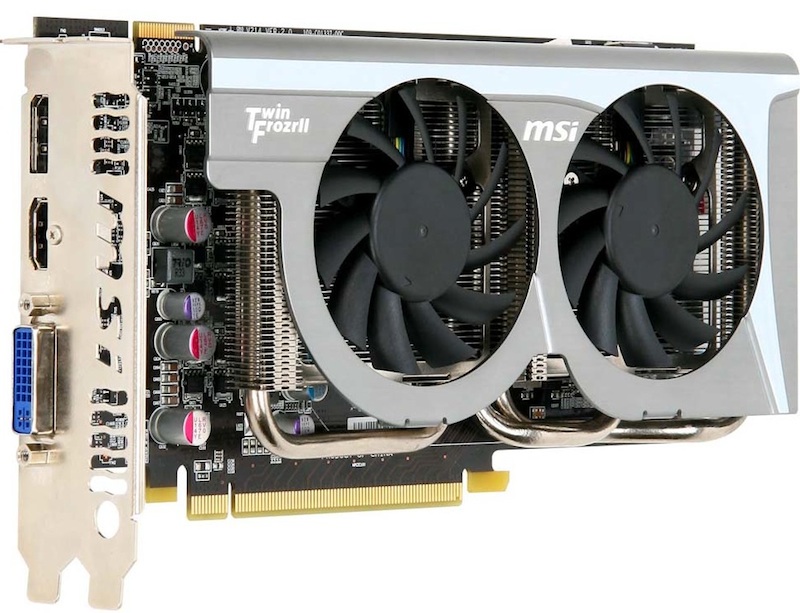

9. Graphics card upgrade : MSI r5770 Hawk 1 gig
I found this 2nd. hand PC card for about US$ 49 here in Japan where I live.
It booted up OOTB in 10.6.8 - no boot screens of course.
This card has not been flashed and won't be in the foreseeable future as I rarely need the Apple boot screens unless I come across another MSI r5770 Hawk to be used as a guinea pig. In any case Clover allows boot selection.
9.1 Shut down the Mac Pro, removed the X1900XT and replaced it with
the MSI r5770 Hawk connected using a DVI-VGA adapter to a
Samsung SMS23A350H LED monitor (The Mac Mini is connected
to the HDMI Samsung port.)
Booted . . .yes ! Happiness ! Mavericks + MSI r5770 Hawk.
There ares probably still quite a few Mac Pro 1,1 & 2,1 owners with ATI X1900XTs installed. I posted to show that you CAN install Mavericks using this still handy card that was great in it's day.
More to the point, there are still plenty of cheap MSI r5770 Hawk cards available on NewEgg & Amazon, this card is a huge upgrade from the X1900XT eg : I could not even run X-Plane Version 10 ( flight simulator ) on the X1900XT on 10.6.8 With the non-flashed MSI r5770 Hawk installed it runs very well in almost full on graphics settings.
The r5770 Hawk has two silent fans, used only one 6 pin PCI power connector cable and is . .faaast.

BTW, one issue that many 5770 and 5870 cards suffer from is non-functional DP, especially with Apple mdp.
Have you tested? This is good info, but important that people with DP or MDP displays know that a PC 5770 or 5870 may not work with their display.
Haven't got a MDP cable at the moment.
Didn't have time to check HDMI - HDMI but will check on the weekend & report back.
Worked very well with DVI - HDMI.
Have you ever worked on this card ? I'd be willing to help with testing, I follow your comments around the web. You know graphics cards.
MSI r5770 Hawk (impressivefor the price )Specs :
875MHz Core
1GB GDDR5 4800MHz Memory
Video Output Function
DisplayPort x 1
Dual-link DVI x 1
HDMI x 1
2 silent fans
1 x 6 pin power socket.
