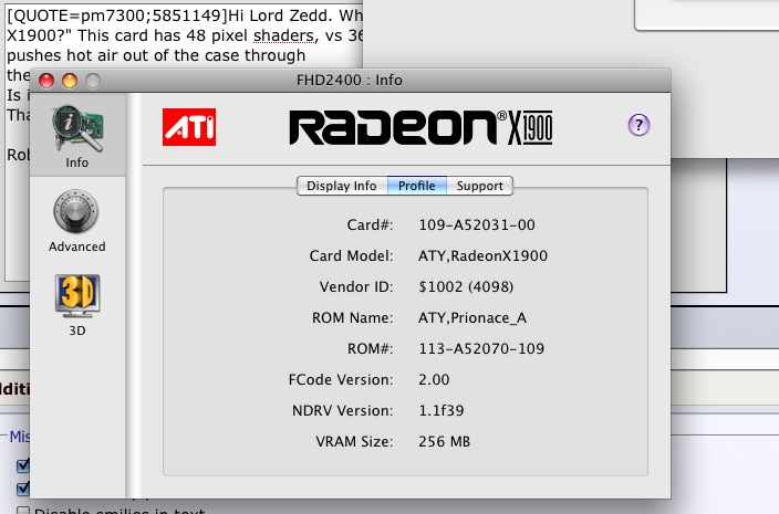

Hi guys. I bought for cheap an Ati X1950xt 256Mb Gddr3 (R580) PCIexpress, for PC. I've read someone made a hacked rom to work in a Mac G5 PCIe, to be flashed on a PC Win with PCIe slot.
Can you help me please to find that rom, if possible?😕

Hi Lord Zedd. What do you mean with "normal X1900?" This card has 48 pixel shaders, vs 36 in X1900 and the fan pushes hot air out of the case through
the Pci grille, for a better cooling. Can I see a picture of your card, please?
Is it a PC flashed?
Thank you for replying
Rob
More accurate
<<This card has 48 pixel shaders, vs 36 in X1900 and the fan pushes hot air out of the case through the Pci grille, for a better cooling. >>
I mean compared to the X1900 (GT) Mac G5 edition🙄
Games, HD videos, apps..... Compared to the stock Nvidia 6600 they are all seriously faster, if you think I payed only 77 Euros for this card it's a deal.

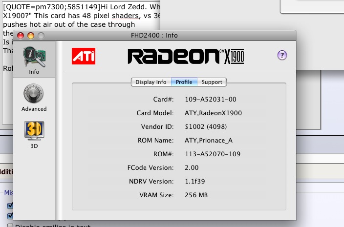

Ati X1950xt Mac Ppc
Ok guys, I've done several tests both Tiger and Leo. This card works perfectly.
The only issue is system profiler running Tiger, reports 128Mb Vram,
But Leopard sysprof shows 256.
The stock Nvidia 6600 I had before it really sucks.

Radeon X1950XT
It does work. Three x1950xt have already been flashed with that rom and they
work, both DVI ports and TV too.The only bug is the sytem sees the card as a
x1900. BTW on my Quad G5 now I have a Nvidia 7800GTX 512 megs, seriously
faster than Ati X1900GTO.
