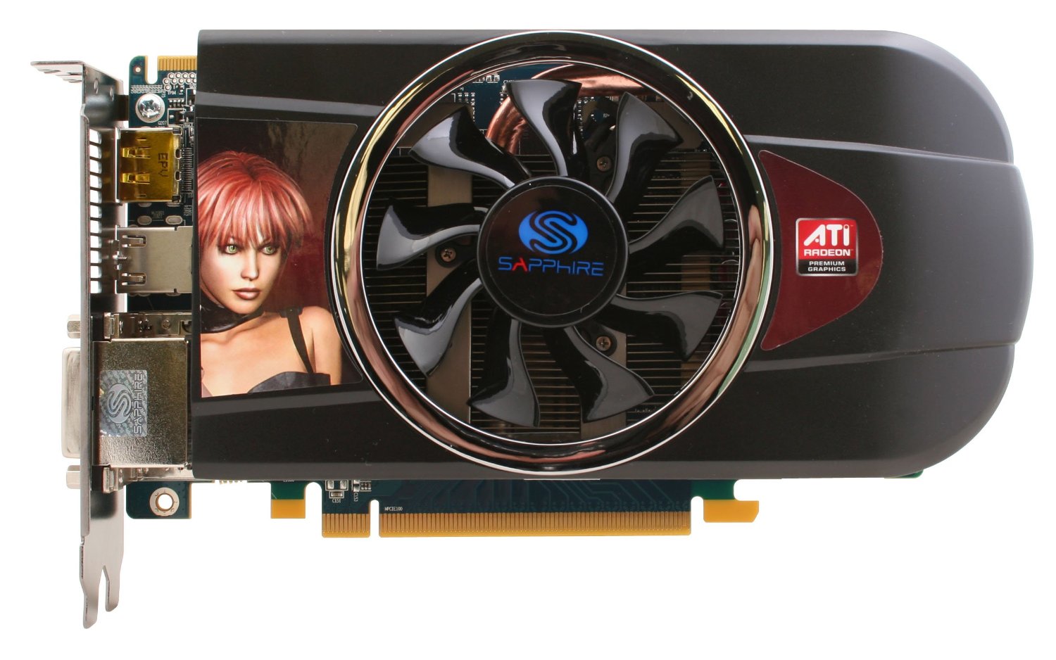

I have the ROM file and am using ati flash on a 5770. I get stuck with an error:
Old SSID: 2543
New SSID: 2990
SSID mismatched
Error 0FL01
I have unlocked the ROM, but cannot find any help with this particular error.

I think Florian means that you try to flash a ROM which actually not for that card (even though that's a 5770 ROM, it doesn't mean that the ROM fit your card).
The 7950 itself is bad-flash proof (dual ROM design). As long as you only flash one of the ROM, you don't need another card to practice.
Okay, looks like I need a different ROM file for the 5770. The one I have is a Sapphire card which looks exactly like this one below. Any idea where I can find the proper ROM file to flash this for my Mac?
Yes, that's the way to go. The stock 5770 ROM will most certainly brick your card.
