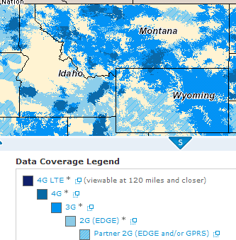

I'm in Montana.
Ah, makes sense. I was a bit confused when you said your state was "pretty much totally blanketed with AT&T HSPA+" and their coverage map seems to show only pockets of that in darker blue, although pretty good 3G otherwise, considering the terrain. Of course, their map could be out of date.
And yes, there are places Verizon's the best choice and places AT&T's the best choice. Neither one is universally great and neither one universally sucks.
Yep.
The lighter blue is still HSPA+, it's just not IP backhaul, so the ping times aren't as good.
Thank you. I have learned something new because of your posts:
AT&T defines non-LTE 4G as "HSPA+ 14.4 or more, with enhanced backhaul".
So, as you said, you can have HSPA+ but it's not mapped as 4G without the backhaul in place.
Question: what does the iPhone status bar display in that case?
The iPhone ALWAYS displays 4G when on AT&T's UMTS network. The phone has no way to know what the backhaul is. I get *GOOD SPEEDS* on AT&T's network. Ping sucks, but what's new? I'm in Montana. Tonight there are some network problems city-wide, but AT&T's handling them much better than Cablevision/Optimum Online/former Bresnan:
