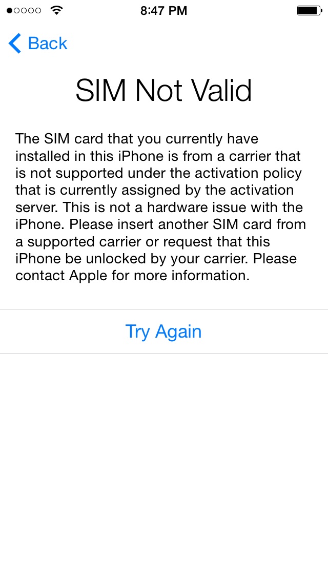

So I submitted an unlock to att and got approved for an iP5.
I did a restore and still not able to Unlock. I never got the message on itunes saying its unlocked. I've tried everything even submitting unlock request again.
On the iPhone it says "SIM Not Vaild"
I was a Previous att customer (4Years ago). I currently have T-Mobile
Any Help???
Thanks.
Here's a screenshot.

Did you already port the number over to another carrier? I don't know about this stuff but if you are on T-Mobile then you don't have a valid AT&T SIM in the phone (which sounds like it's required)?
I assume you followed the process for AT&T previous customers and not the process for current customers?
Same exact thing happened to me. Took over a month to correct and I had to spend a ton of time on the phone with both apple and att because neither had ever heard of such an issue. Apple sent me replacements which gave the same issue. It was something with apples 'activation chain'. Eventually they sent me a complete replacement to fix it and that worked.

I just called AT&T they said that they were gonna transfer the unlock to a specialist. Hopefully it gets unlocked.
This happened to me as well when i tried to unlock my iPhone 4. What you need to do is resubmit the unlock request and it should work.

All you need is to stick another carriers sim in and connect to wifi to activate it.
You don't need a full restore even though they suggest one.
