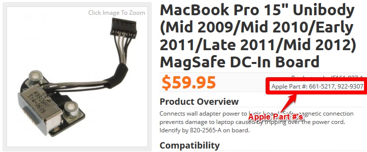

1. Go to ifixit.com and lookup the parts for the model of MBP that you have.
2. Find the part numbers for the logic board and DC-in board (see attached sample screenshot for DC-in part. NOTE: Do NOT get this part unless you know for a fact that I'm showing the correct part # for you. You didn't specify the model of your MBP, so I can't guarantee that this is the right part.)
3. Go to eBay and search for that part number along with the string "Macbook Pro", because iFixit charges a small fortune for their parts.
4. When you get the part(s), go back to iFixit and follow their instructions to replace the part(s).
4. When you get the part, go back to iFixit and follow their instructions to replace the part(s).
