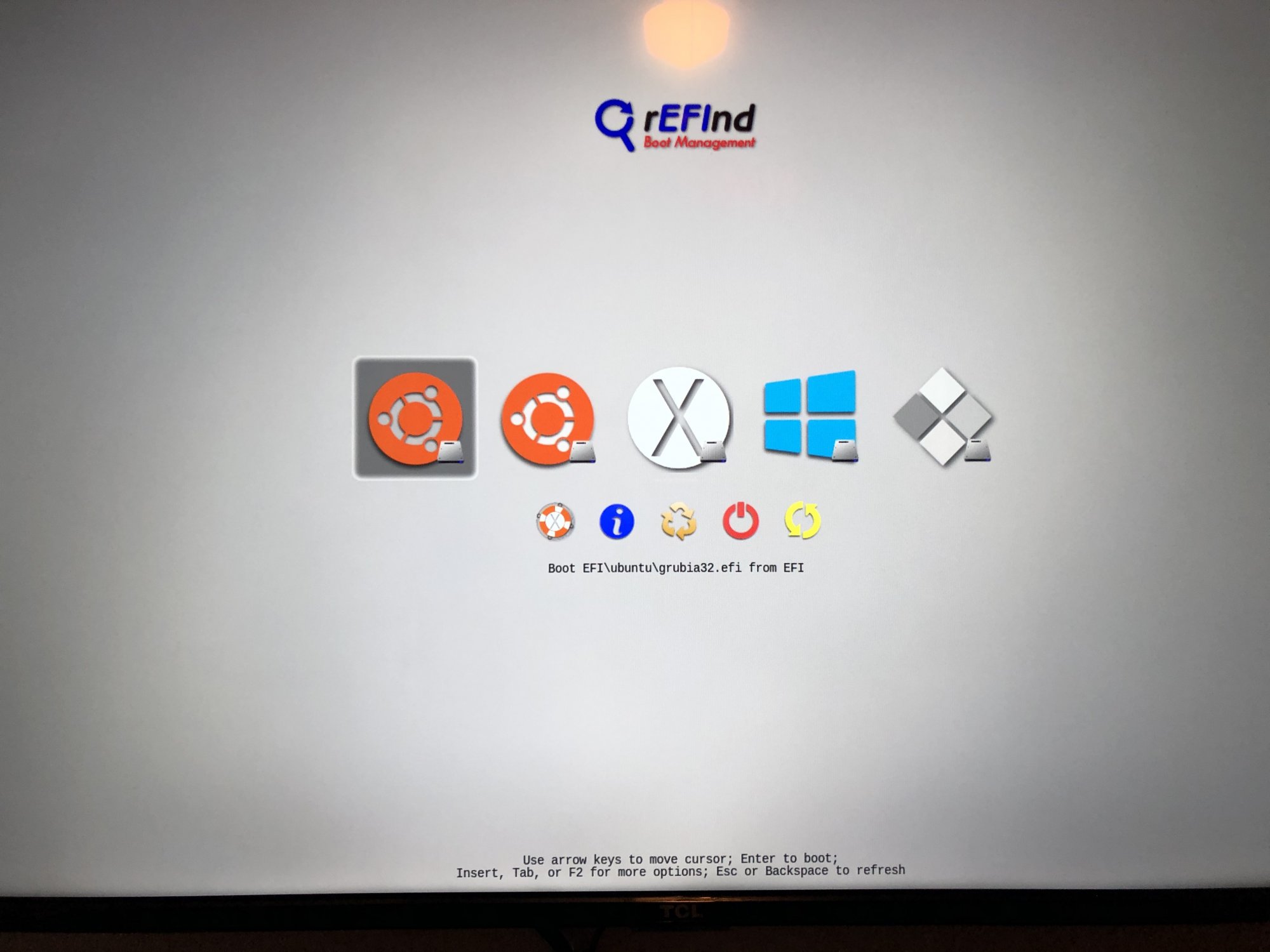

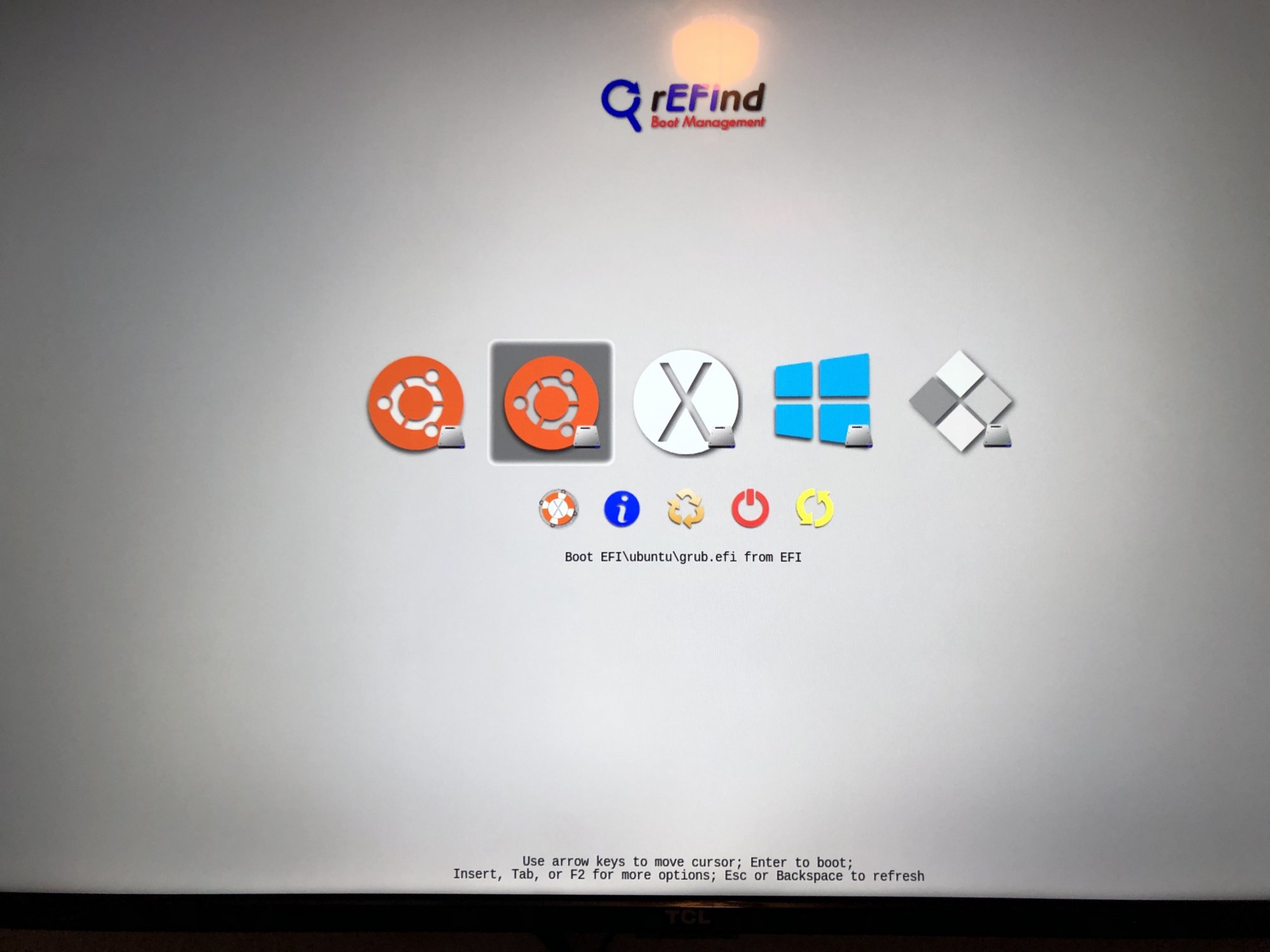

Ok, I'm getting closer to the setup I want. I've managed to get all three systems successfully installed, but now I have two entries for elementary OS on my rEFInd boot screen...
Both seem to take me to the GRUB boot menu, where I can hit enter again on "elementary OS" to boot into eOS, but the second entry seems to get rid of the rEFInd boot menu and takes me straight into eOS upon reboot.

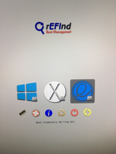

I have a triple-boot setup with rEFInd booting macOS Mojave, Windows 10, and elementaryOS.
I even have elementaryOS installed on a LUKS encrypted partition. To do that, I had to make rEFInd boot Linux using GRUB so the correct kernel arguments are passed. If you aren't using encryption, you can get away with booting into Linux using the kernel EFI shim. The downsides are that you have to let rEFInd auto detect it (so it thinks its an Ubuntu installation, and you get the Ubuntu icon), or if you manually configure it in rEFInd then you need to fix it when the kernels are updated. After a lot of trial and error, it was a lot easier for me just to boot into Linux using GRUB.
To get the extra icons to disappear, I had to change a few settings to rEFInd:
Code:
dont_scan_tools EFI:/EFI/ubuntu/mmx64.efi
dont_scan_volumes Windows, <UUID of partition containing Linux /boot>
dont_scan_dirs +,EFI:/EFI/Boot,EFI:/EFI/ubuntu
Then I manually added elementaryOS as an option so it shows the correct description and icon:
Code:
menuentry "Elementary OS" {
    icon /EFI/refind/icons/os_elementary.png
    loader /EFI/ubuntu/grubx64.efi
I do find, as you mentioned, that other operating systems (well, even macOS, for that matter) occasionally change the boot settings so I no longer get the rEFInd menu. I just have a sticky note with the commands to bless rEFInd again, which I execute on macOS after booting into macOS using the option key (this could probably be put into a LaunchAgent or something similar to make it automatically execute on each bootup):
