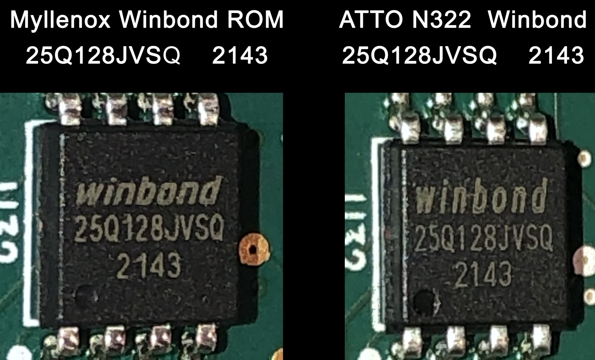

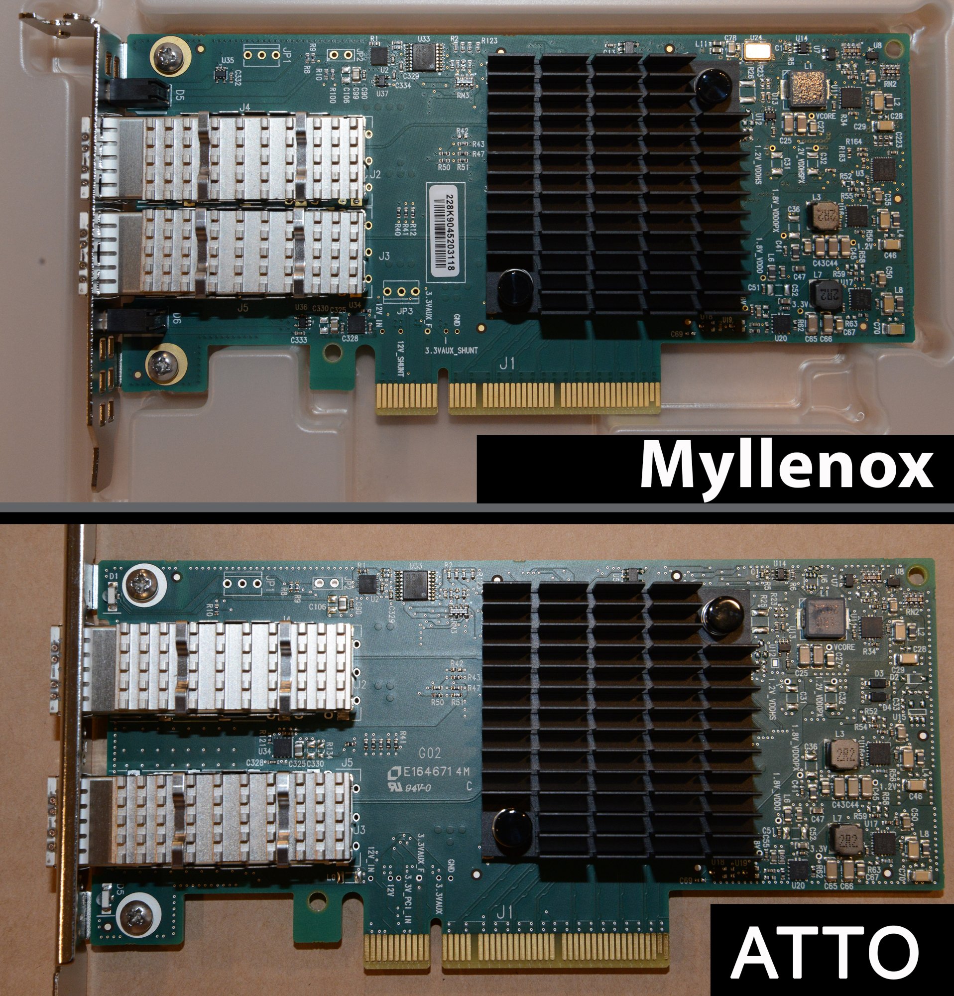

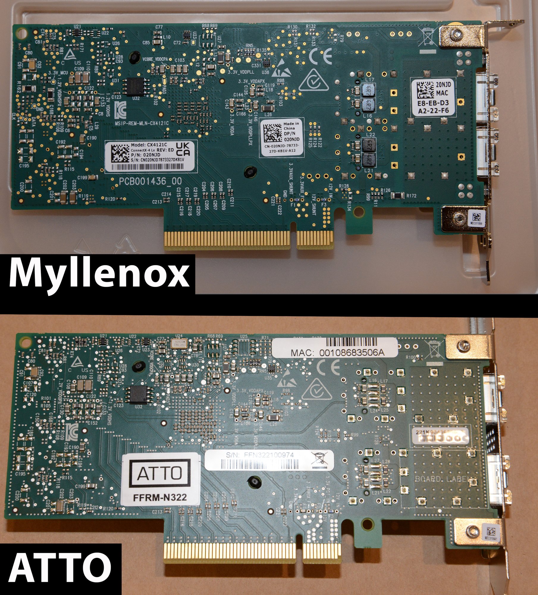

So, I wanted to test something with these two cards and looked for very similar models (as people have said that the ATTO FF cards are based on the Myllenox cards). Unfortunately listings had blurry pictures and the pictures I found on Google Images were slightly different than the actual layout of the card received.
Still, is there any reason [not] to:
1. Back up the Myllenox ROM
2. Copy the ATTO ROM
3. Write ATTO ROM to Myllenox
And test if it'll be recognized by a MacBook Pro (via PCIe to TB, obviously)..?
And if anything has an issue, just revert the Myllenox ROM back to stock..?
Myllenox Model: ConnectX-4 LX CX4121C // MCX4121A-ACAT, Dual Port, SFP28
ATTO NIC Model: N322, Dual Port, SFP28
Actual pictures attached including the identical ROMs.
For convenience, both ROMs are: 25Q128JVSQ 2143
Thanks
