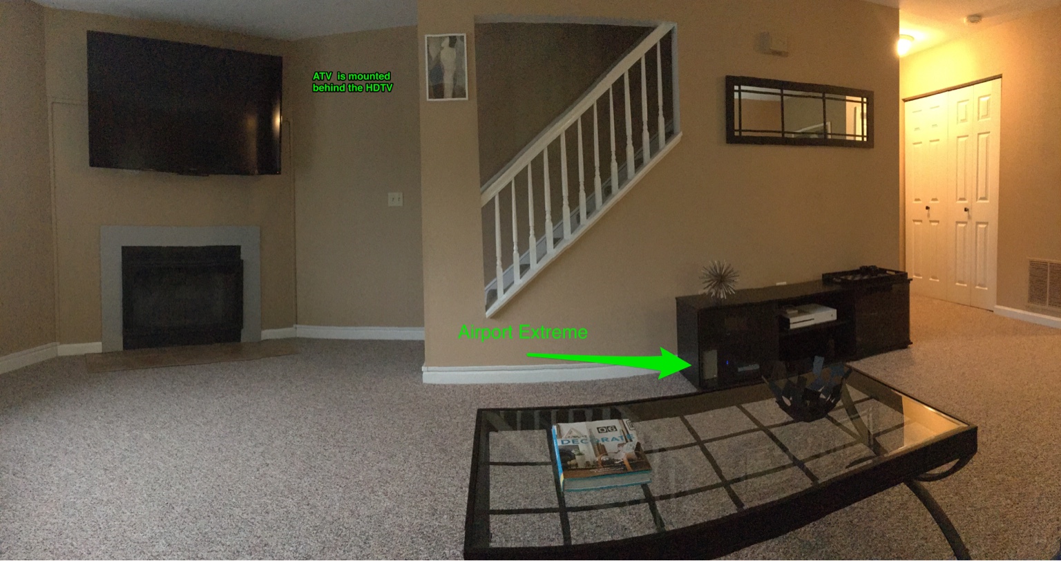

I am dealing with the lip-sync issue myself on my brand new ATV 4.
I using a Airport Extreme (latest generation) on the 5GHz signal.
My router is about 12 feet away from my ATV. I've restarted the ATV, Airport, and my cable modem to no avail.
