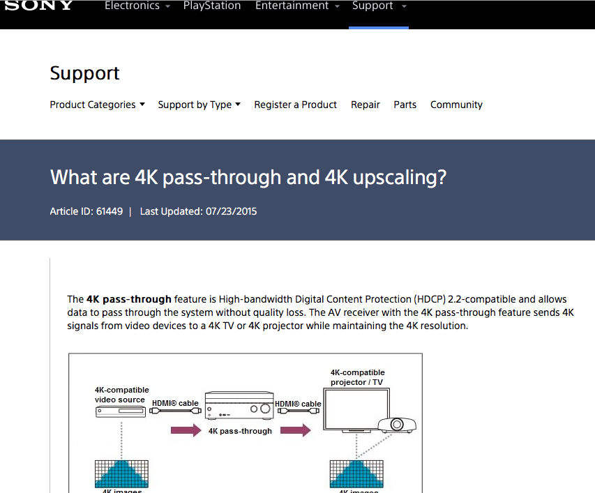

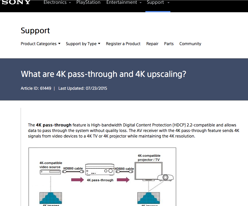

"The 4K pass-through feature is High-bandwidth Digital Content Protection (HDCP) 2.2-compatible and allows data to pass through the system without quality loss."

source: https://us.en.kb.sony.com/app/answers/detail/a_id/61449/related/1
That's generic and doesn't apply to this receiver.
Go down to questions here and you'll see it doesn't support HDCP 2.2
https://www.amazon.com/Sony-STR-DN1050-Channel-Receiver-Bluetooth/dp/B00JC31SEI
Here it also notes it doesn't support HDCP 2.2
https://www.soundandvision.com/content/sony-str-dn1050-av-receiver
And here's a very long thread on this receiver, post 1298 says it doesn't support HDCP 2.2 as well as many other posts.
http://www.avsforum.com/forum/90-re...7-official-sony-str-dn850-1050-thread-44.html
