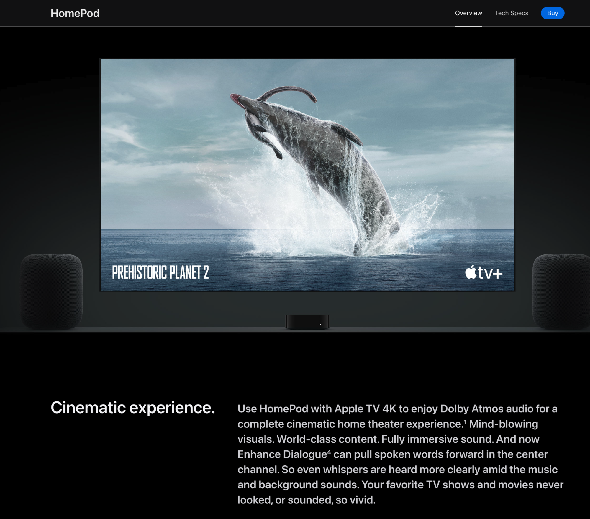

I do have a proper multi-channel HT setup in another room, I understand the value of dedicated receivers, pre-amps, amps, passive speakers etc... but I also use the ATV and HomePod for watching movies, which arguably is exactly what Apple intended (according to docs, promo materials and thousands of people using them).
I know you can throw money at the problem and add more devices into the mix, but I'm trying to solve the underlying problem here.

And no, Apple intended for HPs to be used for MUSIC. Fans kept pressing to use them with AppleTV too and Apple opted to take that money. They seem to be making ZERO effort to build out the rest of home theater audio, even with the seemingly obvious opportunity to use 2 HP minis for surrounds. No HP sub rumors. No HP center or soundbar rumors. Etc. They seem to begin & end at only stereo playback with no aspirations to make them “the rest.” Not even one rumor.
And don’t be fooled by the “Atmos” tag. Real Atmos requires physical speakers around the main seating position & overhead. Your ears would easily notice the difference vs. any faux Atmos spin. If real Atmos could be had by 1 or 2 speakers down front, every professional cinema would jump on that super cheap option vs. paying much more to deliver the real thing. Next time you go to the movies, go early enough to see the cinema space lit up and look around. You’ll see speakers all around. None have ANY 2 speakers down front and nothing else.
But again, I hope you find apps or Apple evolves tvOS to resolve your problem. I suspect they have little interest. Else, it’s likely HP minis would already be packaged with 2 HPs as a very basic 4.0 system. Then add center and a sub to make that a basic 5.1 system.
Well 🤷‍♂️
But I do get your point ...
On the flip side, there is Wireless Audio Sync (for hdmi-attached devices that might introduce latency), so they did somewhat think of the general use case and problem space.
