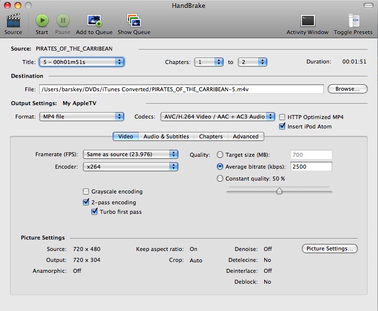

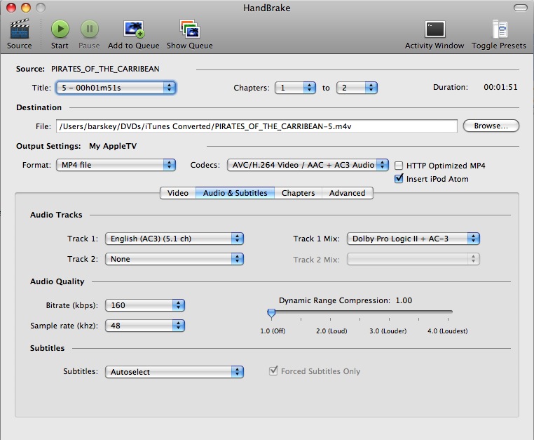

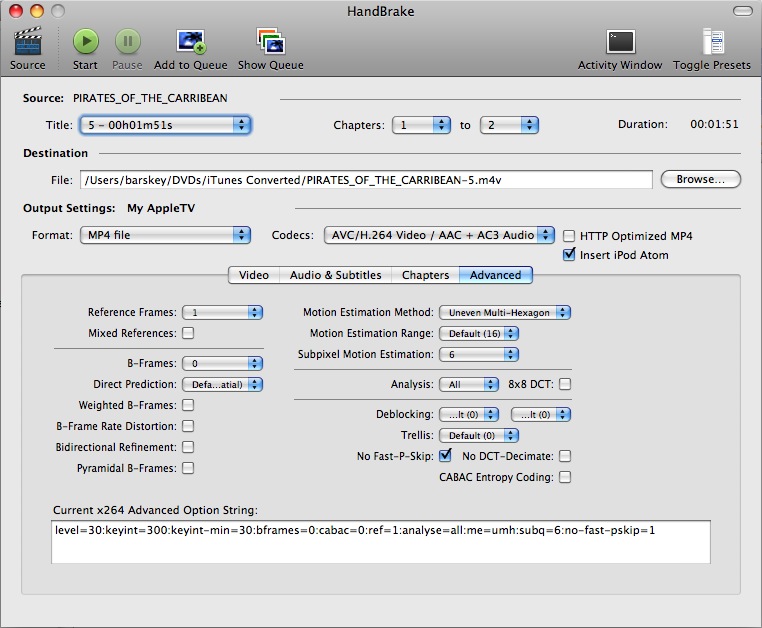

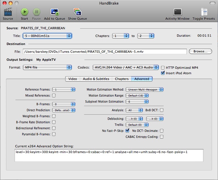

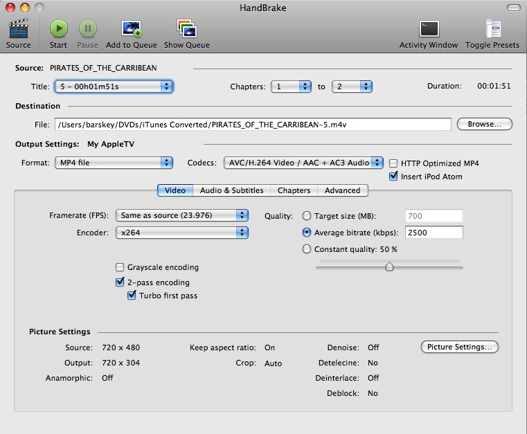

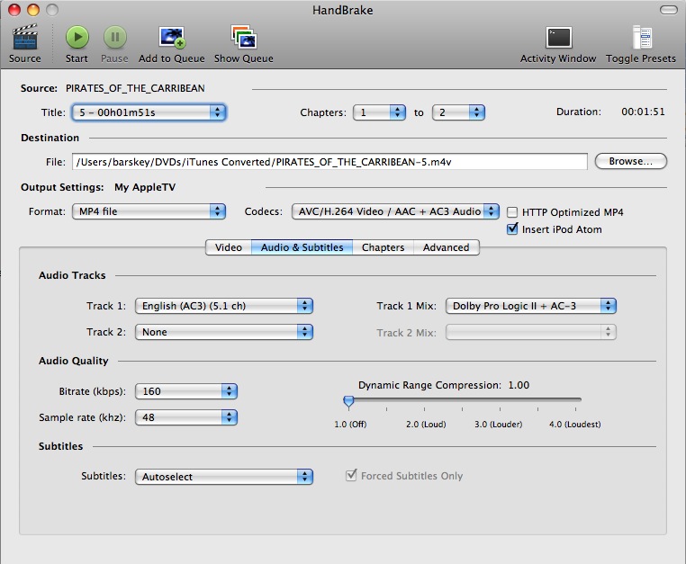

Here is my sweet spot (shown in attached images). I give up a few pixels in resolution to be able to move movies to my iPhone. They are much larger than need be on the iPhone, but at about 2GB/90 minute movie, it isn't too bad.
Note: I didn't show the Chapters tab, because I don't change anything here.
To get to these settings, I start with the iPod High Res preset. Then I do the following:
  1. Switch the audio codec to both AAC and AC3
  2. Turn on 2-pass and Turbo First Pass encoding
  3. Up the bitrate to 2500
  4. Change Anamorphoc to strict from the Picture Settings button.
  5. Up the audio bitrate to 160
  6. Turn on Autoselect subtitles and check Forced only
  7. Remove the "vbv-maxrate=1500:vbv-bufsize=2000:" from the Advanced section.
Then of course I made my own preset from this, so I don't have to re-do it every time. I find the quality matches that of the AppleTV preset, and you get the added bonuses of the addittional AC3 audio, and you can transfer it to your iPhone.

Macfan, I'm giving your settings a test on Batman Begins. I may scream at the bitrate once I see how much space it takes up (it's why I was at 960 to begin with), but I do have a couple of big hard drives with some decent space. I do think I'll kick that down a lot for TV shows, especially comedies.

The new iPods and iPhone can handle 720x480 with anamorphic encodes. I do like he says, but I use a bitrate of 2000. I don't see a difference between 2000 and 2500 other than file size.

The :apple:TV will play Dolby Surround audio, and pass through AC3. The newer version of Handbrake (0.9.2) will allow you to encode a movie with both tracks. This way the mac and iPhone will use the Surround track, and the :apple:TV can pass through the AC3 track to your stereo.
If you only encoded with the AC3 track, then it will only be available to be passed through, and hence none of the afore mentioned devices will have audio.
When you say the sound doesn't work, how did you encode it? Did you have your stereo equipment on and connected via the optical audio out? Does it show that it is getting audio from the :apple:TV?
Also, there may be a menu setting in the :apple:TV to determine what to do with digital audio out. Check there...
Woot. I think I have it all fixed. I got Batman Begins to play on both computers, my iPhone, and ATV. The ATV audio problem was from changing the video input. Can't have something with optical audio cable on Video 2, gotta be on Video 3. Sounds really good and looks better than DVD even at the 1500 bitrate setting, which saves SO MUCH ROOM. Thanks for the help!!!
