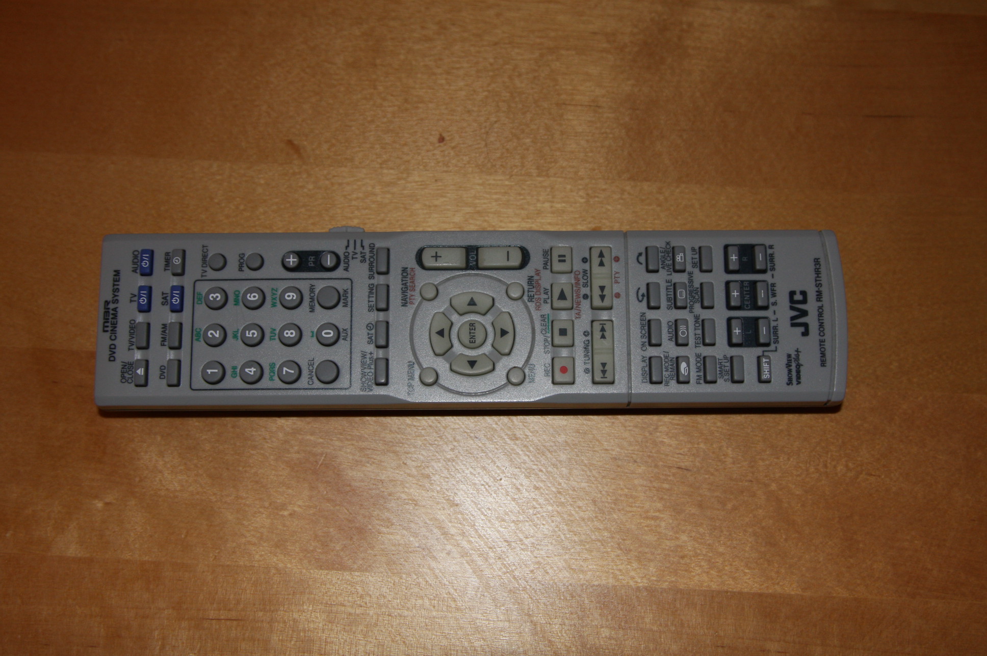

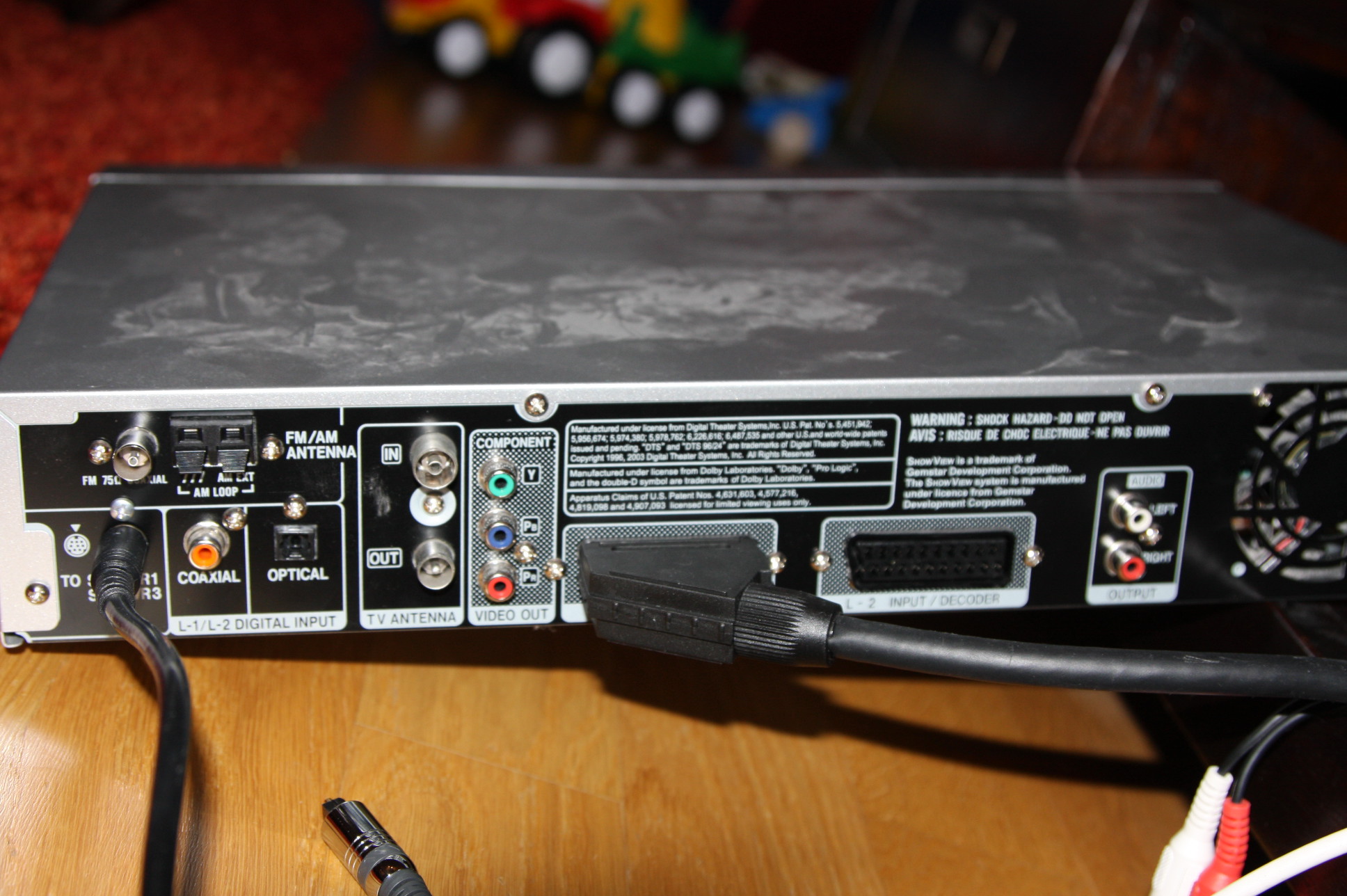

Here you should see photos of the connections on back of my JVC home theatre and my remote. Yes, I have connected via optical from my ATV to my home cinema. Then there is HDMI connection from ATV to TV of course. TV and home cinema are connected with Scart-cable to port L-1 (or L-2) of the home cinema. I would be very glad if you can make up some sense out of this to me😉

Hm - not sure how you select the L-2 digital input!
There isn't an obvious button to press on the remote. I'd check the manual - nothing stands out on the remote that would select L-2 digital as the audio input, and I highly doubt you'd have to go to the DVD input on your tele and view the options there.
I had a little time on my hands, so I did a search and downloaded the manual for your JVC, which is available here:
http://uk.jvc-service.net/public/document.cfm?prog=InstrBook.cfm&Model=TH-R1
On page 68, there is a section called L-1 And L-2 Audio Input Setting. It looks to me like you have to tell the unit how you're assigning the inputs. It looks like you can set up either L-1 or L-2 to use the optical input.

You do have to view the home cinema input on the TV to adjust the options. Page 68 and 69 describe it quite clearly though.
Voila! That was it, it works now perfectly. It was quite well hidden behind this settings menu, though I need to admit that I am not technically too advanced😉
