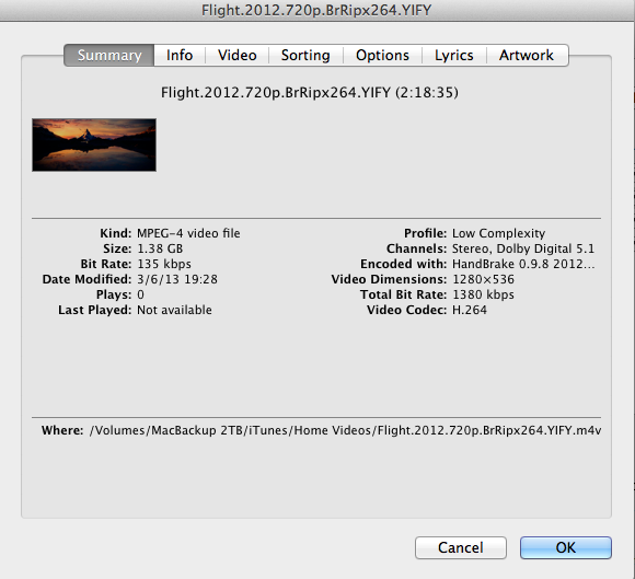

in iTunes, select the file, hit cmd-i, then on the summary tab either post a screenshot or tell us what the following entries are
  • kind
  • bit rate
  • profile
  • channels
  • video dimensions
  • total bit rate
  • video codec

Thanks for your help waw74
iTunes is pointing to the correct directory. When I launch / play the movie from iTunes, it plays almost right away (~5 seconds)
Attached is the screen shot you mentioned.
