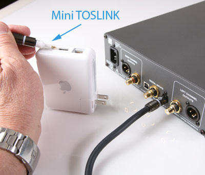

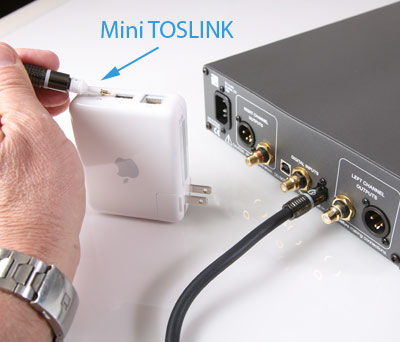

The Airport Express has a 1/8" stereo jack on it that also serves as an optical out. I use it with a standard 1/8" stereo plug, but when you take the plug out you can see the red light emission for the optical connection.
Thanks. A little Googling last night and I found this on the PS Audio website (this is not an endorsement). Their newsletter talks about various Apple products as mechanisms to export digital content to an audio system. http://psaudio.com/newsletters/3-08.asp
